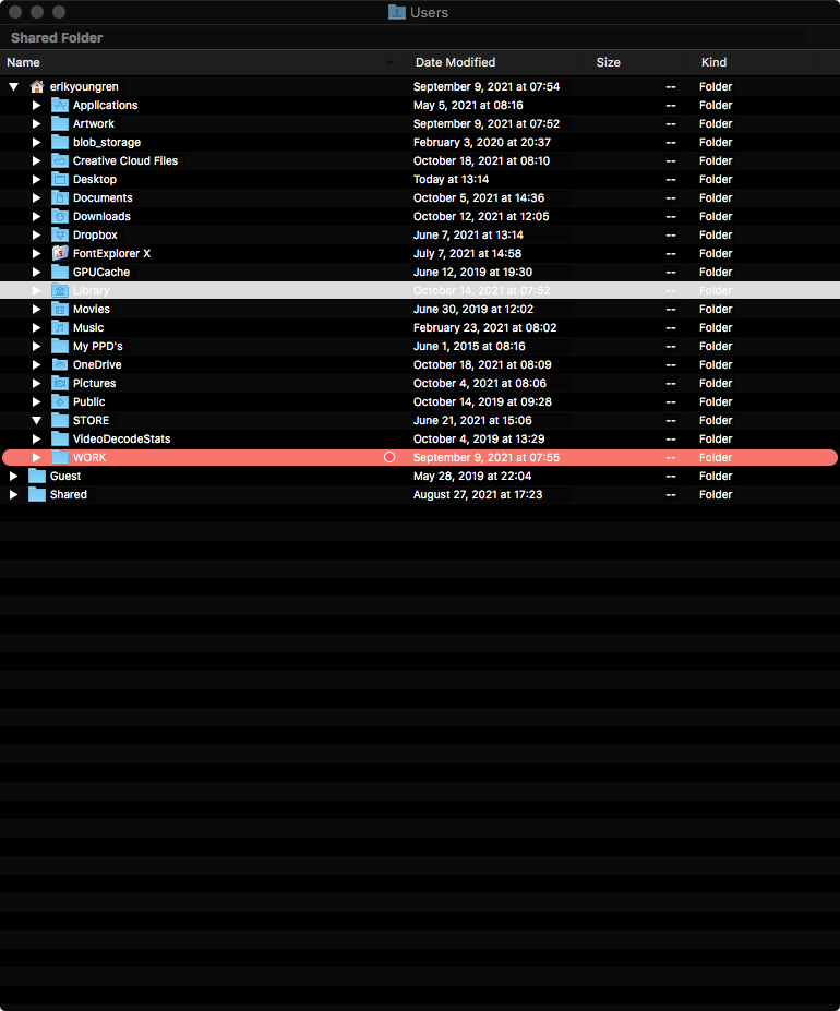

Your home folder belongs in the Users folder, which belongs at the root of your hard drive. That's been the way Apple set it up since OS X. Inside your Users folder is also a Library folder.

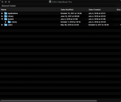

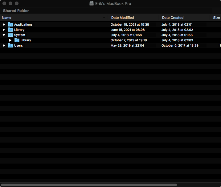

Here is how mine looks on my work Mac.

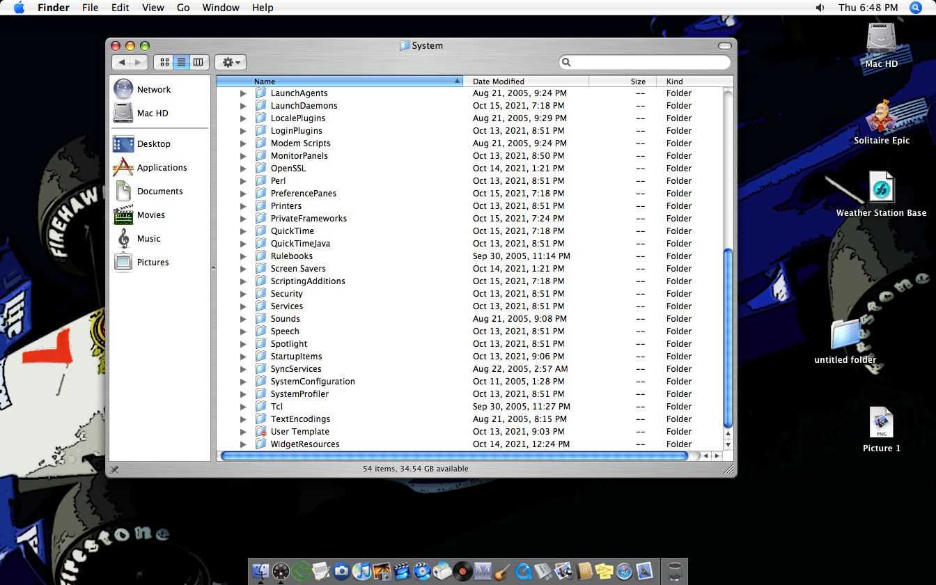

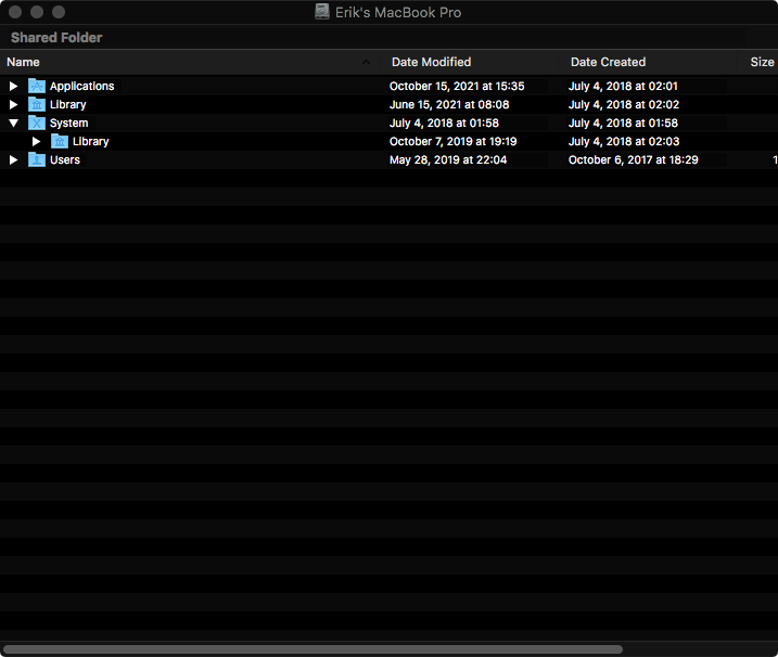

Below is a basic set up (also my work Mac). You can see that the only folder inside the System folder is the Library folder. There is no Users folder in there.
Somehow, your install is maintaining a link to /System/Users/MyUserName. Yes, the Mac is working 'normally' - but that install is not the way things are normally set up.

Here's a couple of screen shots of my System folder. Everything is in the Library:

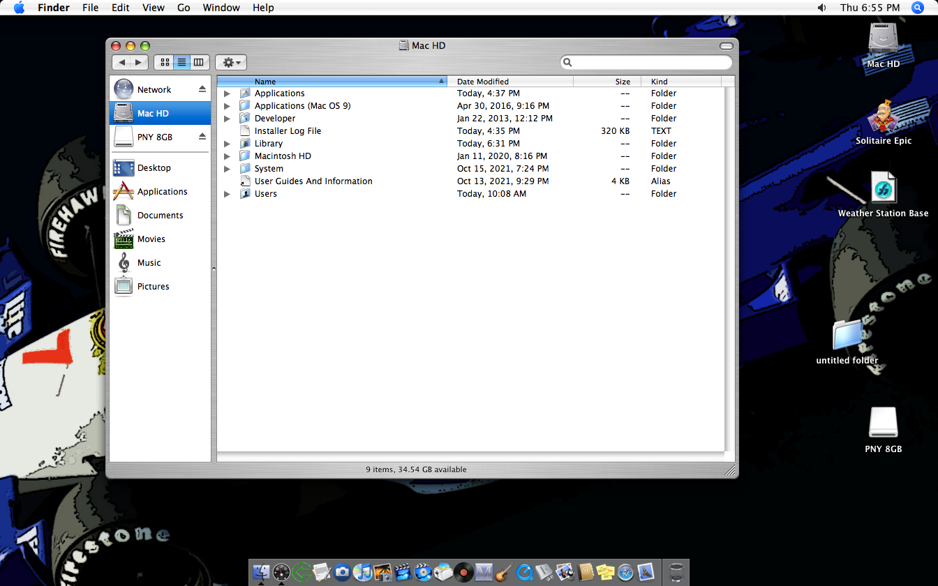

And here's a shot of my Mac HD window. Should there be a "Macintosh HD" file in it?

I hope this helps. I didn't see any "Applications" folder.

That's not normally there. What’s in that folder?
Everything: apps, documents, photos, etc. I no longer have any idea what is happening, or why. A fresh start is looking better all the time.
So it looks like the restore put everything in that folder, named after the drive which was backed up (“Macintosh HD”).
I still don’t get how your Users folder also ended up in your System folder though.

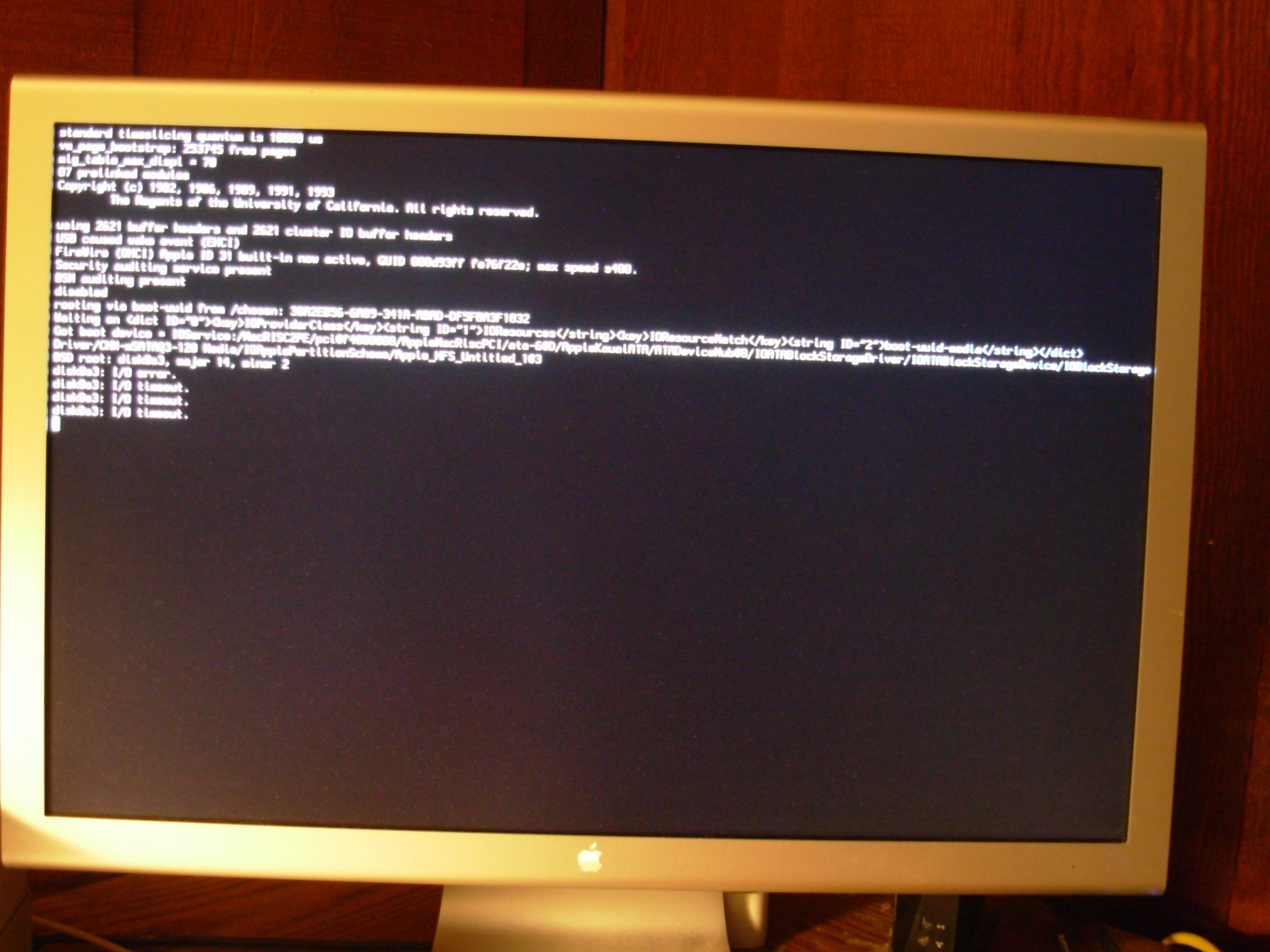

Well, it's been 8 days, and I'm back with another issue. The Mini has BIG problems. It won't boot, it gets as far as the white screen w/gray apple & spinner, and stays there. And, it won't boot from a OS X start-up disk. This is not good. Do you think this is a "green board" problem? Any ideas at all? I'm clueless.
Try booting verbosely by holding Command-V after turning on. Can you post a photo of the text that’s on the screen when it stalls?
I/O errors and timeouts indicate a problem with the drive, i.e. either the SSD itself or the mSATA-to-IDE adapter.
Wonderful. Fortunately, I do have another adaptor AND another SSD to play around with. Thank you.
