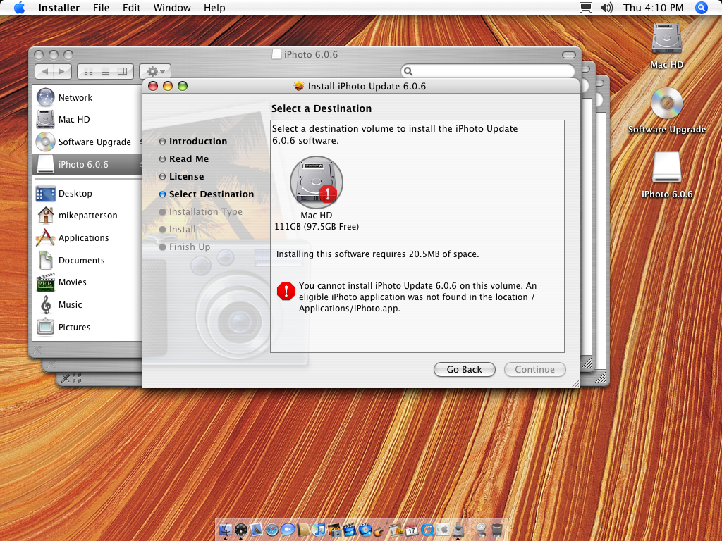

I'm not sure about having it "all figured out". For some reason, all my I Life software (I Photo, Garageband, etc.) can't be upgraded because the software is in the wrong location in my Applications folder. I'm not sure how this happened or how to fix it. My first instinct is to erase it all, and re-install it. Any ideas?

Here's a screenshot of the error message:
I hope this helps.
The iPhoto 6.0.6 update requires iPhoto 6.0.5 to be present at /Applications/iPhoto.app. Is your iPhoto version 6.0.5? If it isn't...
The iPhoto 6.0.5 update requires iPhoto 6.0.4.
The iPhoto 6.0.4 update doesn't say which version of iPhoto 6.0 is required, so I'd start with this one.
You could also just hook up the machine to the Internet and let Software Update do all the work. 🙂
My iPhoto is 6.0.4. I missed the 6.0.5 update. Got that straightened out.
