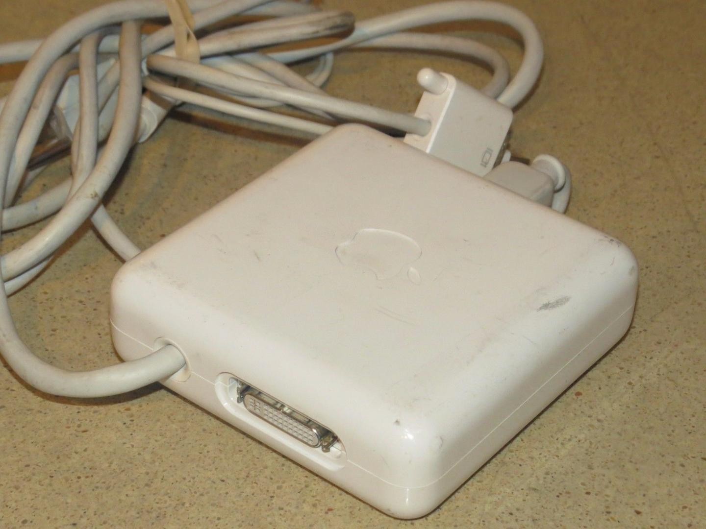

If you want to use the acrylic Cinema (and Studio) displays with a DVI-graphics card you are going to need the A1006 DVI/ADC converter.
Generally these go for about $30 or so on eBay. A few years ago you couldn't find one for less than $100-150.
If you want to use the acrylic Cinema (and Studio) displays with a DVI-monitor you are going to need the A1006 DVI/ADC converter...
Blimey just had a look on eBay in the UK and they're not cheap are they - someone's selling one 'for parts' for GBP50 😱
