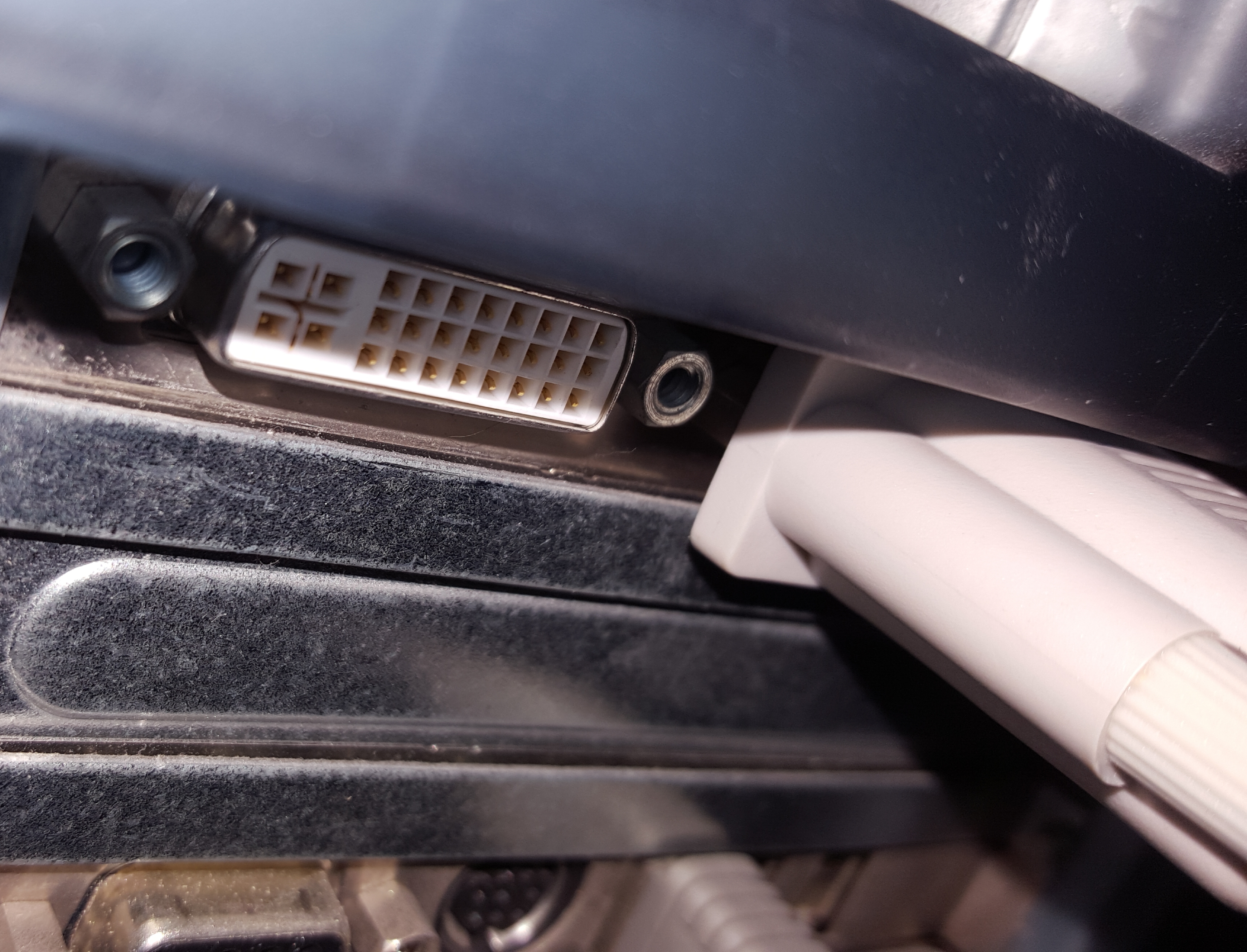

Looking at the back of my Radeon 8500 (photo below) and comparing it with images of dual link DVI-I, am I right in thinking this does support dual link ?

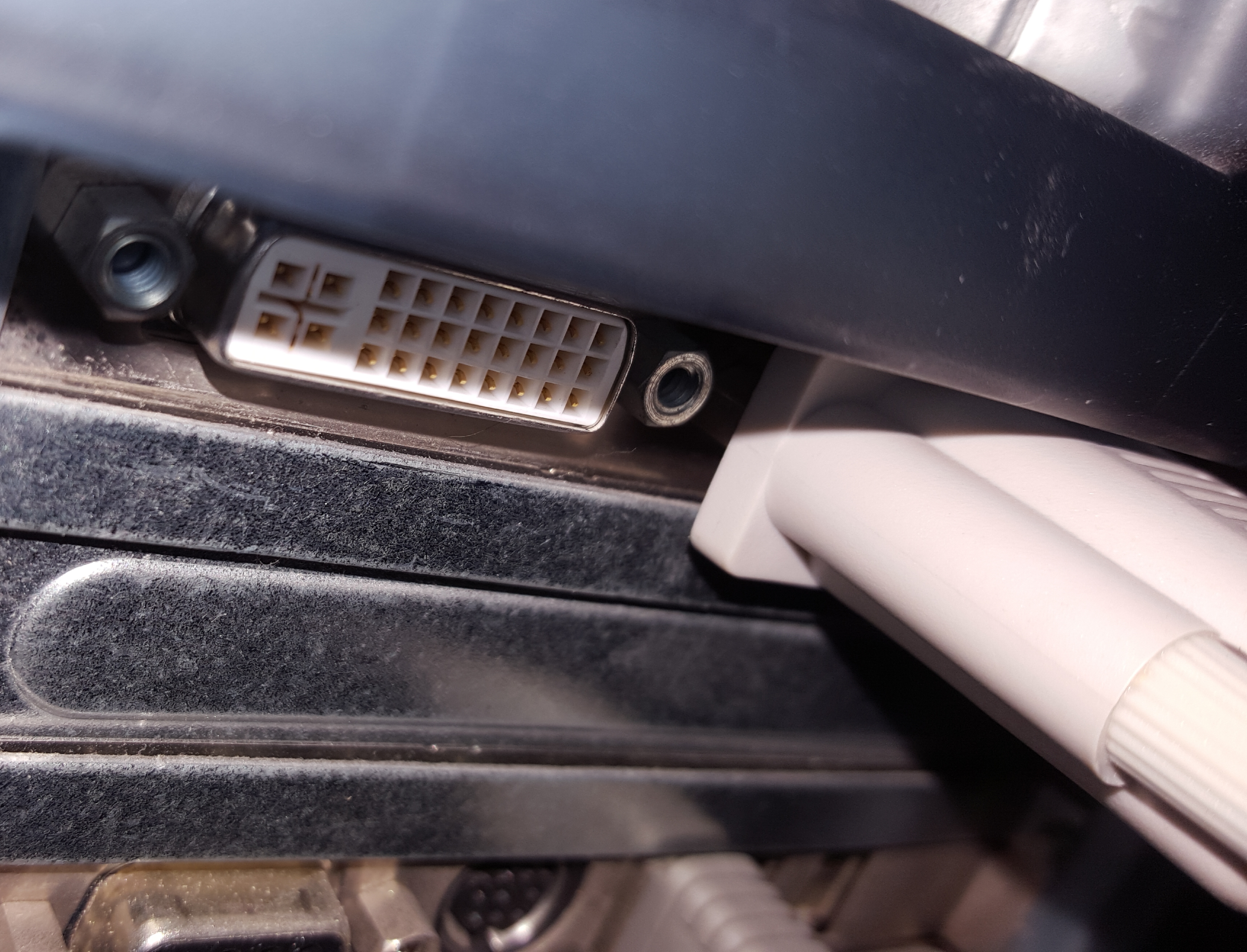

If you scroll down on that videocardz it says max resolution 1600x1200. I think the top part of the page where it says dual link is incorrect. 30 inch is 2560x1600. If it is not plugged into a dual-link port it will run at 1280x800.

The 8500 does not support dual-link. Dual-link only appeared with the 9600 PC&Mac Edition or the 9650 in G5s as far as ATI cards are concerned.
Driving a 30in ACD via single-link only gives you a quarter of 2560×1600, in other words, 1280×800. Not worth it at all.
