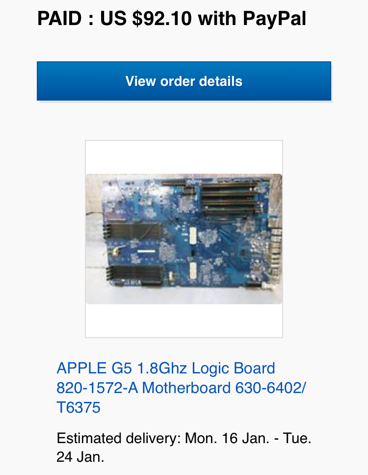

All signs point to a dying logic board. It might be time to look for a replacement Board or possibly a replacement Mac.
Here’s a shot of the part I ordered for my 1st gen ‘03 Dual 1.8Ghz G5 in Dec 2016.
The majority of the cost was shipping to Australia, I can’t recall the split exactly, but I think It was about $40 for the board alone. The good thing is it was an exact match of the model number on the failed board, so I was confident it would be compatible.
It wasn’t the most economic (logical?) purchase. I just wanted it working again. Everything clicked back into place and it has been working flawlessly since.
Anyway, I hope that helps you decide which direction to go.
