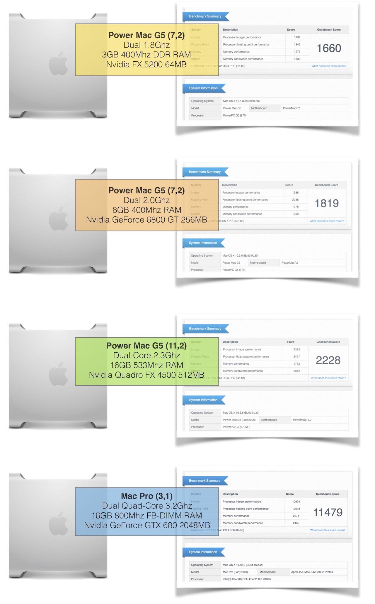

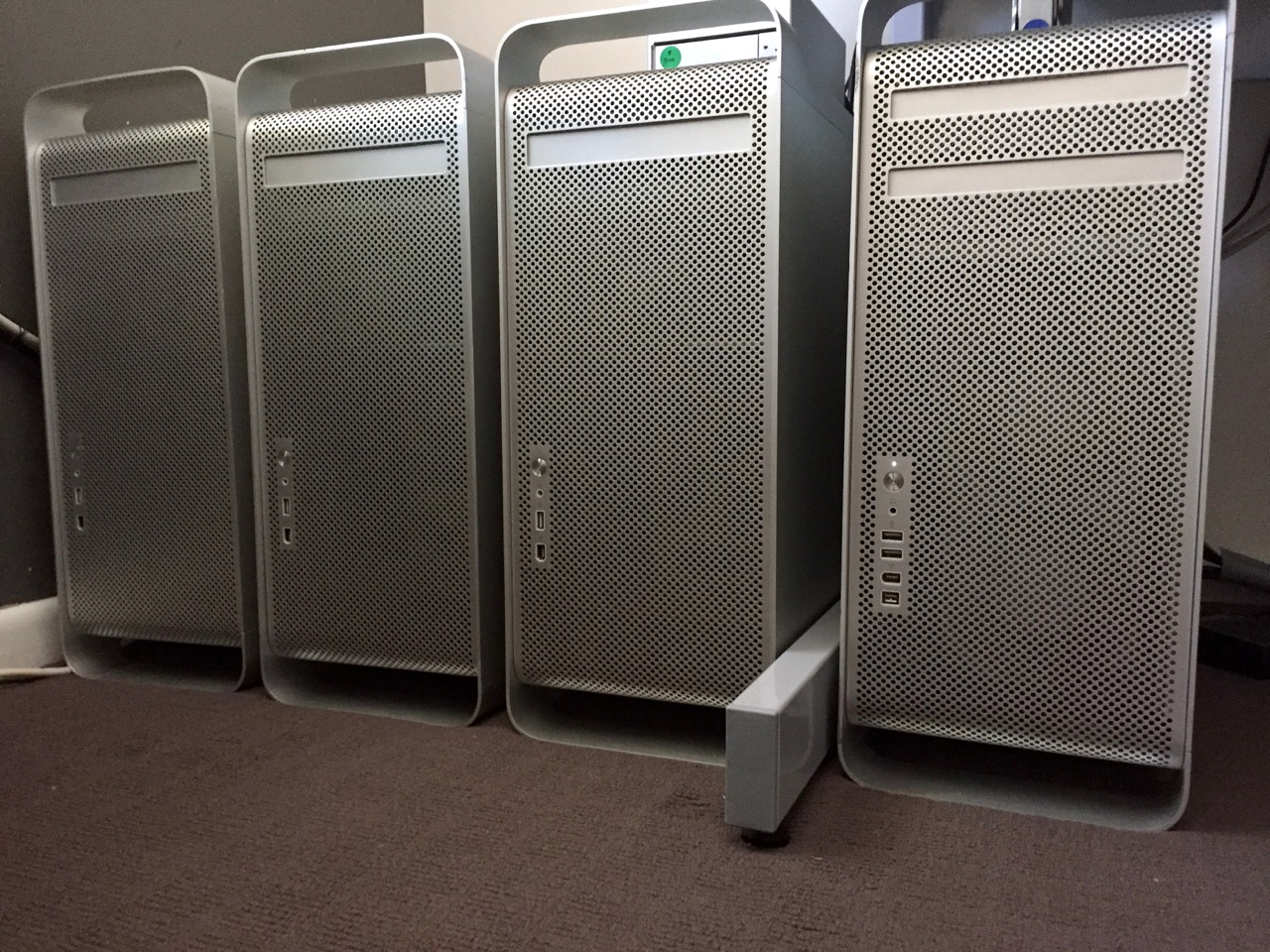

Left to right:
1. Power Mac G5 (7,2) Dual 1.8Ghz, 3GB RAM, Nvidia FX 5200 64MB
2. Power Mac G5 (7,2) Dual 2.0Ghz, 8GB RAM, Nvidia GeForce 6800 GT 256MB
3. Power Mac G5 (11,2) Dual-Core 2.3Ghz, 16GB RAM, Nvidia Quadro FX 4500 512MB
4. Mac Pro (3,1), Dual Quad-Core 3.2Ghz, 16GB RAM, Nvidia GeForce GTX 680 2048MB

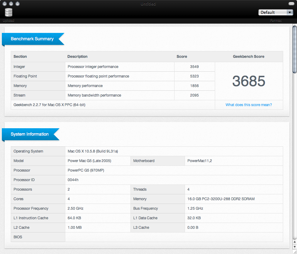

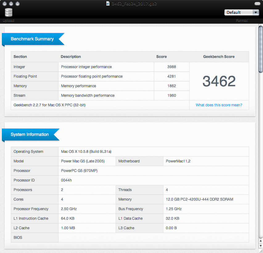

Just for fun, here are some benchmark results:

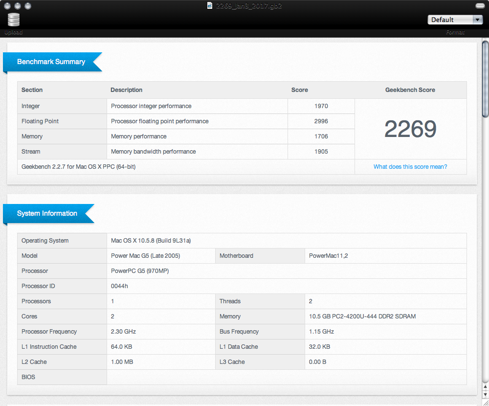

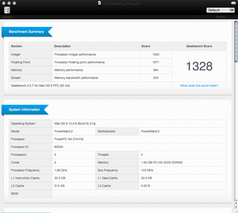

1.8Ghz Dual Sonnet PowerMac G4, 1.5GB ram: 1328 Geekbench
2.3Ghz Dual Core G5, 10.5GB ram: 2269 Geekbench
2.5Ghz Quad Core G5, 12GB ram: 3462 Geekbench
Same as above, but with 16GB ram: 3685 Geekbench

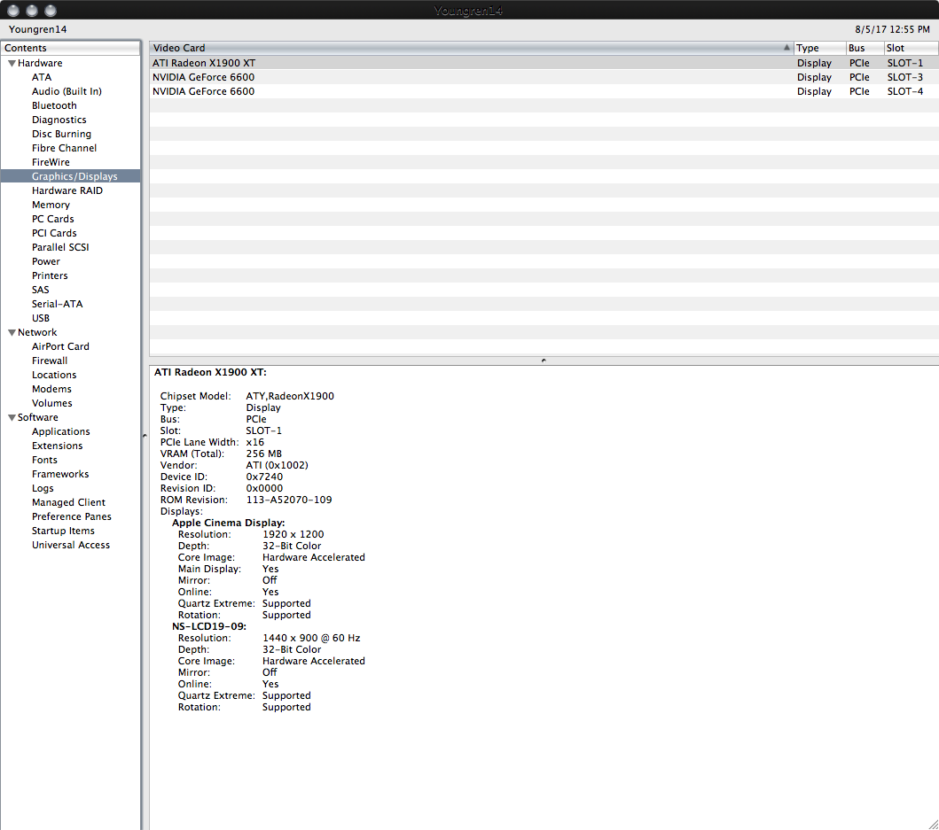

PowerMac G4 had one NVDIA 6800GT, one ATI Radeon 9200 and one ATI Radeon 7000.
At the time of testing, Dual Core G5 had one NVIDIA Quadro FX4500 and two NVIDIA GeForce 6600
Quad Core G5 had one ATI Radeon X1900 XT and two NVIDIA GeForce 6600.
Currently my DC has the NVIDIA FX4500 and two NVDIA GeForce 6600s and my Quad has the ATI Radeon X1900 XT and two NVIDIA GeForce 6600s.
Yes. I run six displays.
https://forums.macrumors.com/threads/quad….2032117/

That truly is an EPIC PowerPC setup. Kudos on putting older tech to (hard) work.
I rarely run my machines all at once, but during winter it has kept my studio nice and toasty warm. 🙂
Reactions: eyoungren
I guess they ultimately balance out, but your first Quad appears to be faster at Integers and the second is MUCH faster at FPU. I wonder if it has anything to do with RAM or if it's just a quirk of the benchmark tool?
Probably just a quirk. The only difference between the two was the ram, which was a later addition (to max it out).

Just for fun, here's an interesting find in the posted benchmarks...
Code:
Model     #CPUs  Total Score   Per CPU score
D1.8      2      1,660         830
D2.0      2      1,819         909
DC2.3     2      2,228         1,114
XDQC3.2   8      11,479        1,435
eyoungren's Scores
G4D1.8    2      1,328         664
DC2.3     2      2,269         1,135
QC2.5     4      3,462         866
QC2.5     4      3,685         921
The DC2.3 performed the best efficiency "Per CPU" score of all the PPCs, and not far under the Xeon, (considering the gap in Ghz).
Comparing specs and benchmark results might be my idea of fun on a sunny Sunday afternoon, but now I should really go work on the family wagon, which is due for an oil change and mow the lawns before I get into more strife from the wife 🙂

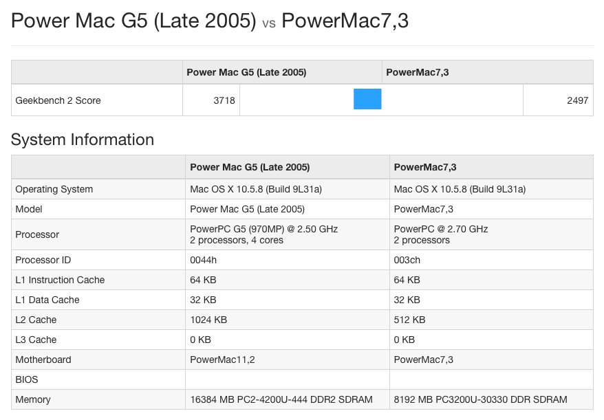

I'll toss in my results for my fastest 2 G5s. The Dual 2.7 vs the Quad since nobody else has dropped their 2.7 results yet.
Reactions: AphoticD

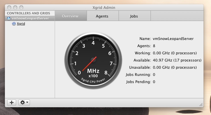

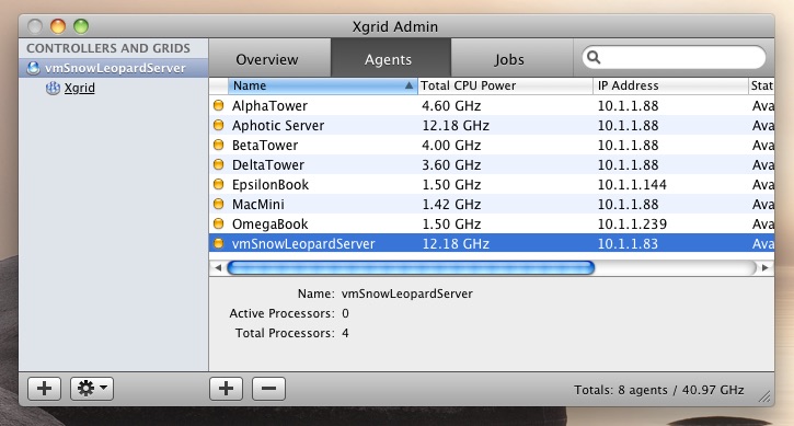

The Xgrid Cluster is ready and waiting...
Everything is currently live and waiting for an Xgrid job, except for the PB17 1.67 (which is suffering from HDD failure), the Titanium 867Mhz and two MacBooks.
