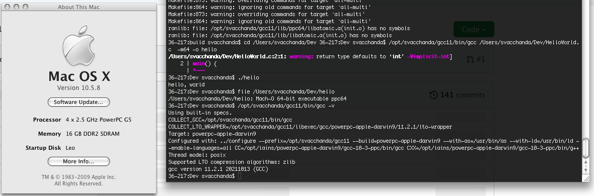

Mission [mostly] accomplished, we got a working gcc11 compiler on a PowerPC:
Anyone who may want to make it build:
1. First build and install this branch of gcc10 using Apple native gcc42: https://github.com/iains/gcc-10-branch/tree/gcc-10-3-ppc
2. Using newly built gcc10, build gcc11: https://github.com/iains/gcc-11-branch

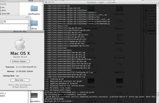

Apparently I have fixed gcc10 with Macports: just built mpich-gcc10 with CXX and Fortran enabled, it worked.
Code:
36-47:~ svacchanda$ port -v installed mpich-gcc10
The following ports are currently installed:
  mpich-gcc10 @3.4.2_0 requested_variants='-universal' platform='darwin 9' archs='ppc' date='2022-02-03T03:40:23+0800'
  mpich-gcc10 @3.4.2_0+fortran (active) requested_variants='+fortran-universal' platform='darwin 9' archs='ppc' date='2022-02-03T05:44:13+0800'
I had to manually place two dylibs from gcc10 built outside of Macports though: https://trac.macports.org/ticket/64577
Not sure if that was some random build error or what. Anyway, in result compiler appears fully functional.
P. S. Notice that, as of now, most probably it won’t build without significant manual work. I am not posting patches until I am sure everything works correctly. However if anyone wants to repeat that (or improve on), I did diff on Macports gcc10 source and Iain’s branch, generated patches and modified port file. Macports requires its own cctools and linker to be used, so setting will differ.

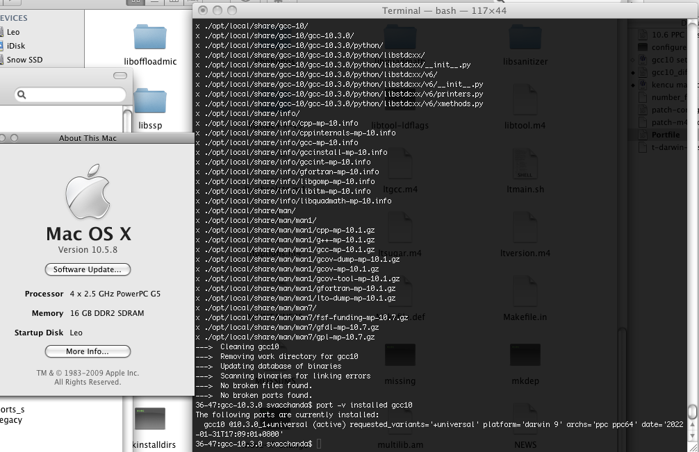

For those who don’t bother about Macports, all this is irrelevent. Both gcc10 and gcc11 do build on 10.5.8 for ppc/ppc64 (and on 10.6.8 Rosetta for ppc). One line to change is this, with example of gcc10 (don’t copy-paste, make a diff):
Code:
--- /Users/svacchanda/darwin.c    2022-01-30 15:15:59.000000000 +0800
+++ /Users/svacchanda/gcc-10-branch/gcc/config/darwin.c    2022-01-30 02:04:05.000000000 +0800
@@ -3569,7 +3569,7 @@
darwin_fold_builtin (tree fndecl, int n_args, tree *argp,
bool ARG_UNUSED (ignore))
-  unsigned int fcode = DECL_MD_FUNCTION_CODE (fndecl);
+  int fcode = DECL_MD_FUNCTION_CODE (fndecl);
if (fcode == darwin_builtin_cfstring)
P. S. This has been fixed in gcc12 and gcc10 10.4.0.

Besides, I have got gcc11ppc on 10A190 and 10.6.8.
Code:
svacchanda$ /opt/svacchanda/gcc11ppc/bin/gcc -v
Using built-in specs.
COLLECT_GCC=/opt/svacchanda/gcc11ppc/bin/gcc
COLLECT_LTO_WRAPPER=/opt/svacchanda/gcc11ppc/libexec/gcc/powerpc-apple-darwin10/11.2.1/lto-wrapper
Target: powerpc-apple-darwin10
Configured with: /Users/svacchanda/gcc-11-branch/configure --prefix=/opt/svacchanda/gcc11ppc --build=powerpc-apple-darwin10 --with-as=/Developer/usr/bin/as --with-ld=/Developer/usr/bin/ld --with-sysroot=/Developer/SDKs/MacOSX10.6.sdk --disable-multilib --disable-target-libsanitizer CC='/opt/svacchanda/gcc10ppc/bin/gcc -m32 -arch ppc --sysroot=/Developer/SDKs/MacOSX10.6.sdk' CXX='/opt/svacchanda/gcc10ppc/bin/g++ -m32 -arch ppc --sysroot=/Developer/SDKs/MacOSX10.6.sdk'
Thread model: posix
Supported LTO compression algorithms: zlib
gcc version 11.2.1 20211013 (GCC)
svacchanda$ sw_vers
ProductName:    Mac OS X
ProductVersion:    10.6.8
BuildVersion:    10K549
