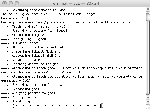

I am trying to build gcc8 via Macports on G5 Quad running 10.6 PPC.
I have built gcc7 earlier (thanks to helpful suggestions of kencu here), and it took about 7 to 9 hrs from what I recall. But now I am at 20,5 hrs with no end seen. Wonder if the compilation is hopelessly stuck or I should wait indefinitely until the Terminal spits out an error and completes the process.
I can see cc1 process in activity at 90-100%, but in Terminal nothing moves for many hours already. Dots do not move, process header is the same.
The log file is stuck at here for unknown time (at least nothing changed for past 1,5 hrs with it):
Leave it to build. May take days on these old machines mate. If it’s still building that’s a good sign at least. Did you set the ‘-v’ verbose flag?
For good or bad, I had to force reboot, since due to completely unrelated issue I got spinning wheel of death.
However it seems that compilation got stuck at something related to ld, which was reported to cause problems on PPC already. Notice the last sentence in the log:
