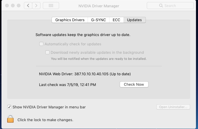

In an effort to keep doing client work I swapped in a GeForce GTX 970 card I had sitting around. Via Screen Sharing from another MacPro on our network I was able to update the Nvidia Web Driver and CUDA and restart. Once I did that my desktop appeared after booting, but the poor performance of the card makes it essentially unusable.

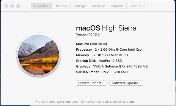

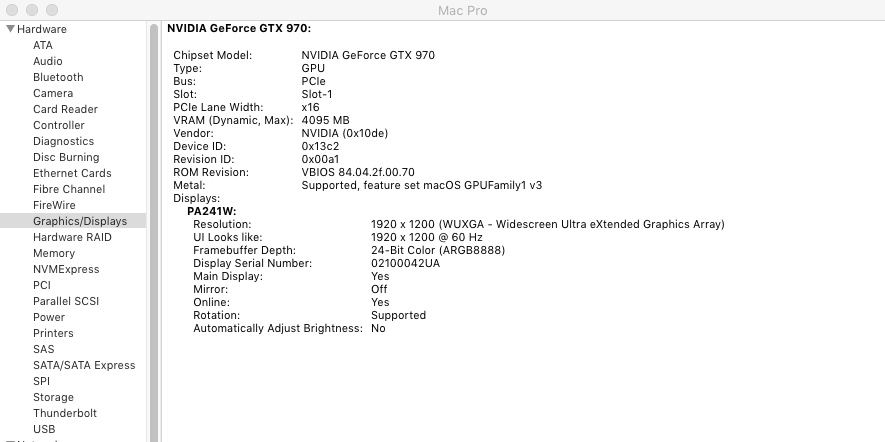

Here are some screen grabs of my setup:

Did you tried to clear NVRAM 3 times in sequence?
Maxwell and newer NVIDIA cards are very finicky with some NVRAM configurations and the first thing you do to debug these cards are the 3 step cleaning of the NVRAM. You will need to activate again the NVIDIA web drivers.
Please try
1) Disable SIP
2) run the following command in terminal to downgrade the web driver back to V378.
Code:
bash <(curl -s https://raw.githubusercontent.com/Benjamin-Dobell/nvidia-update/master/nvidia-update.sh) 378.10.10.10.25.106

Please try
1) Disable SIP
Code:
This did the trick, thanks so much!
