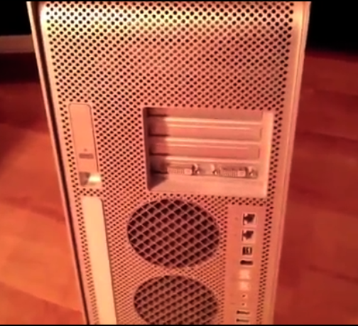

Wow... I just realized that I could have gotten a Quad-core PowerMac G4 for $40. In September, I found a place that had tons of Dual-core/Dual-processor PowerMac G5s for sale. Each was $40, and the guy said he ran out of the Quad-core models. I noticed that one model had dual ethernet and that odd, long, rectangular stripe on the backside. (on the left, underneath the latch). Since I was seeing it in a picture, and obviously couldn't see the insides, I thought it was one of the newer 2.5 or 2.7Ghz Dual-core models, so I obviously didn't want to get one of those things. Instead, I picked out a model that happens to be an original 2003 2Ghz Dual processor. Looking back on it, I realized that only the Quad-core models have dual ethernet and that strip on the back, if I am not mistaken. Shame; the rear foot was bent, but I can't believe a $40 Quad-core was sitting there and I missed it! 🙁
All of the late '05 models have dual ethernet and the external antenna like that. It could have been a dual core 2.0, dual core 2.3, or quad core 2.5. The late dual core models are actually pretty nice machines and have a lot of the same advantages of the quads(i.e. PCI-e slots and 8 slots for DDR-2 ram), but are air cooled.
Where do you live that they have places like this? That sounds like a nice deal
