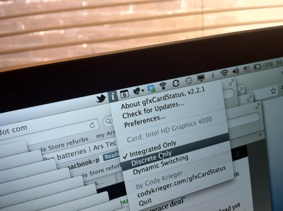

gfxCardStatus allows users to control which graphics card is enabled -- integrated or discrete -- on MacBook Pro models with multiple graphics cards. By more precisely controlling when each graphics card is enabled, users can improve system performance or battery life. gfxCardStatus is a menu bar application for OS X that allows MacBook Pro owners to view which GPU is in use at a glance, and switch between them on-demand.

Love the new[er] version of gfxCS with the popup mode switch indicator. It’s interesting to watch when it’s on dynamic switching, and you fire up some apps and it switches back and forth a few times.
