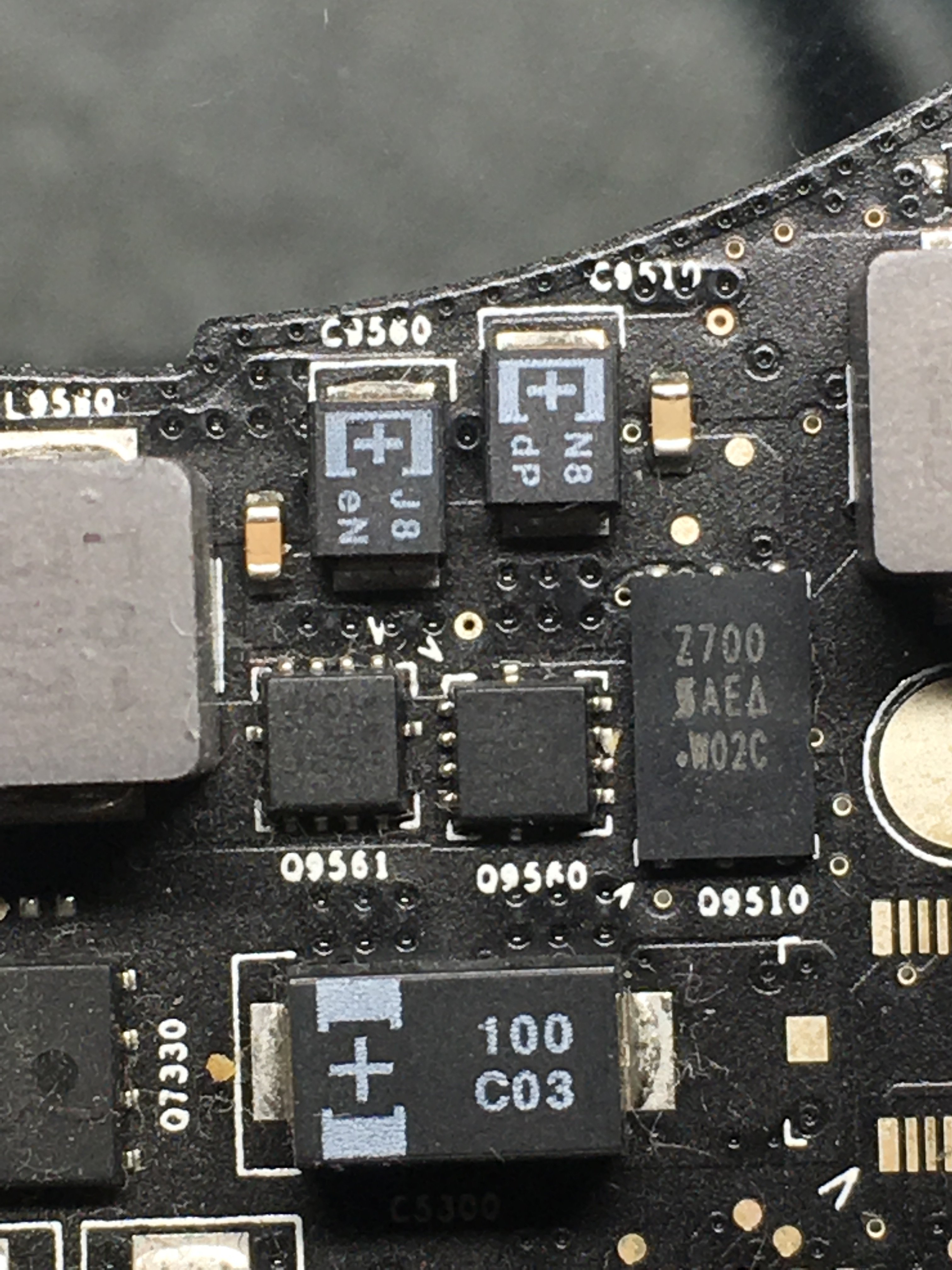

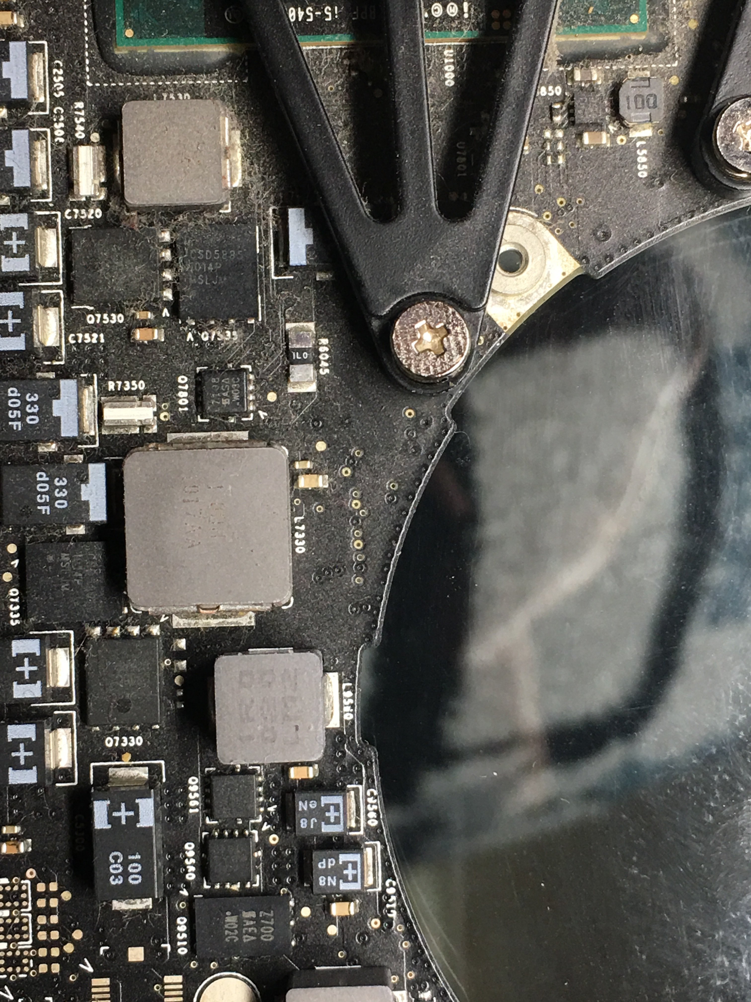

Hi all !
I have exactly the same problem on my MacBoook Pro mid-2010, but it's 17 inches. My logic board looks a bit diferent, tantalum capacitator is not exactly the same number that I see in your photos.
in 15-inch model, I see its "N8 / dN"
and my 17-inch model, in C9560 , I see "J8 / eN". Near that, in C9510 its "N8 / dP"
I attached photos, any idea? , I should replace both ?
Thanks guys!

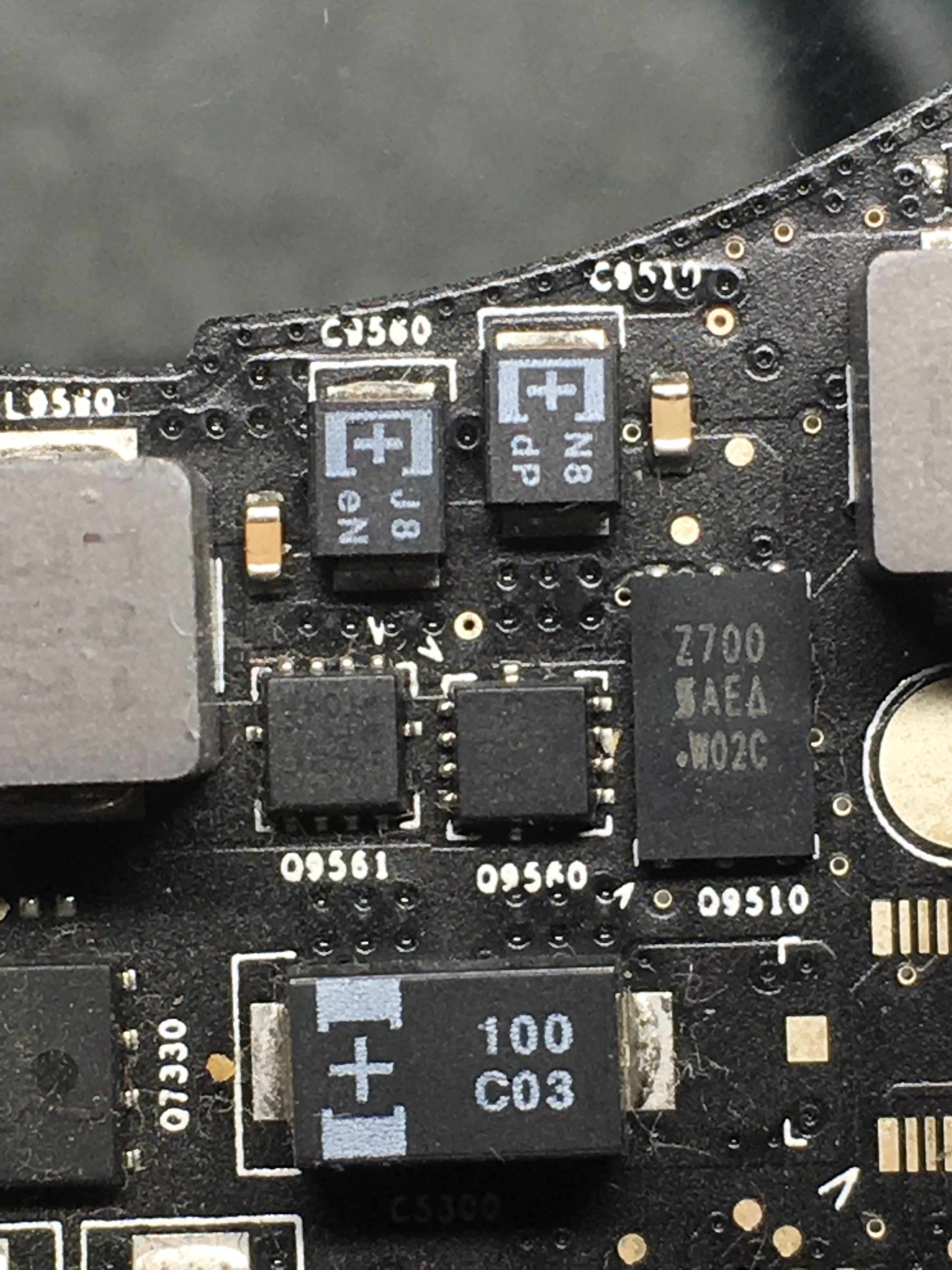

Hi all !
Thanks guys!
View attachment 691801 View attachment 691802
820-2849-A model?
This circuit is a little different. Replace both, c9510 to 330uf 2v and c9560 to 220uf 2v, too.
820-2849-A model?
Thanks fabioroberto,
Yes, it's 820-2849-A model. I guess I can replace them with aluminium or ceramic ones ? I do not know if I will have enough room to put both aluminium there.
So, I need:
J8 / eN : 220uF, 2.5V , Tolerance 30%
N8 / dP: 330uF, 2V , Tolerance 0%, +100%
I only found aluminium 2V with 7.3mm long, I think it not will fit , neither performing scratching.
Can I replace that one with ceramic 2.5V ? like this: http://www.mouser.es/ProductDetail/...sSlwiRhF8qqz126ahU0Dj1rvNWkjQp62QafJZati3Sw==
and 220uF:
http://www.mouser.es/ProductDetail/...sSlwiRhF8qp0AK2agfPDUz33CYfyhui86CMEh706zKw==
So, I need:
Can I replace that one with ceramic 2.5V ? like this: http://www.mouser.es/ProductDetail/Taiyo-Yuden/PMK325AC6337MM-P/?qs=sGAEpiMZZMvsSlwiRhF8qqz126ahU0Dj1rvNWkjQp62QafJZati3Sw==
and 220uF:
http://www.mouser.es/ProductDetail/Taiyo-Yuden/PMK316BBJ227ML-T/?qs=sGAEpiMZZMvsSlwiRhF8qp0AK2agfPDUz33CYfyhui86CMEh706zKw==
The preference is always for the alumium cap. But, in this case, If you dont have the necessary skill to soldering him, as using wire copper as bridge (I'll start a private conversation with you about this), you can choose use the ceramic ones that you mentioned above.
