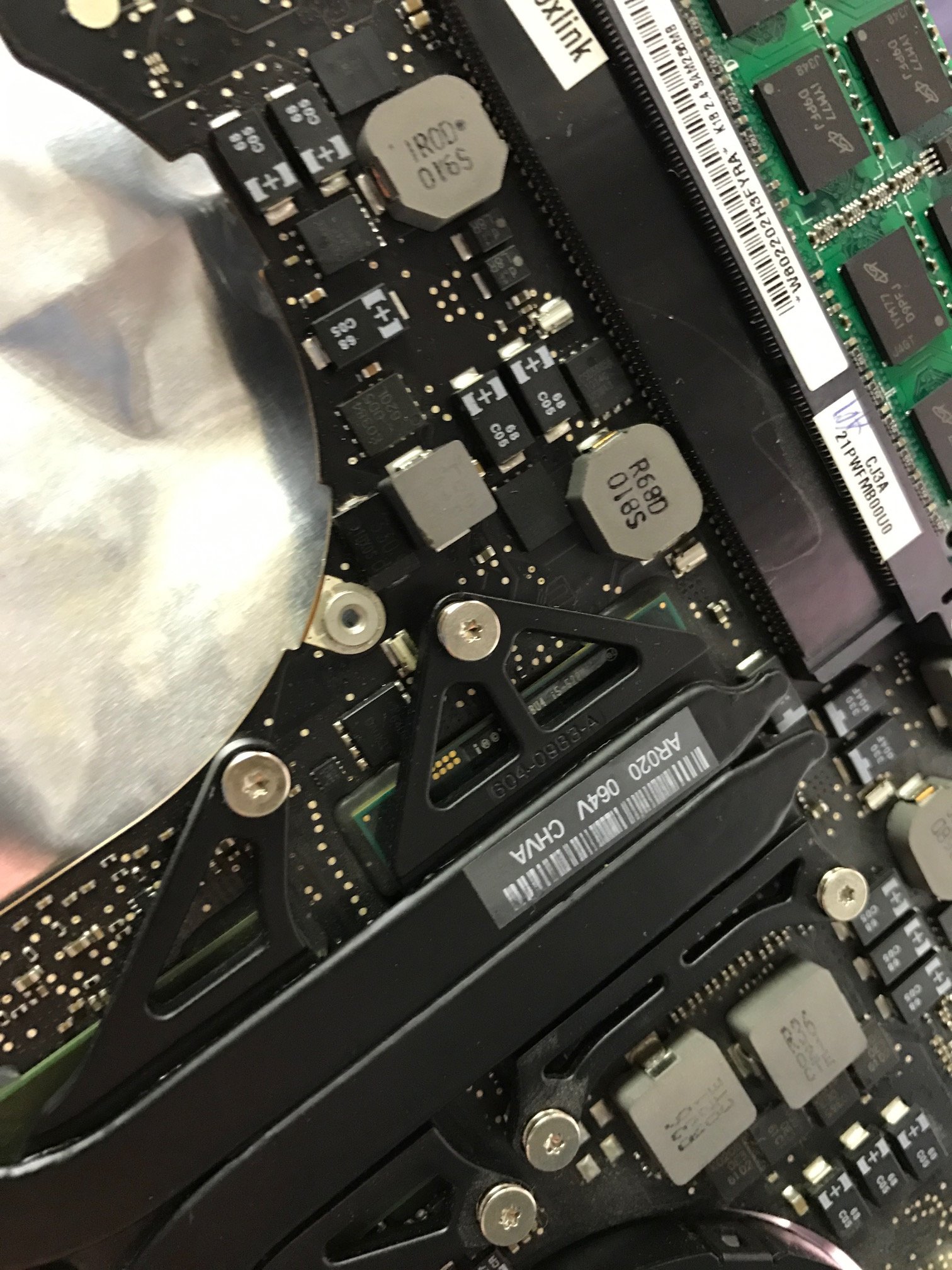

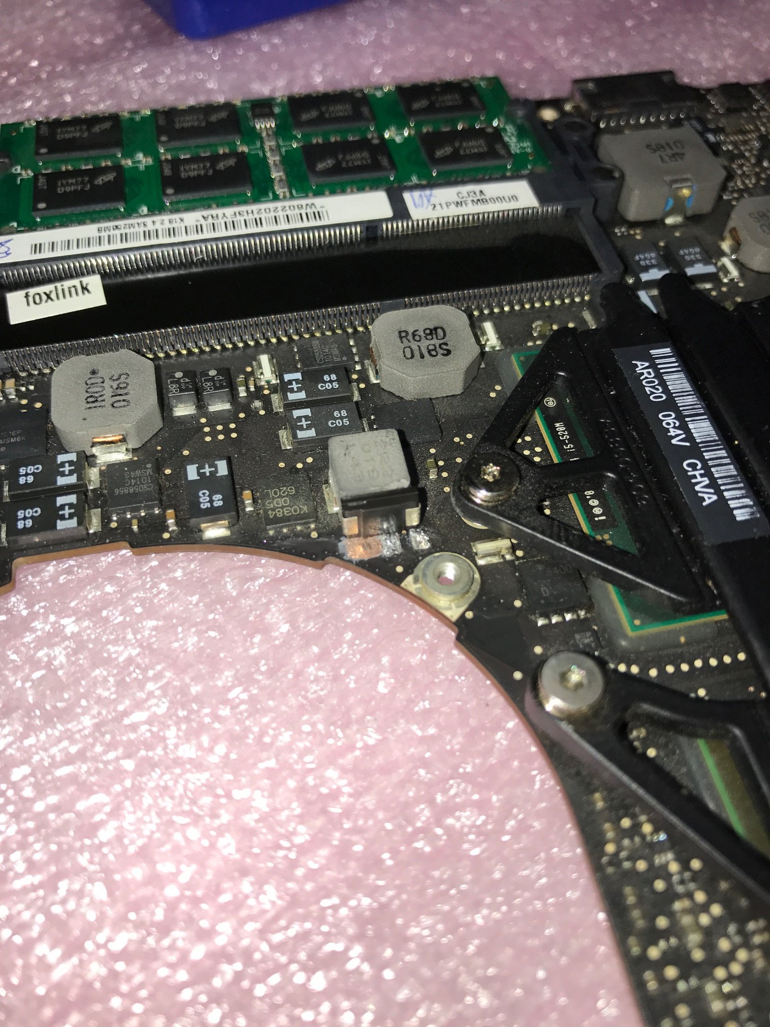

Finally getting around to an update.
First, a big thanks to fabioroberto and iMacC2D for the amazing information and help.
The .kext file changes made my MacBook usable again instead of crashing constantly, works great for most everything. I did find that there were some limitations, like hooking up to an external display sometimes, so I decided to try the capacitor swap. The fix was overall pretty easy if you have some soldering equipment. Reading the repair manual is mandatory for anyone doing this this fix. So is watching the Louis Rossmann video.
Since putting everything back together it's like my MacBook is new again. Here's some pics of the process taken with iPhone 7.

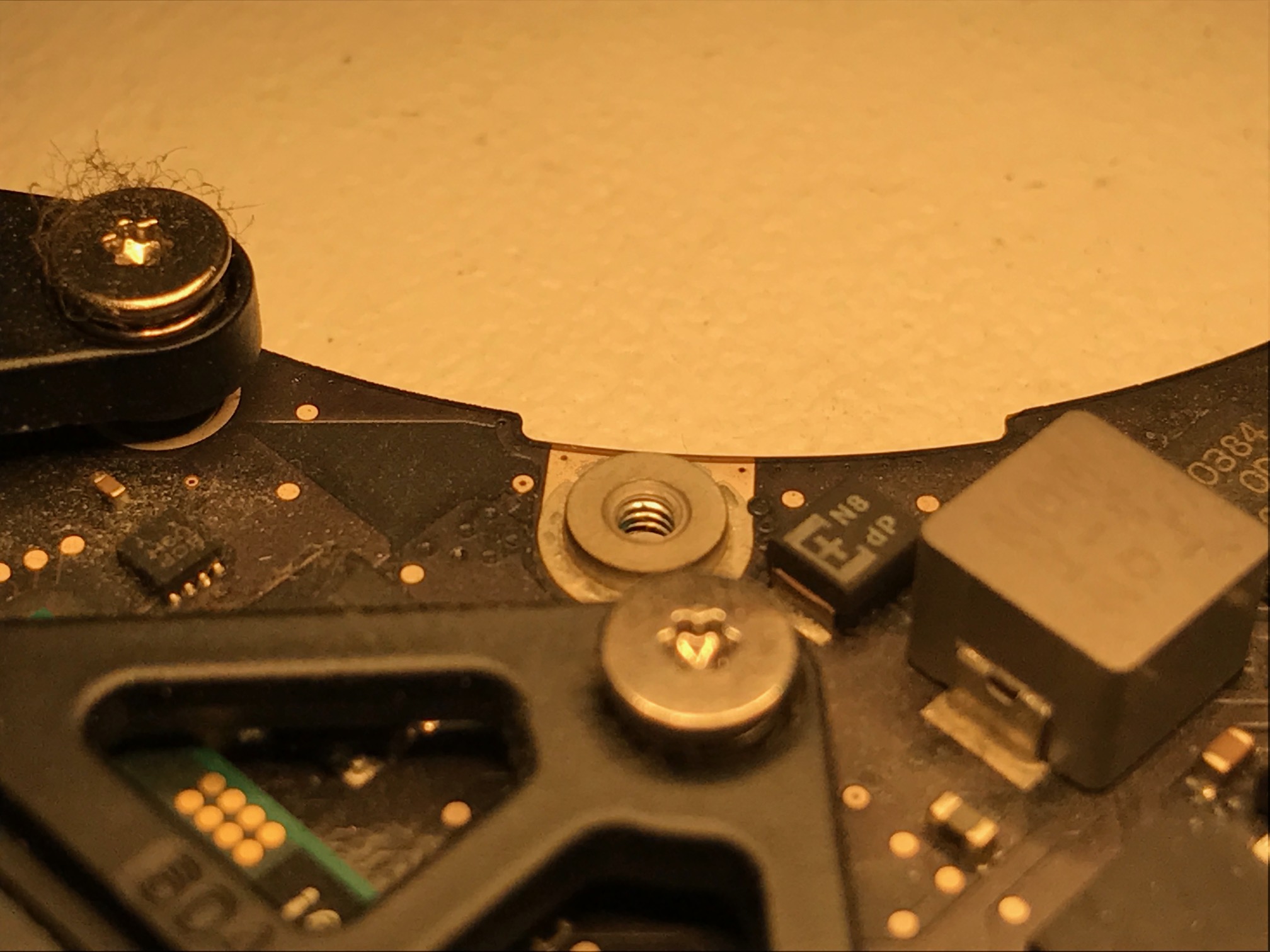

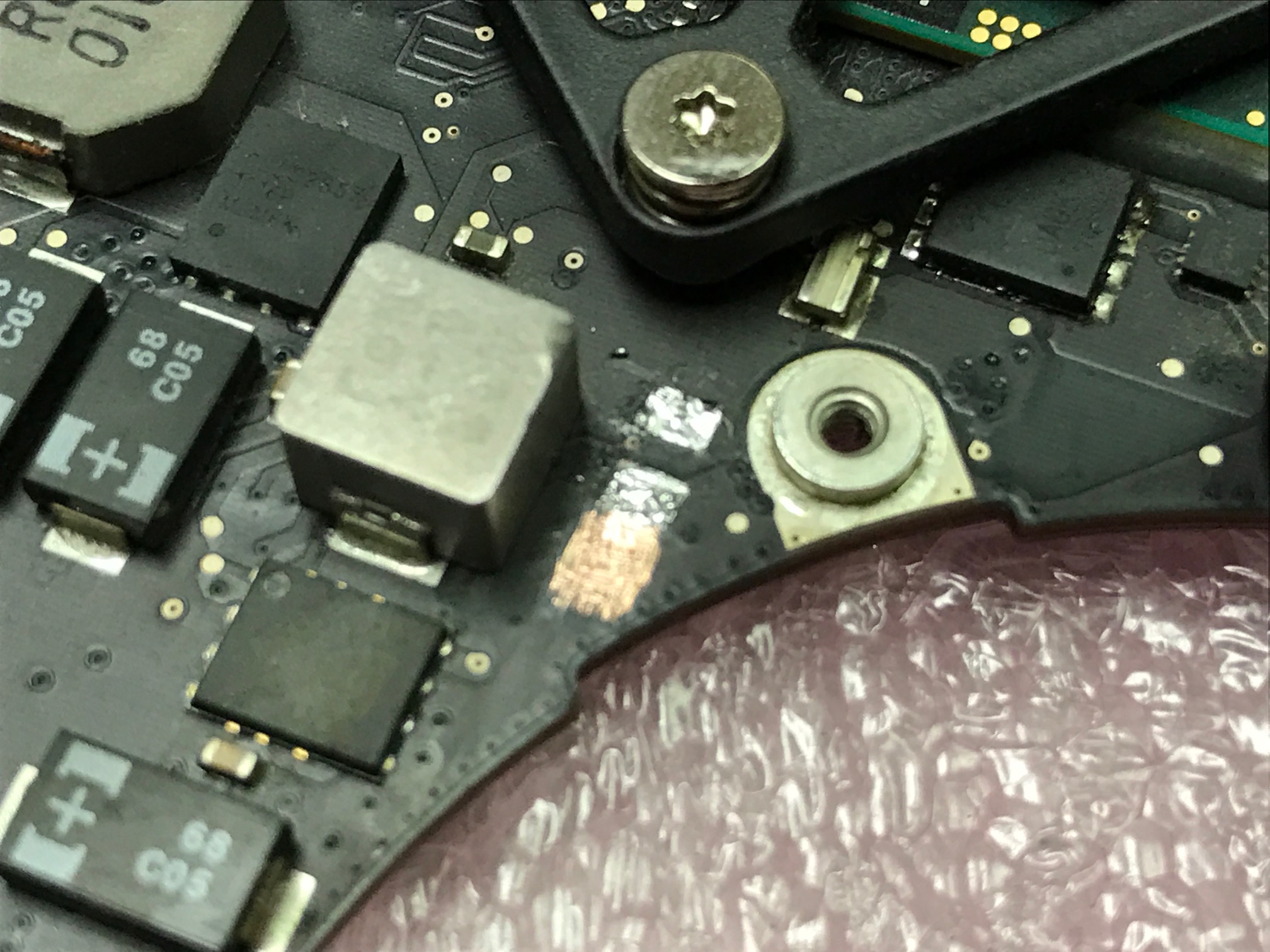

Fabio I really appreciate what u did to help me, am writing from my macbook mid 2010 repaired, i want to share to the community my process repairing the macbook.

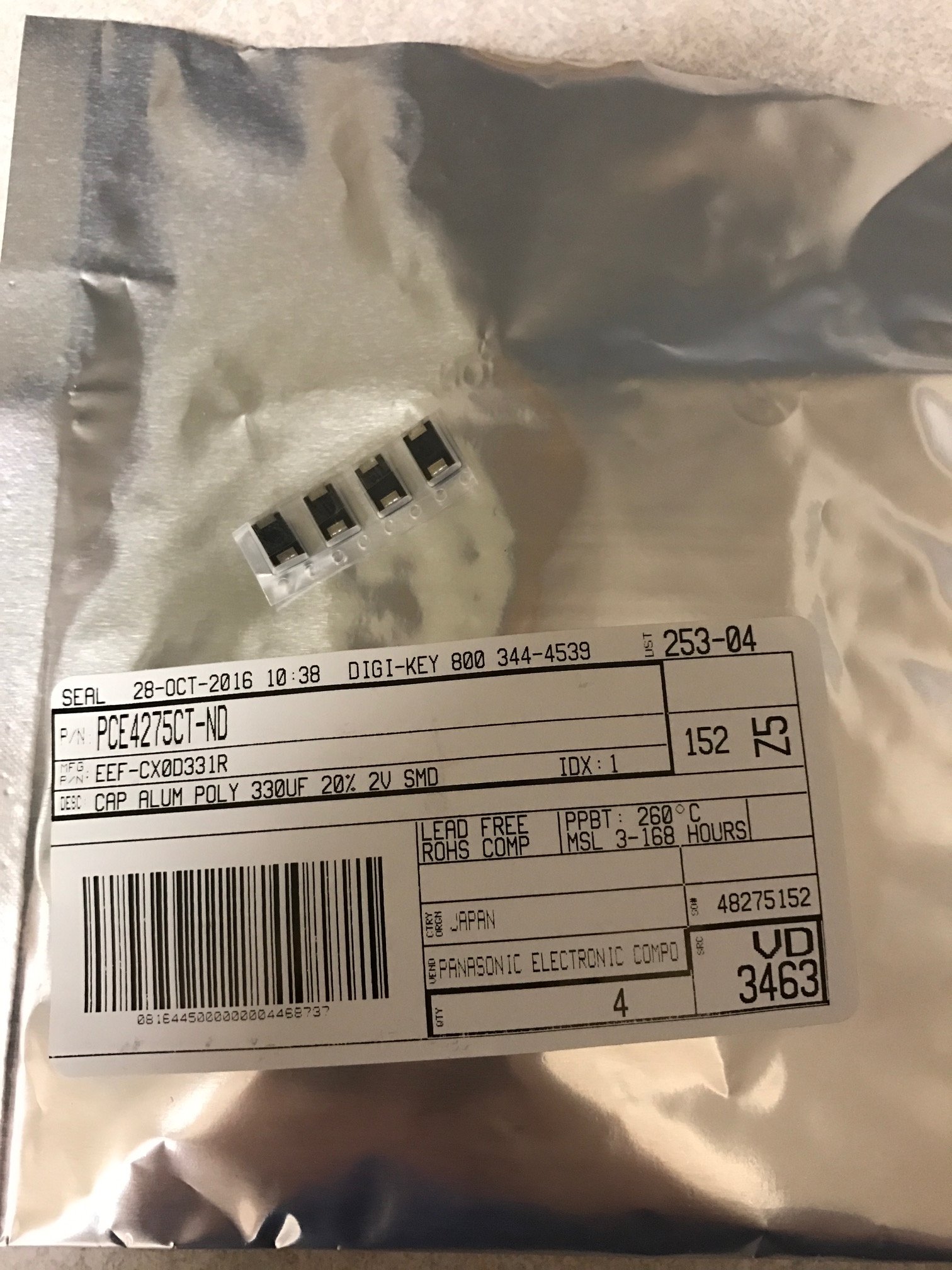

First of all i used non-tantalum Capacitor extracted from a mid-2012 broken motherboard (C160Z, thanks again) because I did a deep search between tantalum and non-tantalum capacitor and what i found was that tantalum are very unstable and poor reliability, a lot of people have very bad comments with this type of capacitor,I read it's good in high frequency, but also that this type of capacitor is common to fail Bypassing IC Supplies (this is what the capacitors is doing in the mac, That's why it fails in most mid 2010 motherboards? What happened Apple engineers?? well am not very expert in this, i just want to have a powerful capacitor that can get my nvidia never fail again, at least not because the capacitor.
So here is it, i took pictures to show

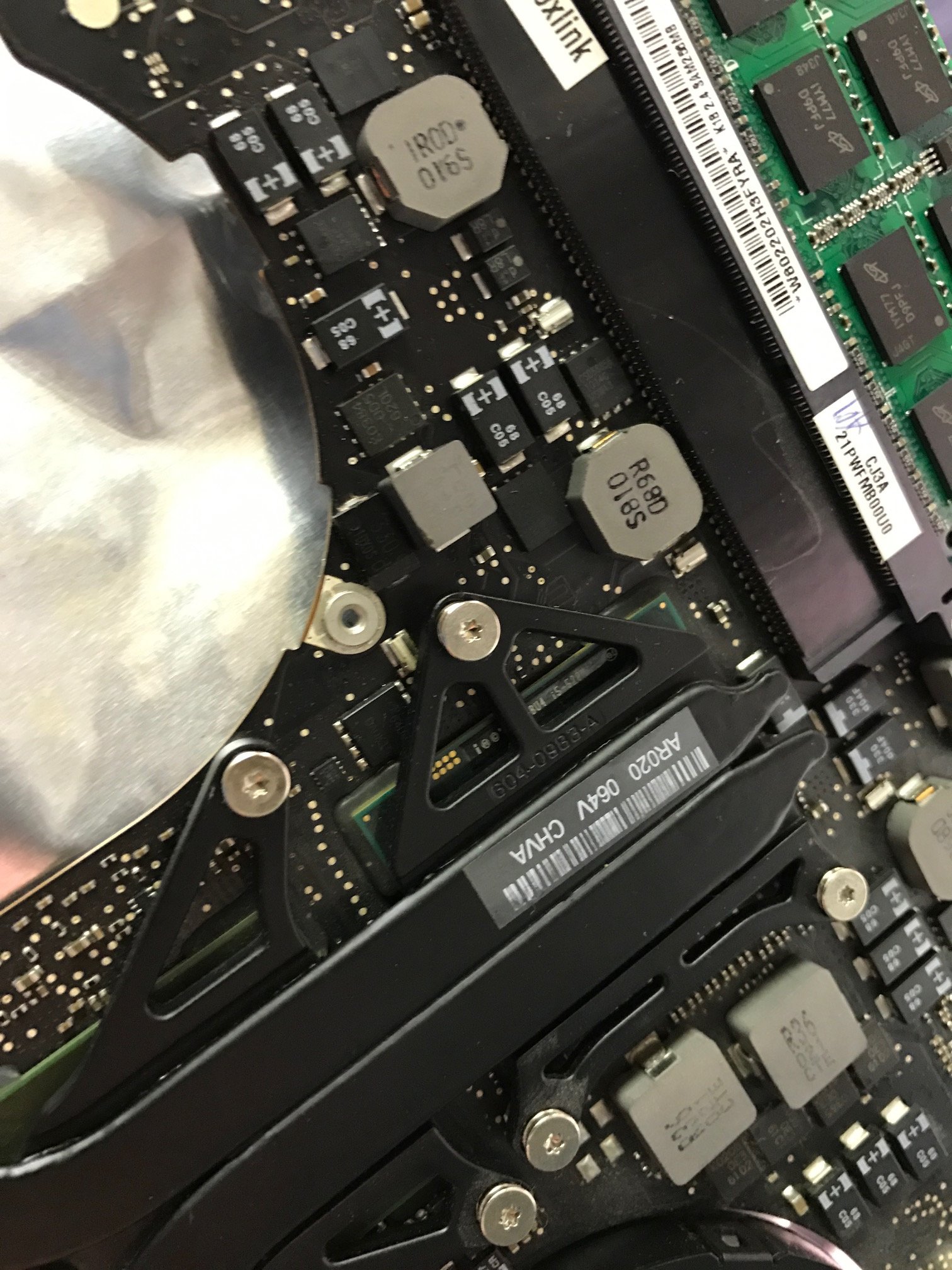

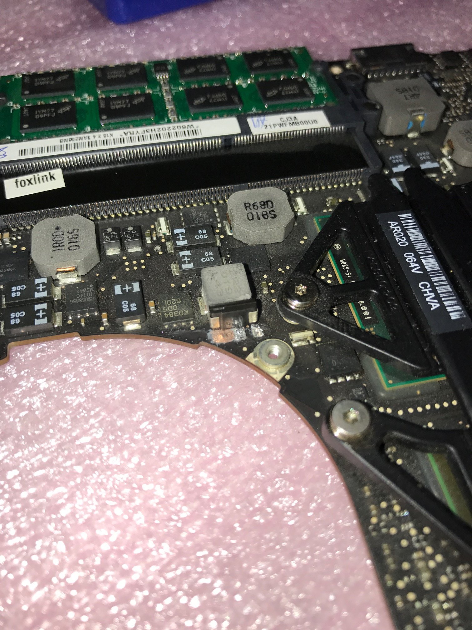

1. I open up my macbook, then u can see that horrible capacitor making my mac unusable. (yes, it's very dirty i cleaned up later)
2. I extracted non-tantalum 330uF Capacitor from the macbook pro mid 2012 broken motherboard, it's bigger than the tantalum one, but thats no problem
3. I extracted the tantalum problematic capacitor from MacBook Pro mid 2010
4. Okay now here is the non-tantalum capacitor if someone want to see it. (So let's make it and get this machine work)

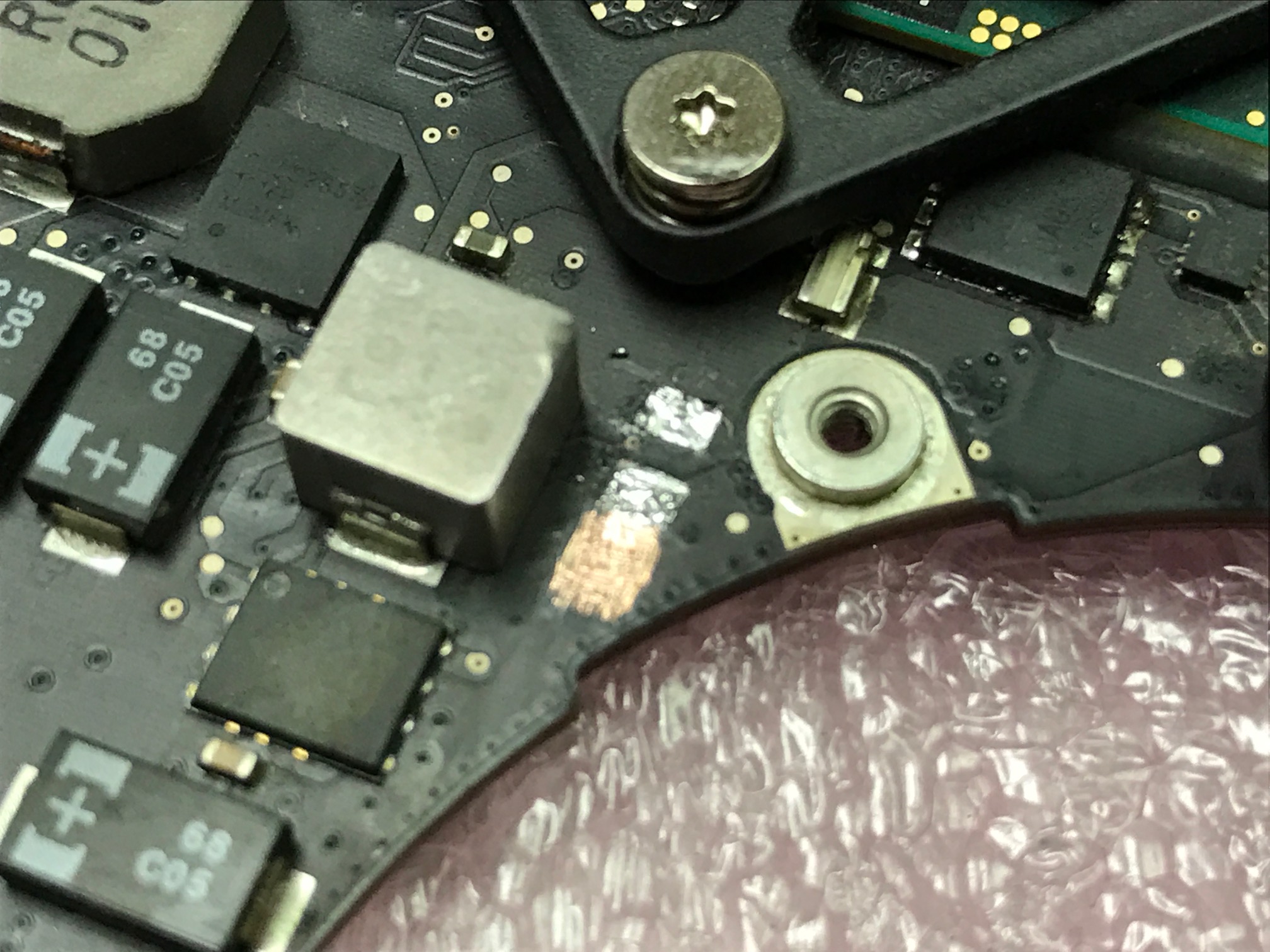

5. I had to scratch a little to fit in the non-tantalum (Yes this was said before)
5.1 Okay then I weld the scratched part so it can make contact with the bigger one
6. It's ready to battle again for a good while.

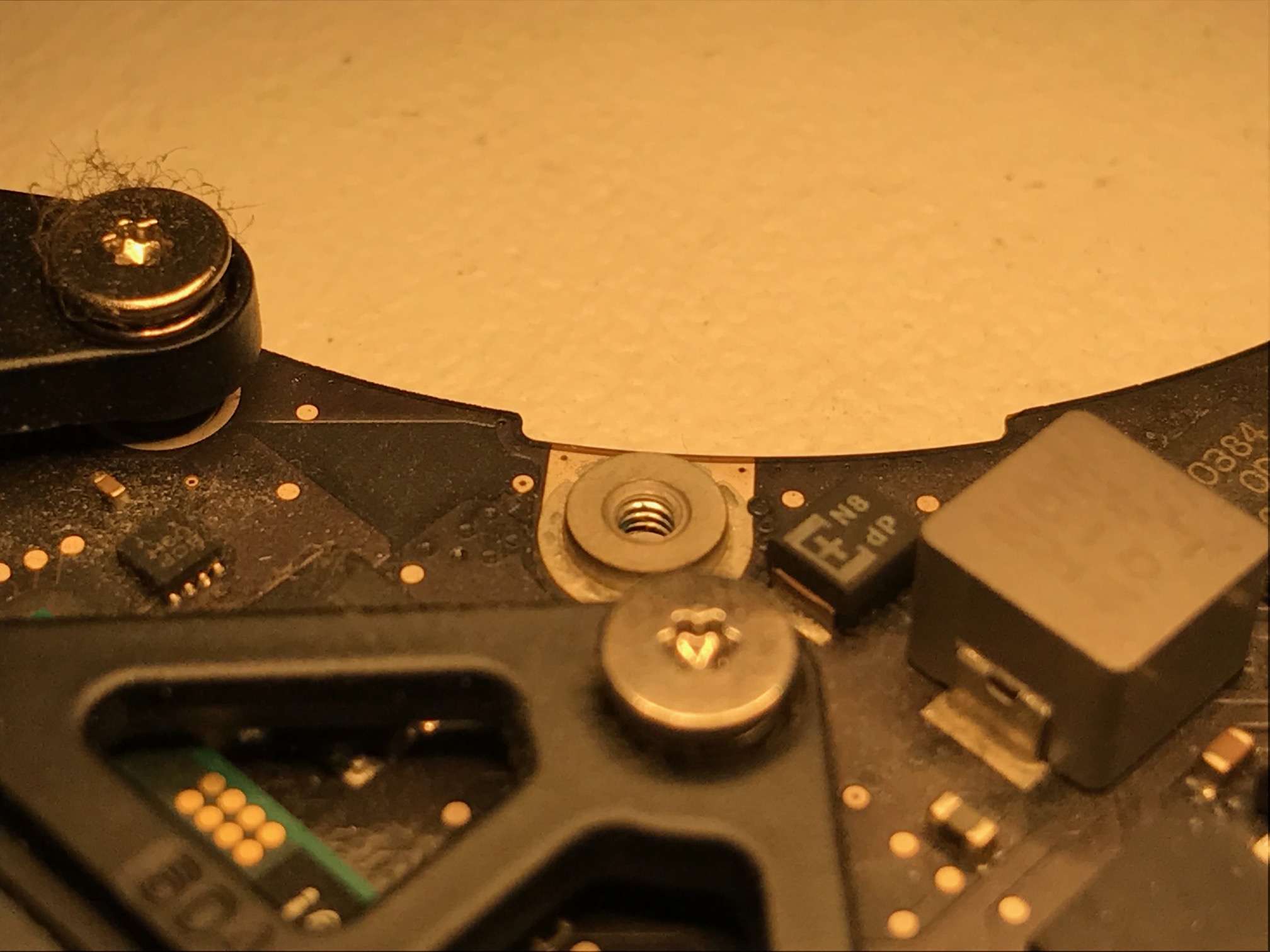

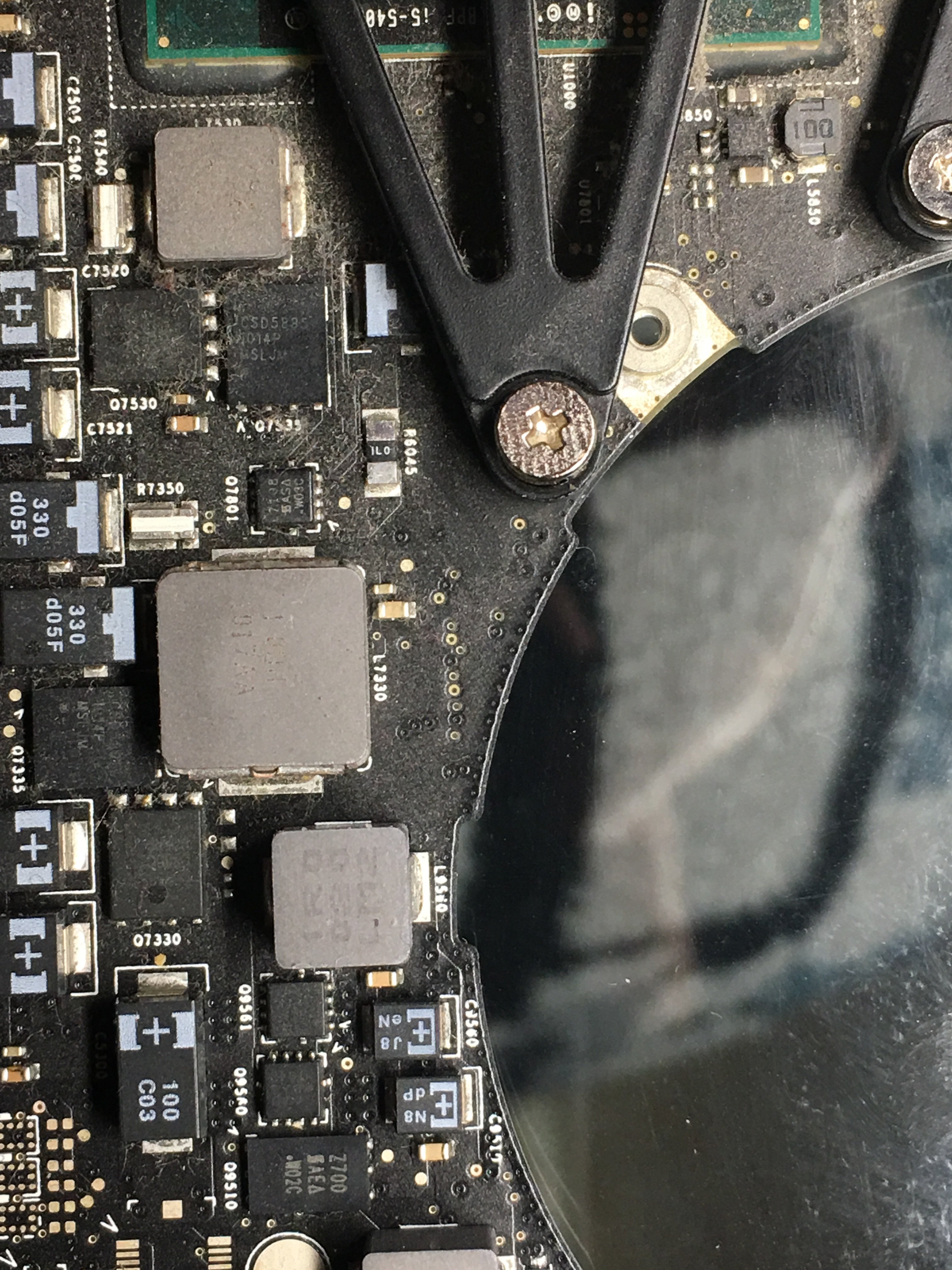

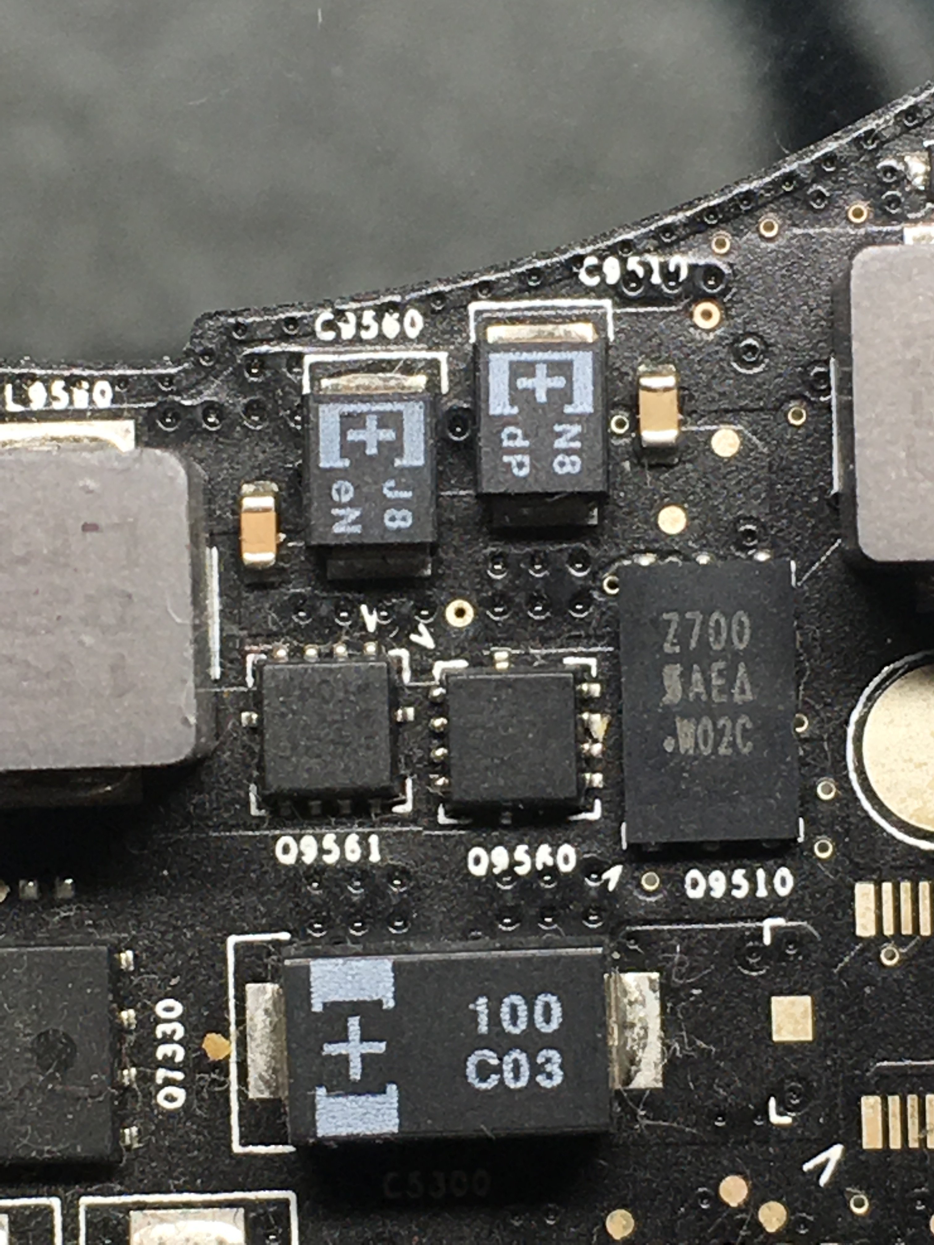

Hi all !
I have exactly the same problem on my MacBoook Pro mid-2010, but it's 17 inches. My logic board looks a bit diferent, tantalum capacitator is not exactly the same number that I see in your photos.
in 15-inch model, I see its "N8 / dN"
and my 17-inch model, in C9560 , I see "J8 / eN". Near that, in C9510 its "N8 / dP"
I attached photos, any idea? , I should replace both ?
Thanks guys!
View attachment 691801 View attachment 691802
This problem doesn't affect the 17". If you're having this issue on the 17", it is likely something else.

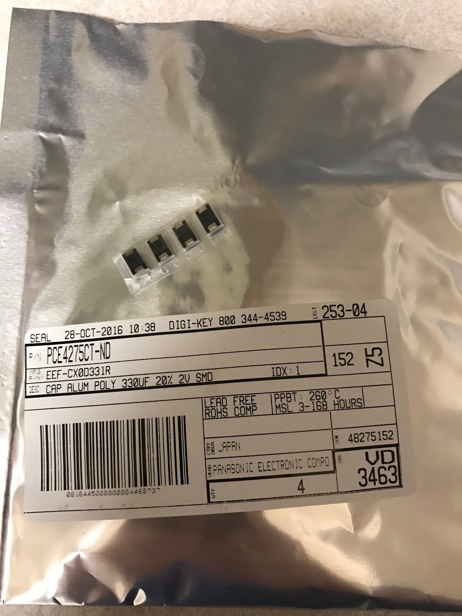

It is and I've also ordered non-tantalum capacitors as well, covering both bases in case my repair shop says that they won't bare a track on the logic board. I'd rather it fail over time again knowing that it can be repaired rather than leaving it slightly crippled with the kext fix.
I don't know if it's all tantalum capacitors that are bad, if there are better brands, what's causing it fail etc. It would be great if an electronics expert could shed some light 🙂
My preference when I take it to the shop is for them to fit a non-tantalum cap, but if they won't then at least I have one that's the same physical size and whatnot.

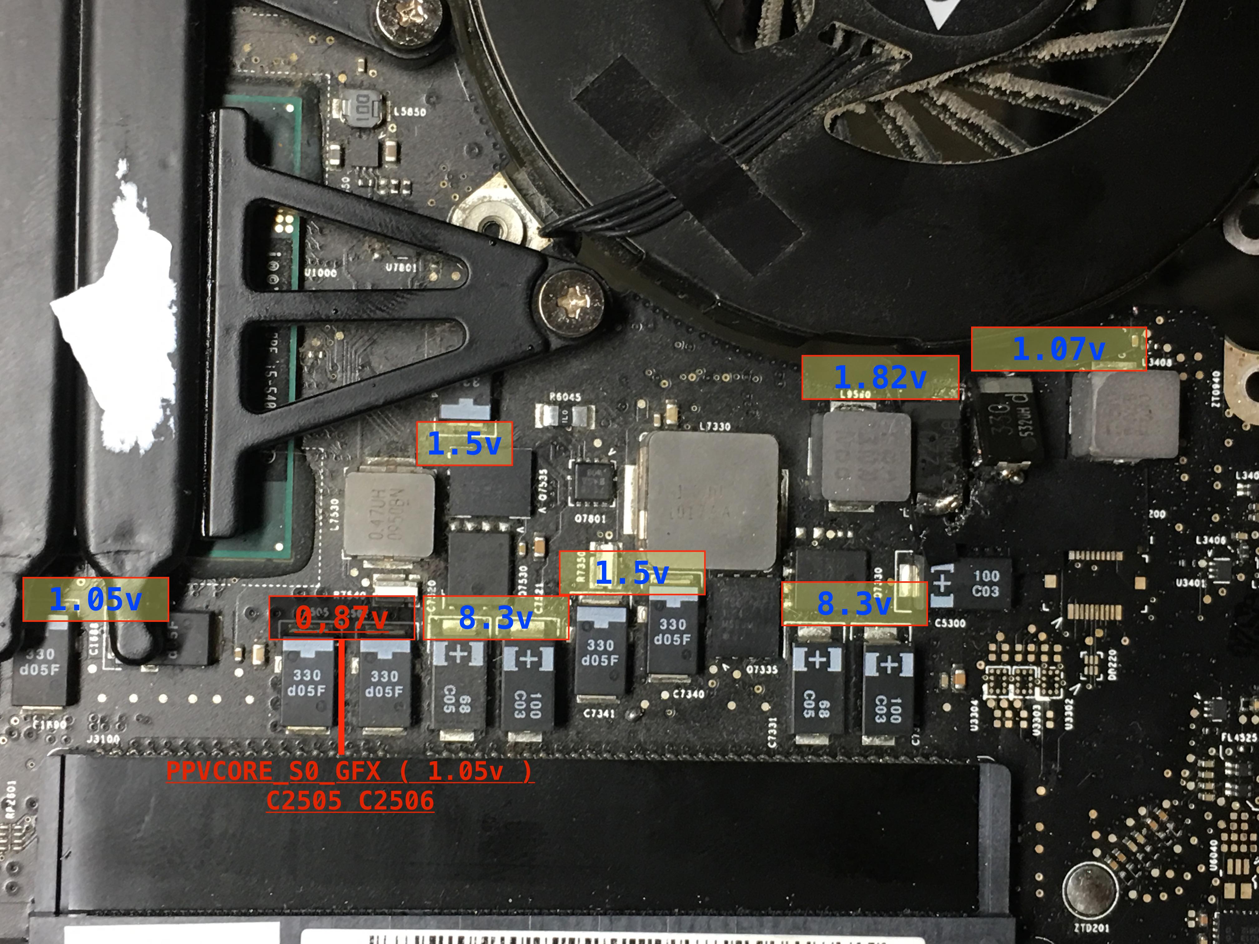

Your are right la rossmann, I already replaced caps and the problem is still there... I checked some caps, and got schematic diagram of my motherboard.
Take a look at this photo, I write voltage for each cap. I really don't know if some cap its "failing".
In shematic, PPVCORE_S0_GFX its 1.05v ( i don't know if I read it correclty if it should be always at 1.05v or not.. ), and i got 0.87v.
At right of "0.87v" , caps are (C7520,C7521) Shematic says: PPBUS_G3H its 6v , but I got 8.3v! .. missmatch ?!
I'm not an expert in these... so if someone can give me a clue.. will be appreciated 🙂

Folks, thanks you very much for sharing the Kext fix and the capacitor details.
A special thanks to fabioroberto, iMacC2D and all those who posted pictures of their capacitor repair. Thanks also to l.a.rossmann for his videos on the capacitor fix. Funny stuff and I loved the autograph request!!
I have had the kext solution in place on my mid-2010 15" MBP for nearly a week and have just had one kernel panic in the past few days, when before that, I was getting one every few minutes.
I have ordered the non-Tantalum capacitor here in the UK, and had I been in Manhattan, I would have gladly paid for Louis to fix my comp. I have never used a soldering iron in my life, but there is always a first time. If I can't find a local technician in London, I will buy a soldering iron!
Once again, thanks for the solutions! (I signed in specially today to thank members here for the solutions).
Reactions: fabioroberto

Update. All works fine after resoldering the capacitor.. can go on doing whatever, played games, working with music programs, graphics.. but... when I open and use Safari for just google or browsing . I get the same sudden restarting as before.. anything and everything else works just fine.. no clue how is that corresponding to anything else.. any ideas or what else to try to "force" the reboot..?

Just leaving a message to happily say I am another capacitor fix! Thanks to @fabioroberto and others for all the help.
The first cap I had soldered in must have been faulty. Second one worked the best. Persevere folks!
Cheers

Thanks everyone who has documented the capacitor solution! If I ever get this problem I will replace it. Great to know it's just a simple hardware fix away if it ever happens!
Hello everyone 🙂
I am having some trouble sourcing the capacitor locally, international shipping is costing 6 times the price of the capacitor haha.
PMK325AC6337MM-T
http://www.digikey.com.au/products/en?keywords= 587-3976-1-ND
I found this one locally and the shipping is a bit cheaper- seems to fit the specifications
MURATA GRM32EC80E337ME05L
http://au.element14.com/murata/grm32ec80e337me05l/cap-mlcc-x6s-330uf-2-5v-1210/dp/2671590
Do you guys think this one will be okay?
also I wrote what I think the process for soldering should be, if it's correct please let me know 🙂
It seems like this to be the solder process:
-Isopropyl Clean
-Flux coverage
-Hot air, remove the capacitor (using hot air rework station)
-Flux and some tweezer scratching to make space and clean up (depends on capacitor but is not required for the capacitors I have listed.)
-Flux, solder paste and seat Capacitor ontop
-Heat, it sets and be done!
Thank you all for your help and the great vibe of this thread 😀

Up-thread, people have reported success with both the capacitors you've listed, the Taiyo Yuden PMK325AC6337MM-T and the Murata GRM32EC80E337ME05L - they are both ceramic ones and polarity is not a concern. Another advantage of the Taiyo Yuden and the Murata is that you will not have to scrape the Logic Board as they are similar in size to the current capacitor. However, for reasons unknown to me, the general advice on this thread is to opt for Aluminum Polymer capacitors, such as the Panasonic EEF-SX0E331ER, available here:
http://www.digikey.com.au/products/en?keywords= PCE4827TR-ND
This is slightly larger than the current Tantalum c9560 capacitor, so the board will have to be scraped.
See Louis' video posted above on how that's done, and the soldering process. Good luck!
Thank you very much ViShVa for your reply 🙂
I shall rewatch Louis' videos again.
In regards to the Panasonic capacitor being recommended- as ViShVa is unaware, can someone tell me why this would be a better choice over the ceramic ones I posted?
Thank you!
Yesterday, there was a 'Software Update' for 'El Capitan' 10.11.6. After installation and restart, as expected, the Kernel Panics returned. Re-installing fabioroberto's modified Kext solved the problem.
Thanks again. 🙂
