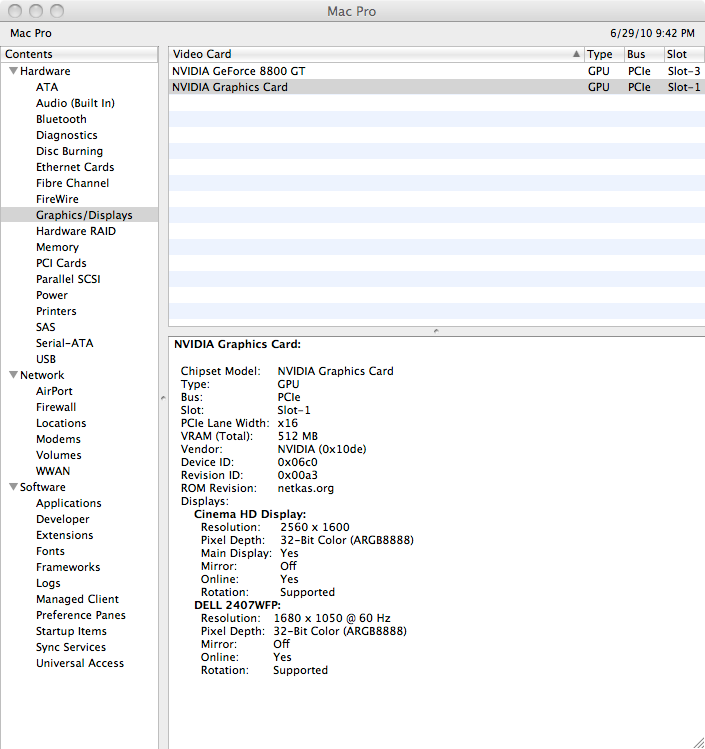

Using the "leaked" Nvidia drivers AND Netkas little "ATY_Init" extension, I am staring at desktop rendered by a GTX480. After I read the Hackintosh stuff, I realized that it shuld work in real Mac as well.
So, I found a "just fell off a truck" sort of deal on CL for a GTX480, and ran it home.
With the same old Netkas ATY_Init that worked for GTX285, I got GTX480 working from OSX desktop on.
It behaves differently from Hackintosh reports. Perhaps I need to add Device ID into Netkas extension, or try some of the ones used by Hacky folk.

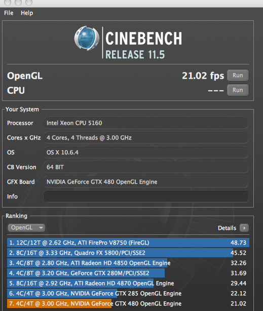

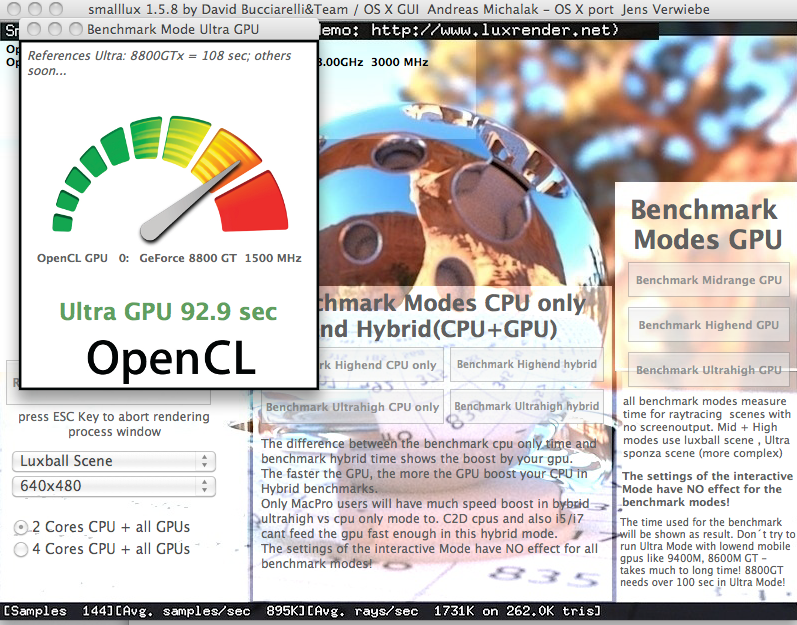

Scores are worse than GTX285 on everything I tried thus far.
More pix coming.

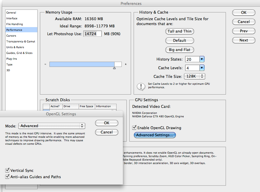

BTW...CS5 seems to know what it is, and I don't have current CUDA drivers.

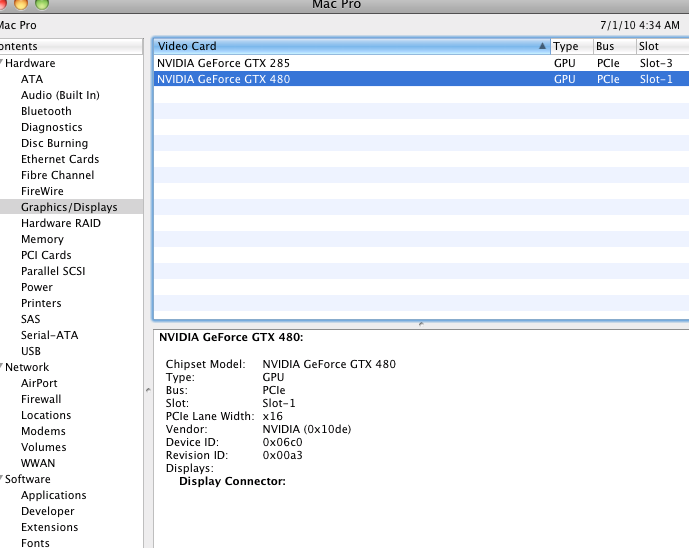

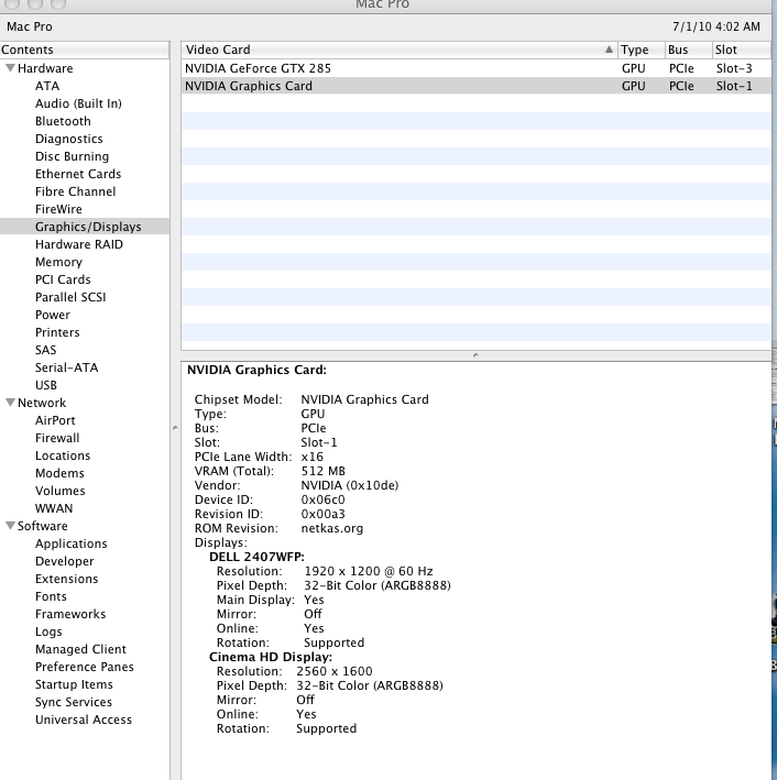

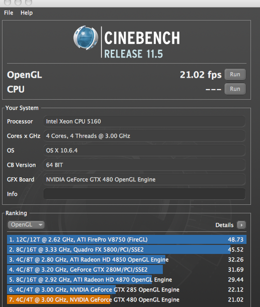

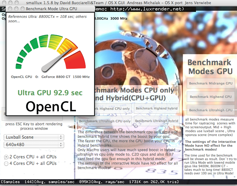

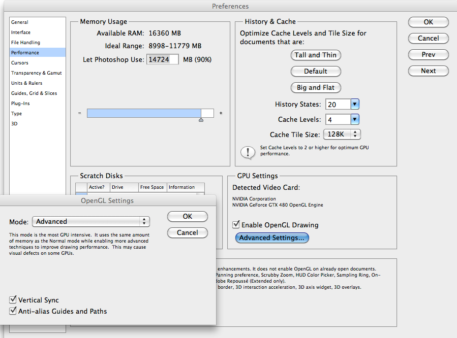

Fascinating.
If CS5 knows what it is, is it leveraging it in any way?
I don't know how I would test this.

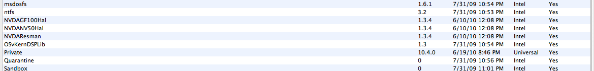

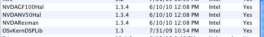

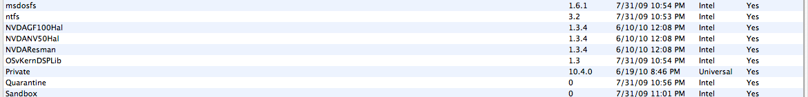

Per some hints at InsanelyMac, I have added the device id to the NVResman kext.
No change.
OpenGl test scores still much lower than GTX285.
I have tried Bioshock and Doom3. Oddly, Bioshock runs great, while Doom3 is sluggish.

21fps on cinebench? That seems kinda weak for a 480. My mobility 4850 got 50fps on the same benchmark.

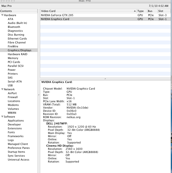

I decided to refresh my OS installs to get rid of any refuse from other experiments.
I now have a clean 10.6.3 w newer Nvidia drivers and a 10.6.4 w Nvidia drivers.

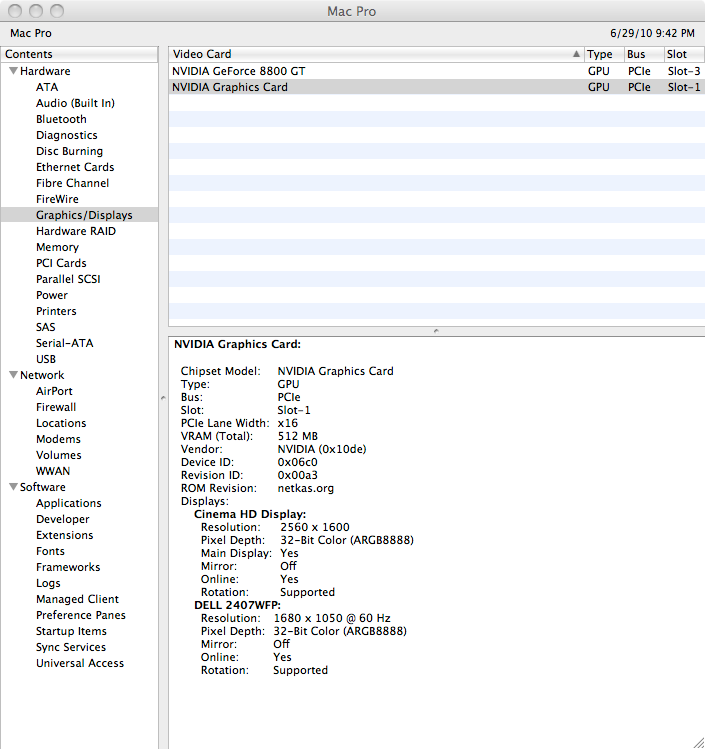

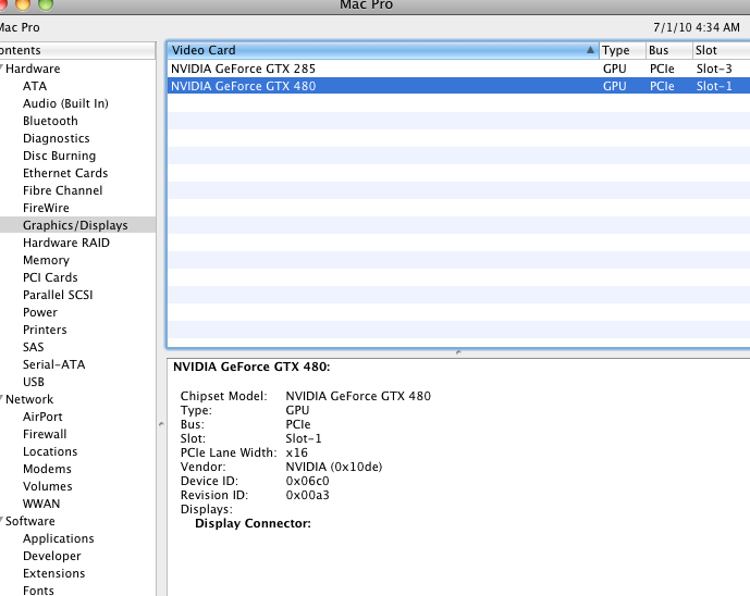

So, re-trying your newer ATY had a different result. It still did not function....but.....it DID make System Profiler see it properly as GTX480.

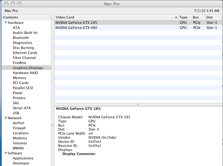

I put the OLD ATY_Init in and I can use the GTX285 as helper card for GTX480. As I posted before, there does NOT need to be an EFI card in slot 3, just an Nvidia card. So, a 1st Gen running a GTX285 AND a GTX480 at same time. If OpenCl ever works out, would be nice setup.
Ready to test whatever else. Before using GTX285, I tried 7300GT and 8800GT, same results.
Only difference in using EFI card in slot 3 is that ports work on EFI Helper card, while a PC BIOS helper card will not.
Screen shot with "Nvidia Graphic Card" was taken on Pro, others via Screen Sharing.

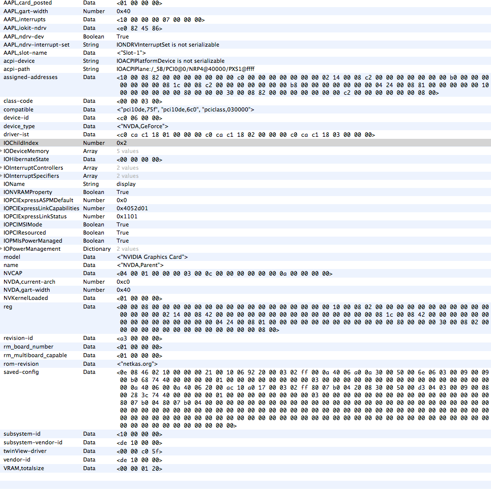

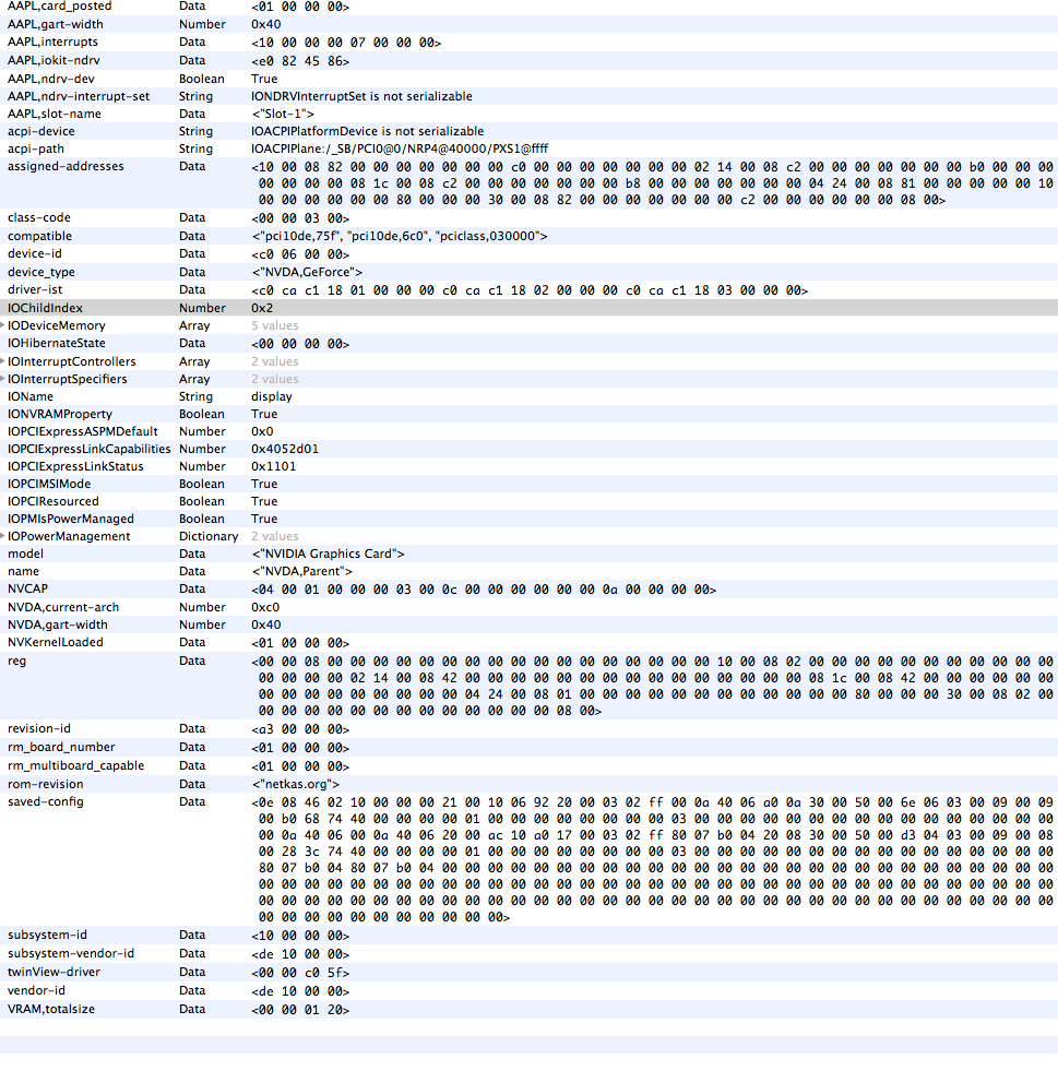

ioreg -l -w0 > dump.txt
with both aty_init kexts versions plz, so I can compare it
Certainly !!! And with a bonus, I saved the IORegistry Explorer reports. May be easier to read, though I suppose it's whatever you are used to.
I am attaching image of the IORegistry page for the GTX480 while running.
The things labeled "New ATY" are done from Screen Sharing on another Mac. The "Old ATY" are done with GTX285 in slot 3 and GTX480 in slot one. In that config, the ports on GTX480 work, the ones on GTX285 do NOT.
FInal set is of GTX480 with a 7300GT as EFI Nvidia card in slot 3. Those are labeled "w EFI". Ports on 7300 functional.
Let me know what else I can grab for you.
