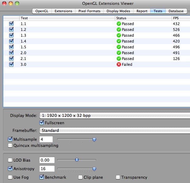

So I have managed to get to the next step and run the OpenGL Extensions viewer with the ACD 23 on the 480 as the primary monitor now (I switch after booting with the 285). As Rominator noted, the scores are not very good, but I think as a demo of early functionality it is very encouraging. OGLEV also sees the 1.5 memory OK and the same tests work as on the 285, albeit with much lower scores. My guess is Nvidia released these drivers before they were properly optimized, so I would not pay so much attention to the levels of the numbers as to the fact that the OpenGL stuff is working on a Pro now. No life from CUDA yet, though I am guessing the Mac release probably does not have the links yet - am looking around the libraries to see if there is a list of valid PCI IDs omitting the ones we want! If someone else gets CUDA or OpenCL up on this do tell!

Might just be a premature release of a first hack-up, with debug stuff in it.
