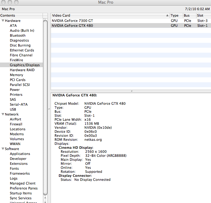

Success !!!
Have combined best features of both kexts !!!
Now the id is correct and it works !!!
Next on to fix the reported VRAM.
Explain to me again how 0020 works out to 512 Megs? I know you told me once but I have forgotten.

00 00 00 20 - its little endian, so we swap the order and get
20000000 - its 512 mb in hex
1536 will be i guess - 00 00 00 60

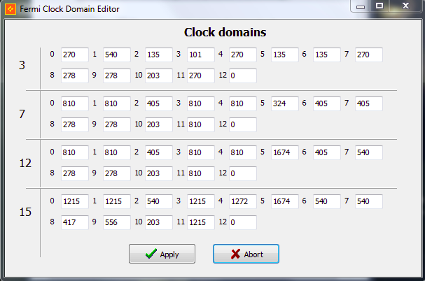

Decided to have a look at Nibitor's view of the GTX480 ROM.
Clock states are so much more complicated that they have to have a special FERMI page in Nibitor.
The 8800GT has 2 clock states on a Mac. The GTX285 has 2 or 3. I can't even figure out how many this actually is.
I was going to just put 3D values in for all settings to check my theory but I have no idea even how to do that.
So, quite likely that Mac OS doesn't know how yet either.

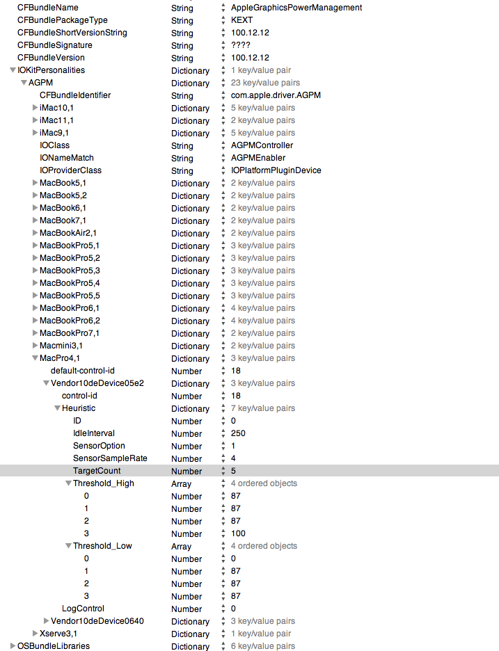

Anyhow...found a curious thin. There is an AGPM extension, Apple Graphics Power Management. Has entry only for Mac Pro 4,1 none of the earlier ones. Looks like 4 clock states for GTX285. Maybe 10thzMac is a 3,1?
Do we need to add for other Mac Pros?
Do we need to add GTX480 to tell it to get off it's butt and RUNNN !!!
Perhaps turn "Log Control" to 1 and see what it's logging and where?
Anyone have any ideas?

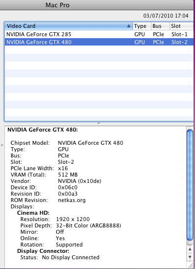

there is life
So in desperation I finally put my Mac ed 285 back in slot 1 and the 480 above it and now I have life! This is Mac Pro 3,1 (early 08), 10.6.4, latest Nvidia drivers with fermi kext, netkas ATY thingy. I also have video now, but the 480 is not yet recognized by CUDA (maybe I need to go hunt for new bits) and I have not yet been able to benchmark OpenGL. Proof in shot. I have not used the edit to display the card memory properly but I suspect this is just cosmetic.
Thanks guys! I will let you know if I get life from CUDA etc.
