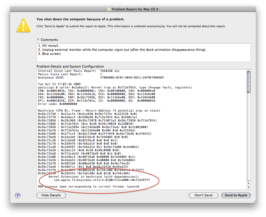

Good times.
I also have the impression that the native NTFS write is faster.
I think both are pretty fast. I was also able to get NTFS 3g / MacFUSE working. It just started working. Kind of like the Bootcamp HFS support. Right out of the blue.
I'm back with NTFS 3G and won't go back unless I have a really good reason.

sure, if you don't mind your mac crashing, the native ntfs driver is GREAT!
There's a reason apple deactivated the native ntfs driver in snow leopard before release- it ain't reliable!
use ntfs-3g or pay for the tuxera ntfs driver. ntfs3g is slow, free, and reliable. tuxera is fast, costs money, and is reliable.

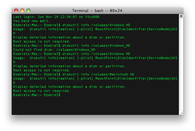

For this, you need to modify your /etc/fstab file to mount NTFS partitions for read and write.
First, uninstall NTFS-3G/Paragon if installed.
Open Terminal.app (/Applications/Utilities/Terminal)
Type "diskutil info /Volumes/volume_name" and copy the Volume UUID (bunch of numbers).
Backup /etc/fstab if you have it, shouldn't be there in a default install.
Type "sudo nano /etc/fstab".
Type in "UUID=paste_the_uuid_here none ntfs rw" or "LABEL=volume_name none ntfs rw" (if you don't have UUID for the disk).
Repeat for other NTFS partitions.
Save the file (ctrl-x then y) and restart your system.
After reboot, NTFS partitions should natively have read and write support. This works in both 32 and 64-bit kernels. Support is quite good and fast, it even recognizes file attributes such as hidden files.
once i enter the UUiD and went to exit now it asks for a "file name to write" and give the options of " ^C cancel ^T to files M-D DOS format M-M Mac format M-A append M-P prepend M-B backup file " please help I don't understand what to do..
No, this mod allows NTFS read/write access. But it is not stable which is most likely why Apple did not enable it.
S-
I can confirm you that this way IS NOT STABLE!!!
At the beginning you can read and write....delete, move, etc...
BUT
sometimes the disc appear on desktop also with the correct information (Free space) BUT.....no icons appear on it!!!
Itunes can read the music on NTFS disc but if you look in NTFS disc it appears empty and you have to:
RESTART
Start Windows and perform a SCANDISK because also MAC suggest you to do it (verbose mode) otherwise it can't mount it!
So 3 times on 5 this situation happens.
Do you think it is a real stable working method now???
I don't think so and I think that if NTFS-3G/PARAGON/etc are waiting to share a stable version for x64....MAYBE there is a reason...
So...you are advise....
I hope to be helpful.
PS: My specs: Snow Leopard 64bit 10.6.2 on hackintosh working GREAT!
Nifty trick, but is there a way to reverse this in case I wanted to revert back to default settings?
BUT
RESTART
Really sad, but it's true. It was such a simple way to make things work. I have to restart about 1 of 5 times. Right now I am trying NTFSmounter, till now it's OK.
