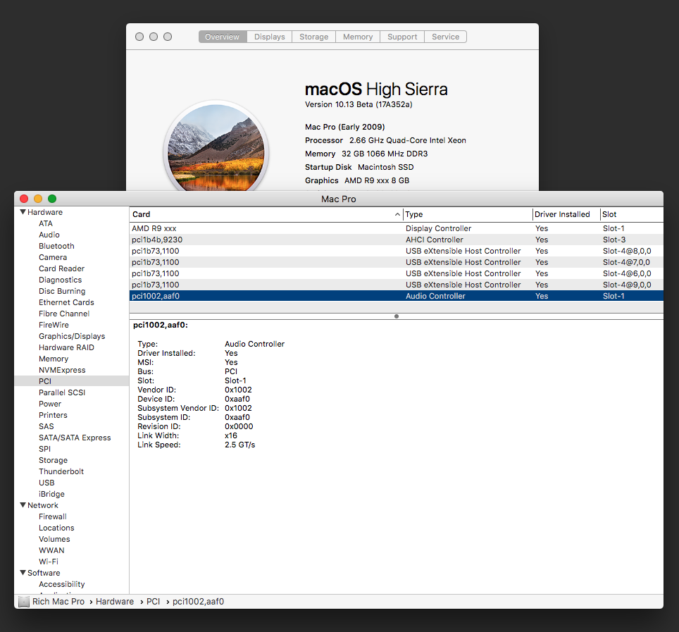

just installed this audio Kext in my cMP running High Sierra Beta 7 with a Sapphire RX480 card.
I have audio over DP an I can adjust volume using the Background music plugin from Github:
https://github.com/kyleneideck/BackgroundMusic
