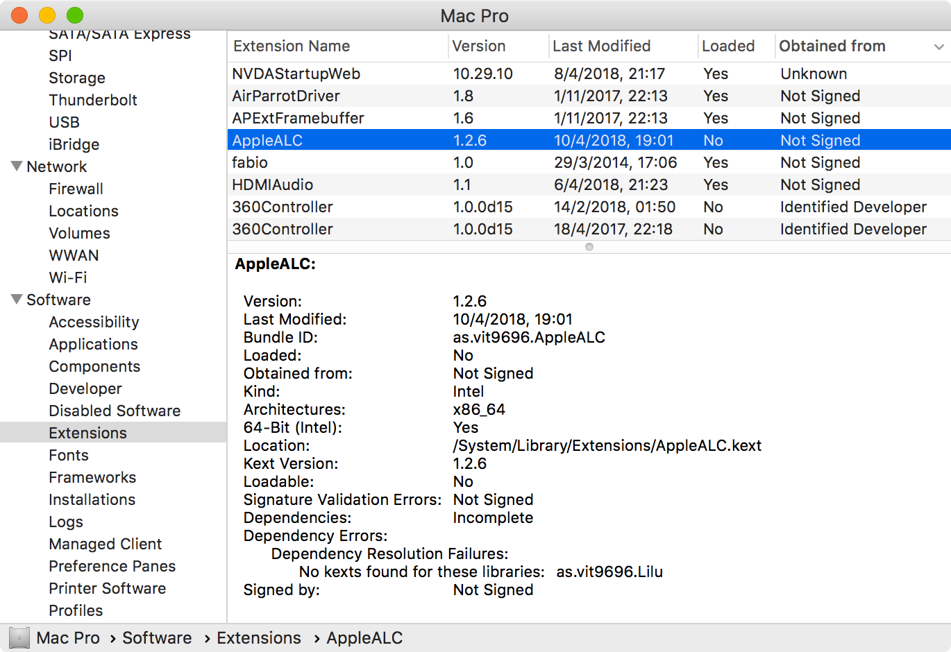

Recently with 10.13.4,one has to install latest version of AppleALC.kext which enables HDMI audio for Nvidia based cards. I use it and sound is back again.
Reactions: h9826790
Thanks, will try that with my 1080Ti on 10.13.4 and report back later.
May I know which version AppleALC.kext you use? 1.2.6?
Dependency error, need some time to figure out how to install it properly.
My understanding is that Lilu is required for AppleALC. In my case, even with Lilu, HDMIAudio would not work, so I just used the previous version of AppleHDA (see post 646).
