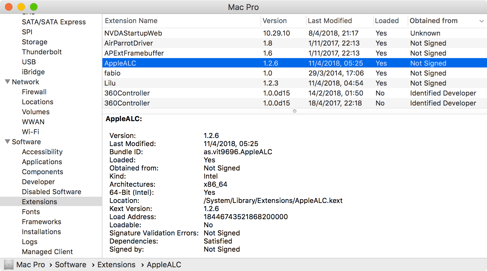

Use latest lilu.kext and AppleALC.kext by installing it in System/Library/Extensions.
This is a great solution (if I can get it to work). Could you confirm that you are on a cMP with an Nvidia graphics card? Are you also using NvidiaGraphicsFixup.kext?

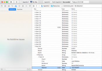

Note: The 10.13.4 AppleHDAController binary fix in AppleALC.kext supports one Nvida HDMI codec device_id, 0x0fbb. Any other device id requires an edit to the patch. Once edited, recompile AppleALC and install the new AppleALC.kext. Credit: FredWst

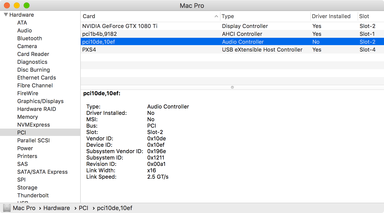

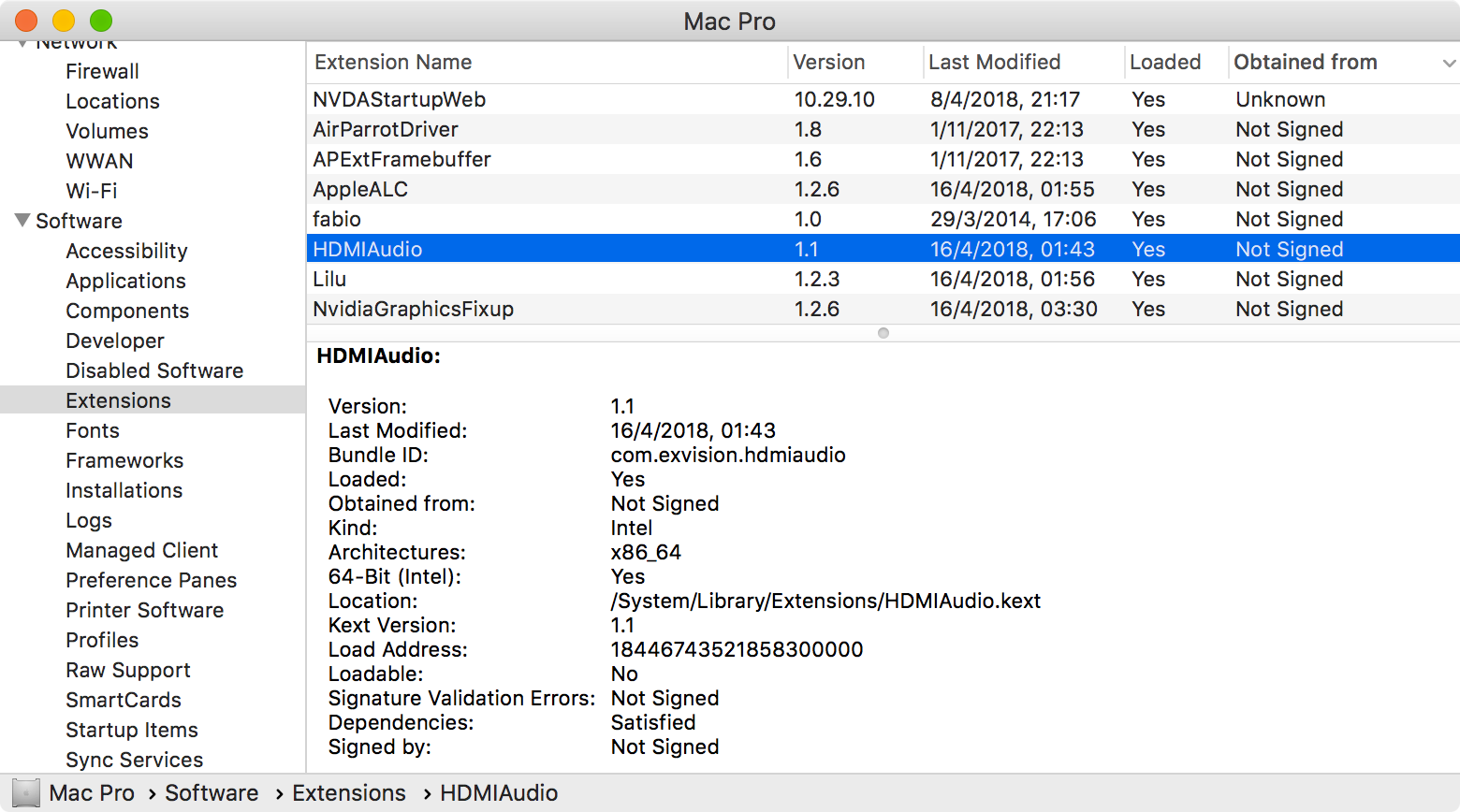

Both kexts were loaded and reported as loaded in Extensions. But no sound via HDMI, GTX 980...

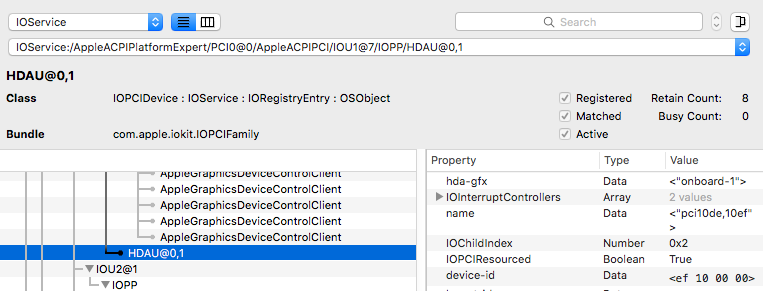

No HDAU, did you remove HDMIAudio.kext? If yes, restore.
Use Xcode/IORegistryExplorer
Reply with a copy of IOReg.
Thanks for your help.
Yes, that was removed.
And HDMIAudio.kext is now reinstalled. Nil help.

Anyway, here is the ioreg. Million thanks in advance!
here is the ioreg.

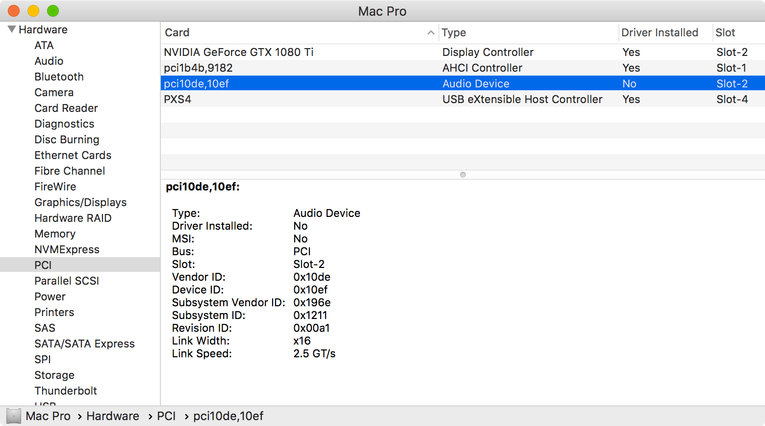

The process that enabled all Nvidia HDMI audio codecs has been disabled in 10.13.4 AppleHDAController.kext.
IOReg show the Nvidia HDMI codec is not recognized, no AppleHDAController.
1080 Ti/HDMI audio codec id is 10ef.
The simplest fix to patch the binary (hex editor):
Binary: AppleHDAController
Find: de 10 1a 0e
Replace: de 10 ef 10 (1x)
AppleALC.kext_v1.2.6 does not support 10ef, the next release will.
Attached is a preview of the next version supporting 10ef
