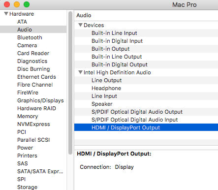

HDMI audio on my 7970 works in Mojave 10.14 with the older AppleHDA.kext, HDMIaudio1.1.kext and kextbeast. Yes, SIP must be disabled. Look back a page or two for the post. You must put kextbeast and the kext on the desktop for proper installation. Then reboot.
Hello everyone and a big thanks to the contributions in this thread.
Using Lilu, whatevergreen and apple alc.
I can confirm Audio working with Mojave and GTX 780.
No further Bootarg was needed and sip seems enabled after initial install of Kext and making sure everything was loaded.
Thanks to JP helping me along with the process.
Works like a charm! Just go to post #700 and presto. Don't forget to disable SIP!
I'll stick with the method I found and keep the Lilu process as a backup. The AppleHDA.kext pretty much doesn't change. The date is upgraded to go with the new operating system. I could have used the High Sierra HDA if I wanted.

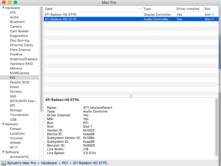

Hi everyone, Installed HDMIAudio 1,1 on my mac pro 1,1 running el capitan with a HD5770 from apple. Hardware PCI shows audio controller drivers installed but unable to see it in preferences. Am I missing something?
You may need to patch AppleHDAController.kext, and only a specific port on the card can provide HDMI audio.
Thanks for the answer! So, I keep the HDMIAudio installed and I add the appleHDAController.kext? Should I search for a specific appleHDAController kext?

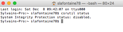

ok, I did try the applealc.kext with the lilu.kext but the result of this is I get no options in preferences and no sound output no matter where I plug he HDMI cable. I reinstalled El Capitan and back to square one... Anyone has an idea or a link for me?
With SIP disabled?
Okay, here's where I am right now. I removed HDMIAudio.kext. Installed lilu and appleALC.kext + WhateverGreen kext. Rebooted twice and now I don't have any audio devices. I included screen shots to show you guys:
