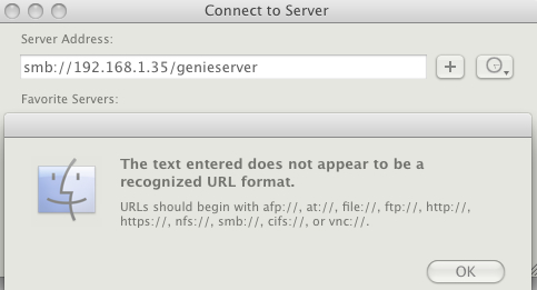

10.5.2 SMB not fixed
Have patiently waited for 10.5.2 so that I could access Windoze machines on my workgroup - SMB was supposed to be fixed - but it isn't.
When I do Finder - Go - Connect to server and enter the URL, smb://xxx.xxx.x.x/name, I get an error: 'The text entered does not appear to be a recognized URL format. URLs should begin with .... and of course smb:// is in the list.
Anyone have an idea? Thanks for any suggestion
Windows XP to Leopard 10.5.2
Im not an expert in networking. I have never had a problem with a Mac seeing a PC but like others have always had some issue in the reverse direction.
Leopard, as you know, changed certain preference dialogs.
Here is what I did to make it work for me.
On the MAC: System Preferences > Sharing > Check " File Sharing"
Then click on the Options button. Check "Share Files using SMB"
Click Done.
If you never knew the address of the MAC you can see it now where you see the message - Other users can access your computer.......
On the PC: Either in Start > Run or in an Explorer window type \\ folllowed by the address of the MAC
example: \\123.123.1.123
Thats it.
I never touched the Network Preference or entered anything in the WINS field.
Now I have no idea why, and don't really care until it stops working but I was able to access the Mac through the windows Network > Workgroup (not Office) where it was given an arbitrary name:
\\Mac0015f106d843

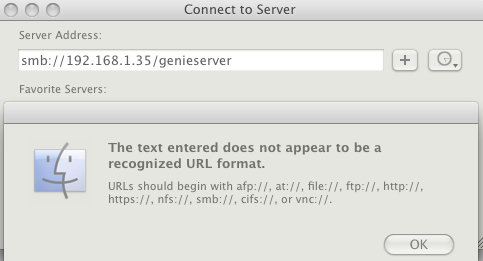

I had the "
The text entered does not appear to be a recognized URL format - but I have entered correctly SMB://IP address/volume." error as well. After countless hours of investigations, i figured out that the problem was a broken symlink in /System/Library/Filesystems. In fact the symlink tried to point to a ext2.fs module i once installed in order to access my linux formatted harddisk. It seems that the URLMount framework is not robust enough to handle broken filesystem modules and then denies to work at all. I simply needed to delete the broken symlink there and everything was fine again. I hope this helps.
