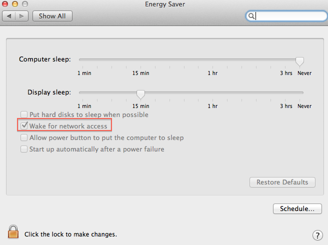

*There is one event that will cause the fan to spin out-of-control that so far requires you to run the script manually. That is "Wake for network access" which is found in System Preferences > Energy Saver.
I have found that when I put the Mac to sleep and then later use the Apple TV to access my iTunes library, which uses the Wake for network access protocol, the fan spins up to max. I haven't figured out a way to get the script to run upon this event yet, so what I've done is set my Mac to never sleep, but to put the display to sleep after 15 minutes.

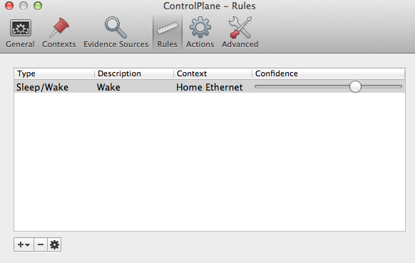

What about using Automator upon an event?
That would be great, but how do I do that? I'm not finding anything in there (yet) that works by events.
I think you could use the free app ControlPlane to launch your script. The app watches for "evidence sources" (list below), then performs a designated action based on the "evidence." Among the actions is run a script. It looks like it could be configured to do exactly what you want with your script.
Cool thanks! I'll give it a look a bit later today. 🙂
I gave this a whirl and I don't think it's going to work. I set it up with my script with the Rules for Sleep/Wake set to Wake. The Action parameter is my Shell Script on my Ethernet connection.
I put the computer to sleep and then walked over and turned on my Apple TV and accessed the iMac's iTunes library for a podcast to watch. After a few minutes I walked back to the iMac and I could hear the fan spinning up gradually and then I woke it up (fully) and saw the fan was at 3100RPM's and climbing. So I had to manually run my script to knock it back down.
I need some way of getting this script to run automatically when the system event for Wake for network access occurs.
