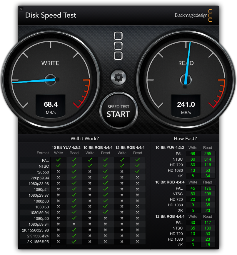

Would this also apply to running win8 under parallels? Before seeing your post i installed groths trim enabler about a month ago on my 2012 mini with diy FUSION samsung 840 250gb. I ran blackmagic when i installed sammy and was at around 250W and 500R. Now my my speed are consistenly low with a lot of variation between Blackmagic tests. could running groth trim enabler alongside windows default trim cause slow speeds or damage?
After seeing you post I have disabled Groths trim enabler under the assumption that windows was doing the trim by default. That evidently is not causing the slow speeds unless i need to give windows trim time to sort things out.
For what it's worth I corrupted something and couldn't connect to the internet/internet from windows/parallels and I had to have parallels support(which is excellent by the way)reinstall win8 and parallels due to my incompetence.
Any ideas on my slow blackmagic scores? I guess I'll try Chameleon?

Thanks for clarifying.Another question or 2. I press start on Blackmagic and speeds start really low like 40ish write and 180 read then gradually increase. ther is also a lot of variation within tests. Is this sow start and variation normal for speed tests?
Since i am running fusion, blackmagic does not list the sammy 840 as a target option so i am not entirely positive i am speed testing pure ssd. Could selecting "downloads" as the target ensure pure ssd speed test?
