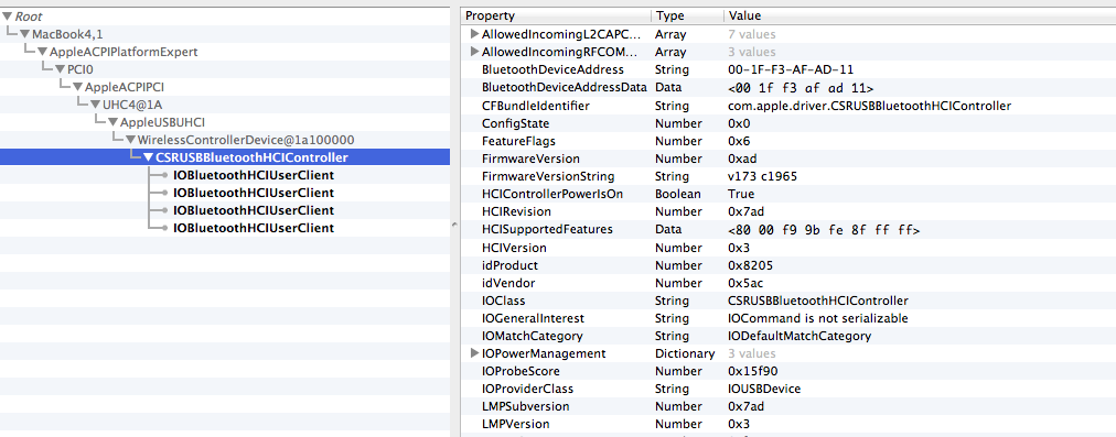

I went back to MPFC 1.something to install Mountain Lion, bluetooth is working however the system profiler can't tell what BT hardware it has, I think this is why facetime is not working, the calls fail, probably facetime checks mac address consinstency of the BT hardware. Infact in the same pc with Mavericks facetime works and BT is seen correctly but opengl is not supported.
I tried to use kexts from LION for blutooth but they don't load, probably I made some mistakes, I extracted them from the installer and looking inside they don't have codesignature...
Imessage works. This is the summary fror BT on system profiler:
"There was an error while gathering this information."
console:
4/15/18 11:50:27.000 AM kernel[0]: CSRUSBBluetoothHCIController::setupHardware super returned 0
4/15/18 12:09:18.235 PM system_profiler[355]: Exception while calling [SPBluetoothReporter updateDictionary:]
-[CSRHostController USBProductID]: unrecognized selector sent to instance 0x7ff142465ed0
ioRegistry:

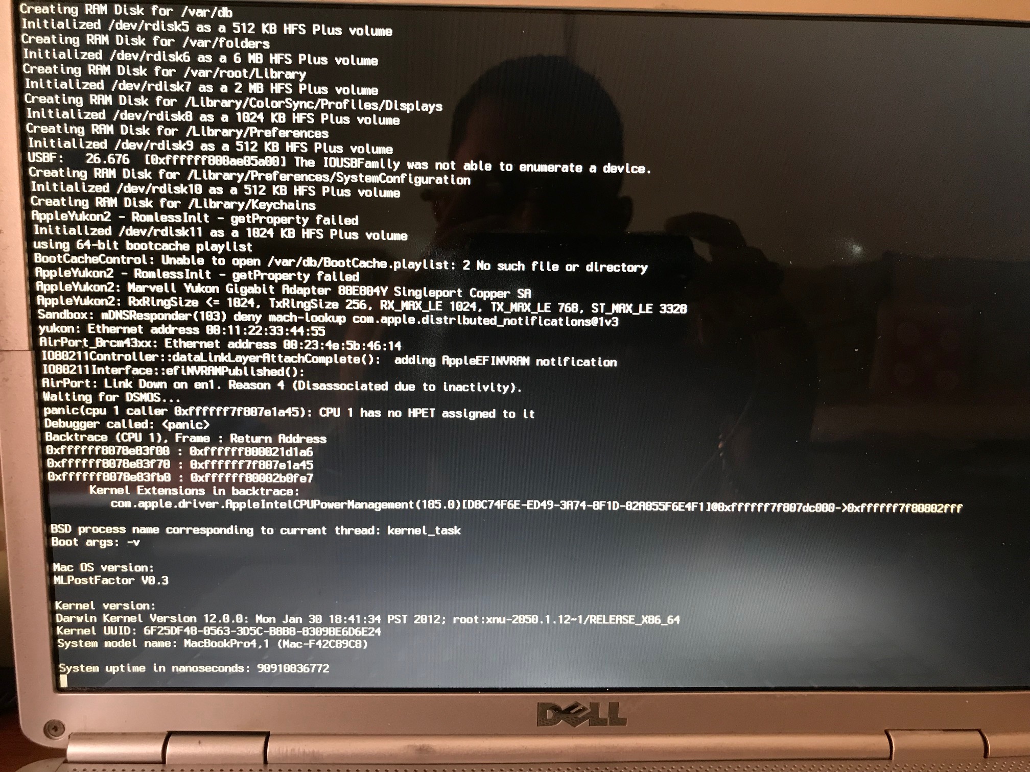

Made a installer partition on my Dell Inspiron 1525 which is currently running LION 10.7.3
Stuck at the below mentioned screen . Help !
Dell Inspiron 1525
4GB Ram / 500 GB HDD
Dell Inspiron 1525
Something went wrong with Apple's CPU Power Management kext (because you are try to run it on a hackintosh). Why are you try to install this? This is for real but outdated Macs, not for generic PC's.
