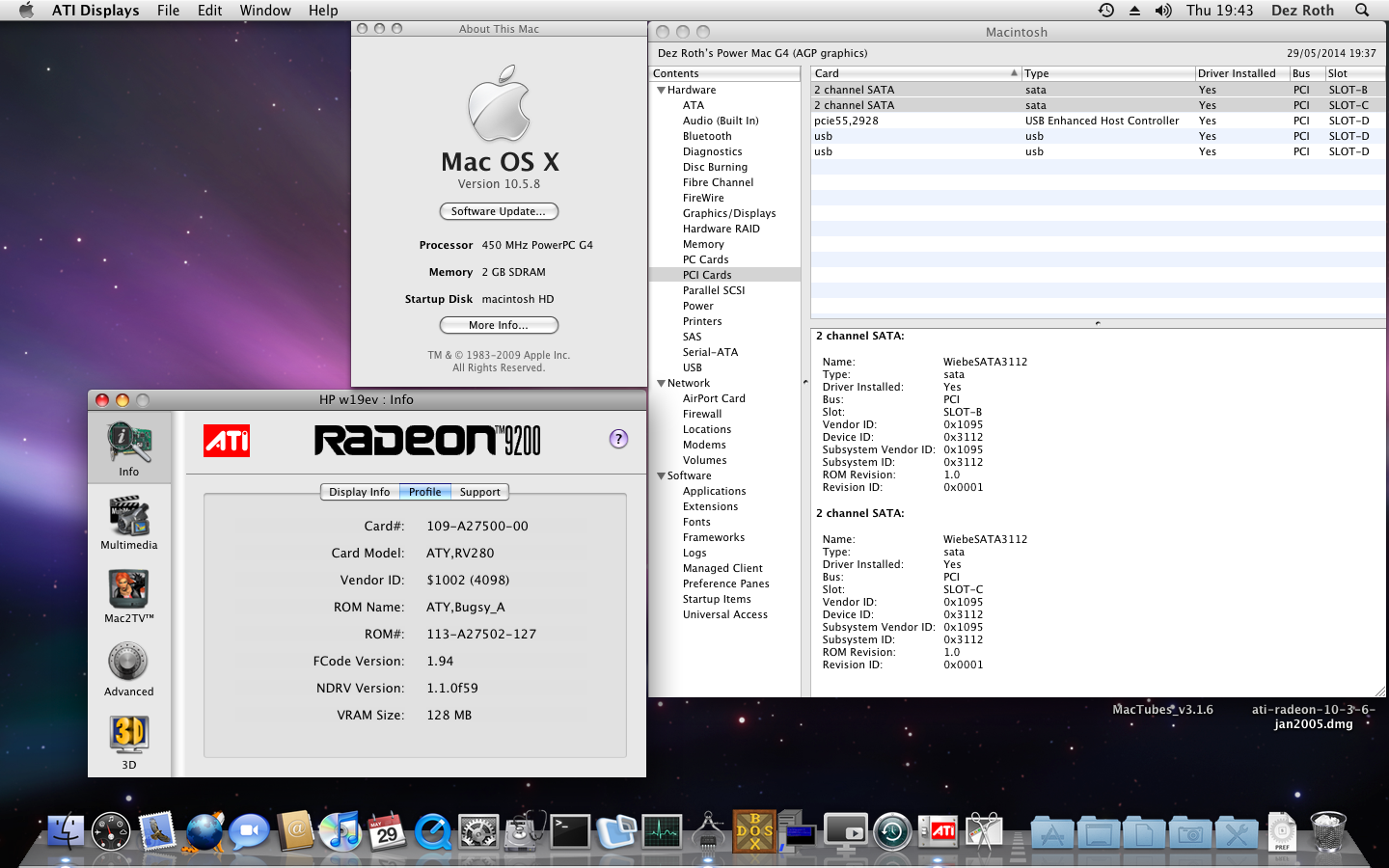

I can conferm that this works with my Power mac G4 AGP (rev 3 uni-north ASIC) I borght 2 SATA cards from the OP link and flashed em in a "PC" (if u wanna call a bare mobo on a desk a PC LOL) it went wonderfly and works a treat iv tested em in my PMG 4 with a DVD SATA burner and a 2TB WD green (witch oddly was seen as only 1.8TB hmm) Im just wating for some molex to sata adapters to arive to finelise my SATA setup in the Power mac G4 im upgrading it to the max i also have a 1.4Ghz CPU upgrade in the post witch i paid waaay to much for 😛 cant wate for that to arive 😀 . all i need now is a core image graphics card 😎 (eny one got a ATI radoin 9500-9800 pro? bar 9600 😛 ) I have a screen shot of my PMG 4 atached below
Hope u all like it 🙂
Glad it's all working for you! I used this guide to flash my own card. I've got two 1TB WD drives running on it. The reason your 2TB drive reports as 1.8TB is because of the difference in formulas for factoring MBs and GBs.
