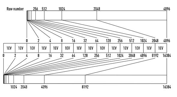

I was wondering about that 12bit number as well. On modern DSLR / mirrorless a typical RAW is 14bit, which roughly corresponds to the dynamic range capability of sensors in these camera. But if the iPhones can capture 2 shots or more at the exact same moment with different exposures then it means the resulting computational composite can be getting more than 12bit depth. (like bracketing 2 shots a few EV from each other at the same time and then end up with an HDR composite)
This diagram illustrates how you can effectively capture 2 more stops in the shadows with 14bit vs 12bit:

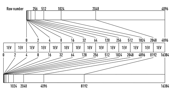

Your diagram and statement "you can effectively capture 2 more stops in the shadows with 14bit vs 12bit" are misleading.
RAW bit depth is nothing about captured Dynamic Range. DR is a characteristic of the sensor or scene (if we are talking about HDR). RAW is just a storage for that data. Think about bits and DR like about a stair: DR is a height of stair while bits are the number of steps in a stair.
In other words you can "pack" 20Ev in 12-16bit RAW file, but having 24bit RAW file for that purpose will be a much better as it will preserve all gradations for whopping 20Ev capable sensors.
That's why most mirorrless cameras have 14bit raw files while their sensors actually delivering only 12-13 stops of DR. Even most advanced medium format cameras like Hasselblad are delivering almost 14Ev of DR (according to different tests like DxO) while having 16bit RAW files.
Another example: shooting videos in Log gamma curve will allow you to preserve up to 12-13Ev while codecs like hevc will use only 10bits to store that DR. Some hollywood grade codecs like Apple ProRes are using up to 12bit while most cinema cameras are delivering 15+Ev of DR. Even more: some semipro cameras like Sony A7 III are using only 8bit codecs for same 12-13bit DR latitude (which is a nightmare for postproduction). Think about that.
Bits are about preserving details and gradations and is nothing about capturing more/less Ev.

Thanks for giving a clear explanation.
I am no optical engineer, just a semi-pro photographer who sometimes struggle to recovery shadows in actual landscape photography. It seems to reflect what I see while dealing with shadows: in a 14-bit RAW file (camera is Nikon D850, captures at base ISO 64), it is clear that I could recovery much more detail compared to shooting the same scene in a 12-bit RAW. This led me to believe it extended my DR in the darker end of the spectrum.
According to what you describe, my thinking above is false. And the fact that I could discern more details was due to the "higher number of steps" within that darker spectrum, such that when raised to a brighter range the smooth gradation and lack of noise is still preserved, I was just re-mapping the tones to a different, more visible number.
