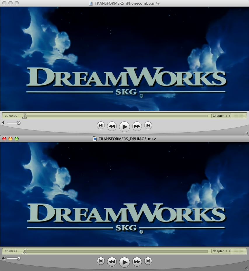

I encoded an :apple:TV preset and compared to iPhone 1500kbps with equal picture size. There is a noticeable drop in picture quality but it isn't terrible. Top is iPhone, bottom is :apple:TV.
The thing about movies is that they move, static pictures don't tell you that much other than the resolution. What is more interesting is how the picture changes during motion - does it go all blury? Or does it break up into blocks?
The iPod High preset is a good one to use on both as a starting point.
The iPhone one deliberately uses a lower bitrate because of the lower flash size.
