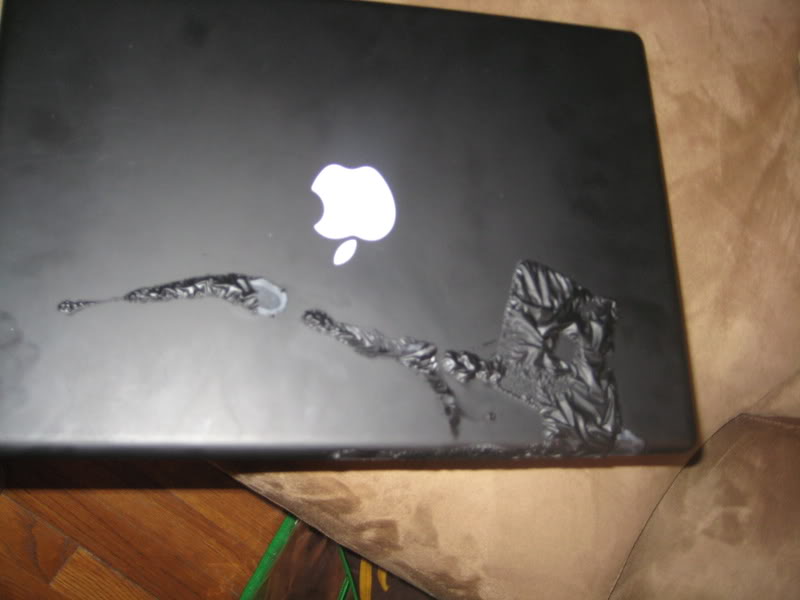

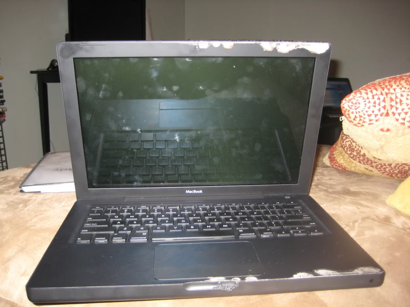

    I got my MacBook out of my desk this morning and the top of the book looks like it was melted. I had it plugged in over night and the power cord was laying on top of it. When I picked up the cord it was not hot...so not sure if that is what caused it. It is basically bubbled up in parts on the top, a little on the key board and a little on the bottom. Is this what it looks like when something spills on it? Just trying to figure out what the issue is and if it will be covered under the 3yr warranty or not. Thank you

    Pics of my Mac - Has this happened to anyone else?
    [​IMG]

    It looks like you left the magsafe brick on top of the case overnight judging by the prominent square where the bubbling appears to begin. Its common knowledge that any power adaptor can get hot. You should have left the brick placed in a well ventilated area, i.e. not on top of a soft plastic.
    AppleCare will not cover accidental damage or fix cosmetic issues.

    That is an Apple problem. No magsafe should be that hot to do that much damage. they owe you a new top case and palm rest and screen frame at the very least, a new MacBook at the best.

    This is accidental damage, these power bricks can and will get warm. Any and all power adapters get warm. Power adapters are engineered to dissipate heat, and the magsafe specifically will turn off if they get too hot ( which could explain why it yours was off and cold in the morning). They were designed to be used in a well ventilated area.
    Your extreme negligence regarding your poor treatment of the adapter and macbook is your fault. A hot adapter placed on top of the plastic macbook is clear recipe for disaster. Something that can get hot should never rest on top of a plastic macbook.
    Why is Apple responsible for misuse of products?
    "The power adapter may become very warm during normal use. Always put the power adapter directly into a power outlet or place it on the floor in a well-ventilated location. If you are using your MagSafe adapter in a poorly ventilated area, or if the MagSafe adapter is covered by a blanket or other form of insulation, it may turn itself off in order to prevent damage to the adapter." -Apple kbase article TS1713
    Be honest, tell them exactly what happened and hope they will go out of their way to help you. In my opinion, It's still your fault.

    Were you sharing the wall outlet with anything else at the time? For the extension cord itself to get that hot it looks like you have serious undervolt/brownout problems. This happens when your electrical source is unable to keep up with the consumption, causing the cord to get really hot. You're lucky it didn't catch fire if that was the case.

    that is crazy. I have the same macbook as you and I can say my magsafe adapter has never gotten that hot. Something else is not right no matter what people are saying. That is anything but normal. if it truly got that hot normally it would melt the plastic faceplate for everybody on the wall socket. Its not suppose to get that hot.
    it has to be a short. either a short in the extension you used or a spike in electricity

    Anyone defending Apple on this one is out of their mind. He's probably lucky he had it on his computer and not his carpet, lest his damn house burn down. It should NOT get that hot.
    Would also like to know how laying on top of the computer, in the open, doesn't constitute "well-ventilated". If this was slight warping I could understand, but look at it. It melted.
  22. kastenbrust macrumors 68030
