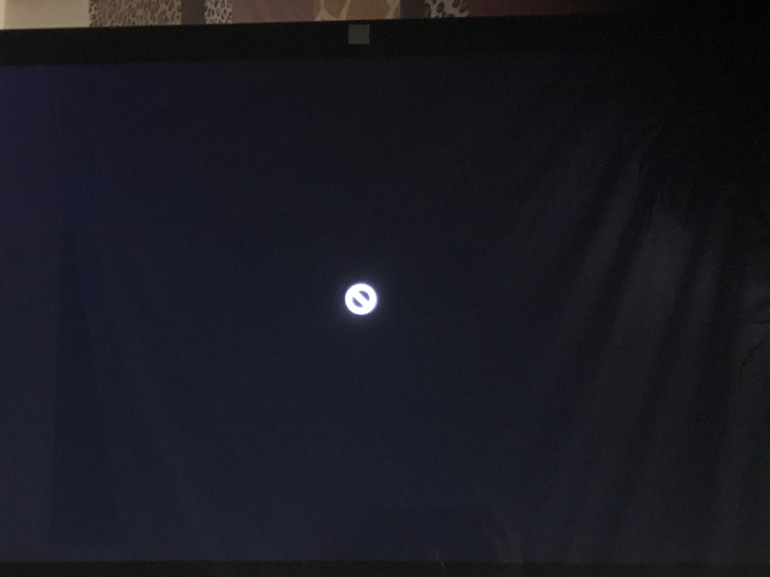

Hey,
Thanks for the reply. I really appreciate everyones input.
Unfortunately the Shift-Option-CMD-R doesn’t work, nor does just Option, or CMD R. I keep getting the same screen.
I am, however, using the standard Apple Bluetooth Keyboard that came with the iMac. So, maybe there aren’t any drivers for it to work??? I’ll try a wired keyboard asap.
Thanks again (to everyone) I’m completely lost without assistance from others.
I’ll also read as much as I can about this, I’m sure others have encountered something similar.

Would you believe me if I said that when I got High Sierra running I setup time machine in settings and without realizing deleted the Sierra backup. Yep, this is a nightmare (I lack some basic understanding of this stuff, I think that’s obvious. 🙁 )
I don’t have a clone either (but I will after this).
The only thing I have is a bootable USB Drive with Sierra 10.12.5 on it.
Also, as I wrote above I’m unable to access recovery (CMD-R at startup) as well as Shift-Option-CMD-R as well. And just holding down Option at startup to choose what drive to boot from doesn’t work either.
I’m using a Bluetooth keyboard, so I’m going to try a wired keyboard asap and try again.
If you have another mac and an appropriate thunderbolt cable to link them together, command-t at boot will put the system into "target disk mode", and you should be able to do whatever is necessary to restore the partition table on that drive.
As others have said, you probably have a drive which is half-way converted to apfs, and the old Sierra recovery disk utility probably cannot handle it.
A wired keyboard is probably more useful than bluetooth at this point also.
Ultimately, zeroing out the drive and doing a reinstall should bring you back. Zeroing out the drive might be a little bit of a challenge, but it's not impossible.
Also keep in mind, even if you can't get into the Recovery mode due to a busted partition on there (it's honestly surprising that Internet Recovery would fail) ... You can use recovery mode on another mac hooked up via Thunderbolt to repartition and reinstall as well ... just be very careful to work on the right drive and not to blow away the working OS 🙂
