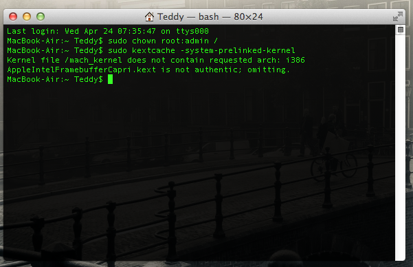

I changed to value to 40 at first, but when it didn't work, I tried to change it back to 20, but the system would behave the same regardless. Could you, please - in case you kept it - upload the original, unmodified version of that kext? Thanks.
The uploaded kext is unchanged 10.8.3 version...
It is strange... Idk what to say, lets wait for another person to try it with the Air before we can say that it doesn't work with it.
Maybe I found the solution. Rebuilding kext caches wasn't enough, because the system would still omit the new kext, even the stock one you've uploaded. So merely out of despair, I tried to repair permissions for the whole drive and now it works just as it should... with the original kext. I will try it with a modified kext sometime, but not now.
