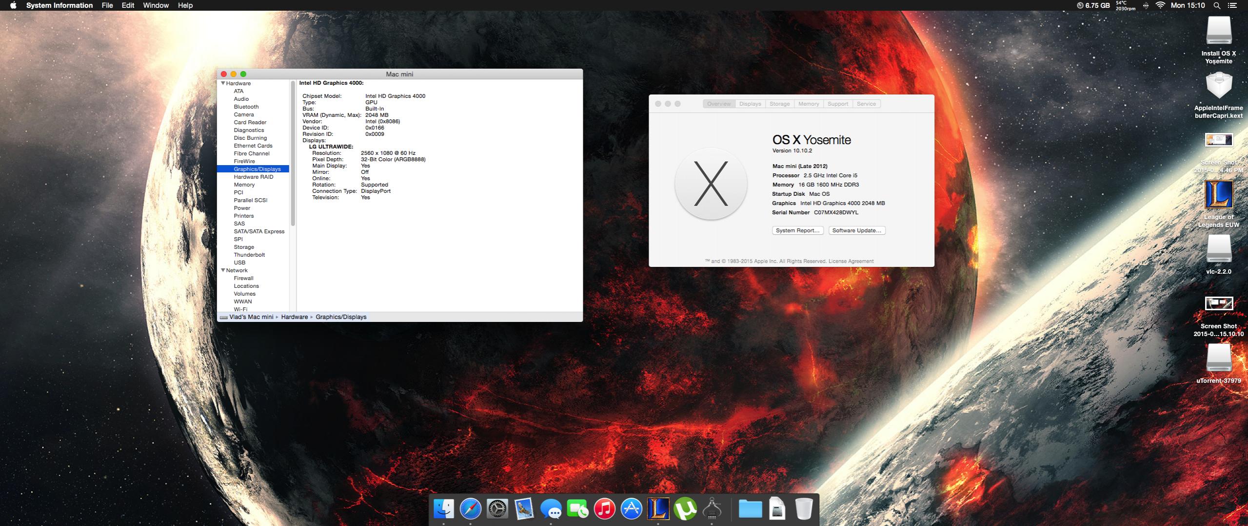

Scratch my above post. I've managed to get this hack working on a mac mini late 2012 (Yosemite 10.10.2).
After doing a clean install of the operating system the hack works with the instructions written by kpkp in the first post.
I will post below the screen shot.
For the record, I've tried upping the value of vram to 3gb, trying with C0 and 120, but didnt worked. No problem at booting, only displaying in system information :"display 7mb" and the computer was working very slowly (like I didnt had installed the graphics driver).
