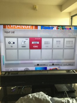

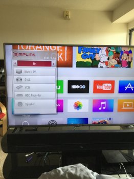

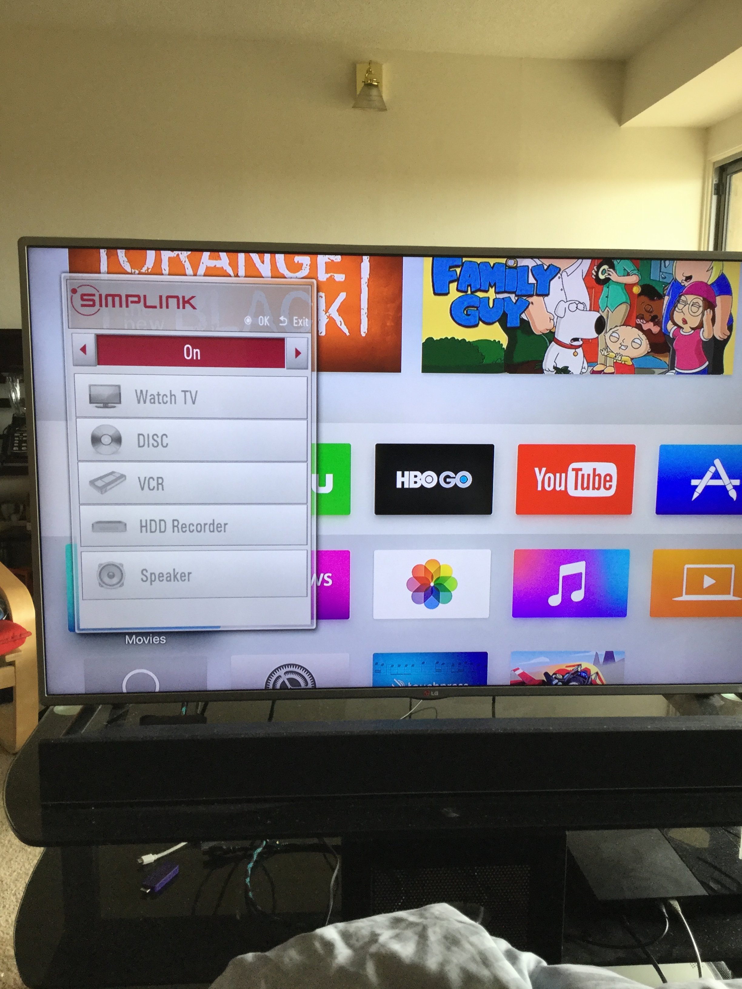

The following are what my input and simple link screens look like. That green simple link box doesn't show up anywhere
@carfreak12321 Your LG menu screens look exactly the same as mine, except mine has blue highlighting and yours has red highlighting. Either way, I did not check to see if the ATV was adjusting volume using CEC or IR in my setup. I surely would like it to use all the CEC features. When I get home, I'll check and maybe help troubleshoot.
