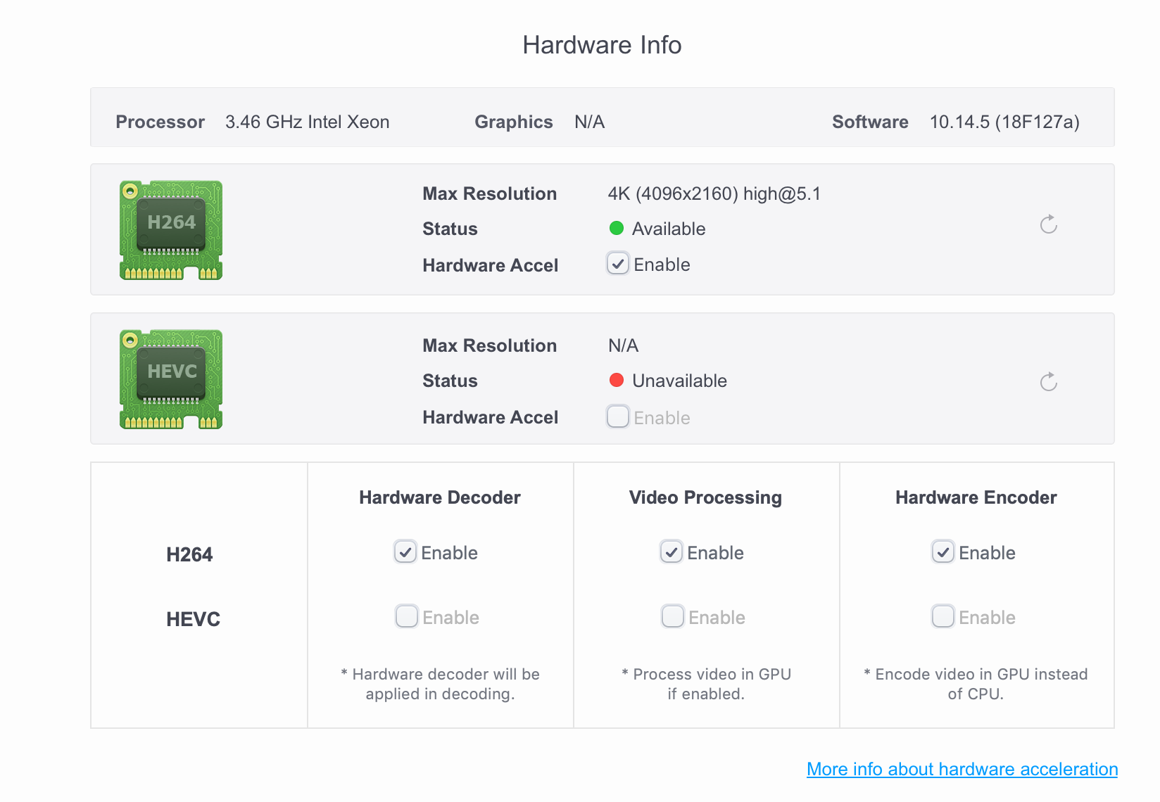

It shows nothing changed.
It's even more interesting that, I just remember that my AppleGVA.framework is modded. So, I resume the original one. (In other word, the OS itself is 100% vanilla now)
I've also changed "shikigva=32 shiki-id=Mac-7BA5B2D9E42DDD94" to "shikigva=60 shiki-id=Mac-7BA5B2D9E42DDD94" (I did this before I saw your post, will change it back and give it another try later)
And now I have H264 hardware accel.
Quick check shows HEVC hardware playback still there. And it's working perfectly in Finder and QuickTime Player (in 10.14.0, user must fully close the player and open it again in order to play another HEVC video smoothly, which isn't perfect).
H264 hardware playback also working perfectly in Finder and QuickTime player (I tested it with very high bitrate H264 file, and the CPU usage is extremely low, which I am confident that H264 hardware playback is working correctly).
In FCPX, both H264 and HEVC can be edited, no error, no crash / hang, but playback isn't that smooth (I switched OFF all background rendering and optimised / proxy media, so ,100% playing back from the original HEVC / H264).
However, here is the BIG news. H264 hardware encoding is working!!!
I use this setting to export a H264 video (30 seconds long).
The encoding is clearing doing by the GPU but not CPU. And I only need 40 seconds to export this video.
This is the outcome

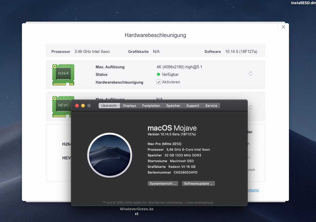

I can confirm this also works with Vega Cards.
Tested with RX Vega 64 and Radeon VII sadly those X5690 bottleneck in SingeCore Performance but I will not try it on my main rig until 10.14.5 is final.....
Also DRM Content Playback does NOT!! work (If you need that I don't use it)
Correct, I only get red screen and the sound when playing DRM content, no solution to get both hardware accel and DRM content playback at the same time yet.
