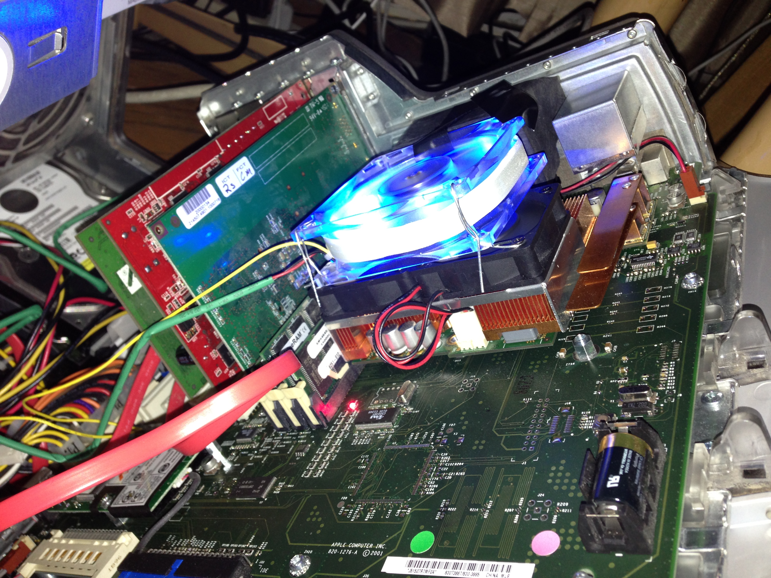

Today I dropped in at Radio Shack and got a 80mm fan for $13. Since it's smaller I've mounted it right on top of the heatsink/small fans on the processors. This after setting the processors back to 1.8Ghz (from 1.73).
Drive temps have again gone down and the Mac seems to be doing ok. We'll see what my stress test of encoding and burning an MP4 video does to her.

- Electrical tape is not a good item to use to secure a fan to a hot heatsink. It stretches as it heats up. 😱
- Screws provided with fan do no work in the screw holes of the two smaller fans and the screws for the smaller fans are too short to go through the holes of the new fan.
Solution: Take out two screws on one side of the heat sink and attach paperclips and tighten. Other end of paper clips are stretched out and go through the holes in the fan, then folded back to keep it retained tight against the other two fans.
So, now electrical tape is used on the other side merely to steady the fan, not retain it.
We'll see what happens now!

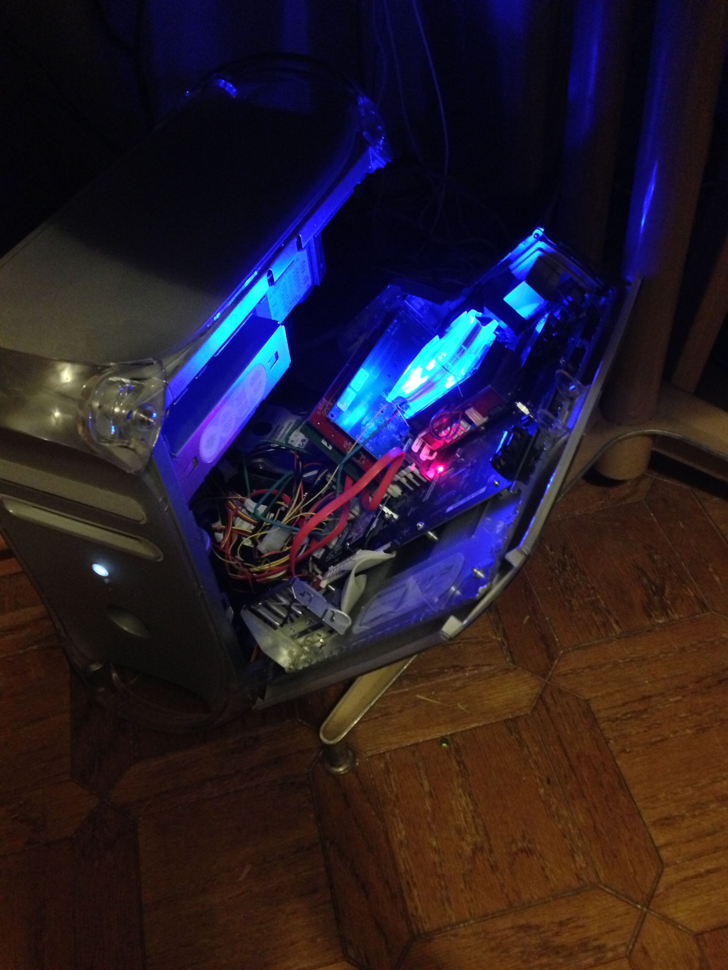

This has got to be down to heat. Letting her run with the door open and the drives cooled down. So far no issues. Got it cracked just a bit now. Wondering maybe part of the isue is that the new fan is so close to the PSU that it can't draw enough air when fully closed.
