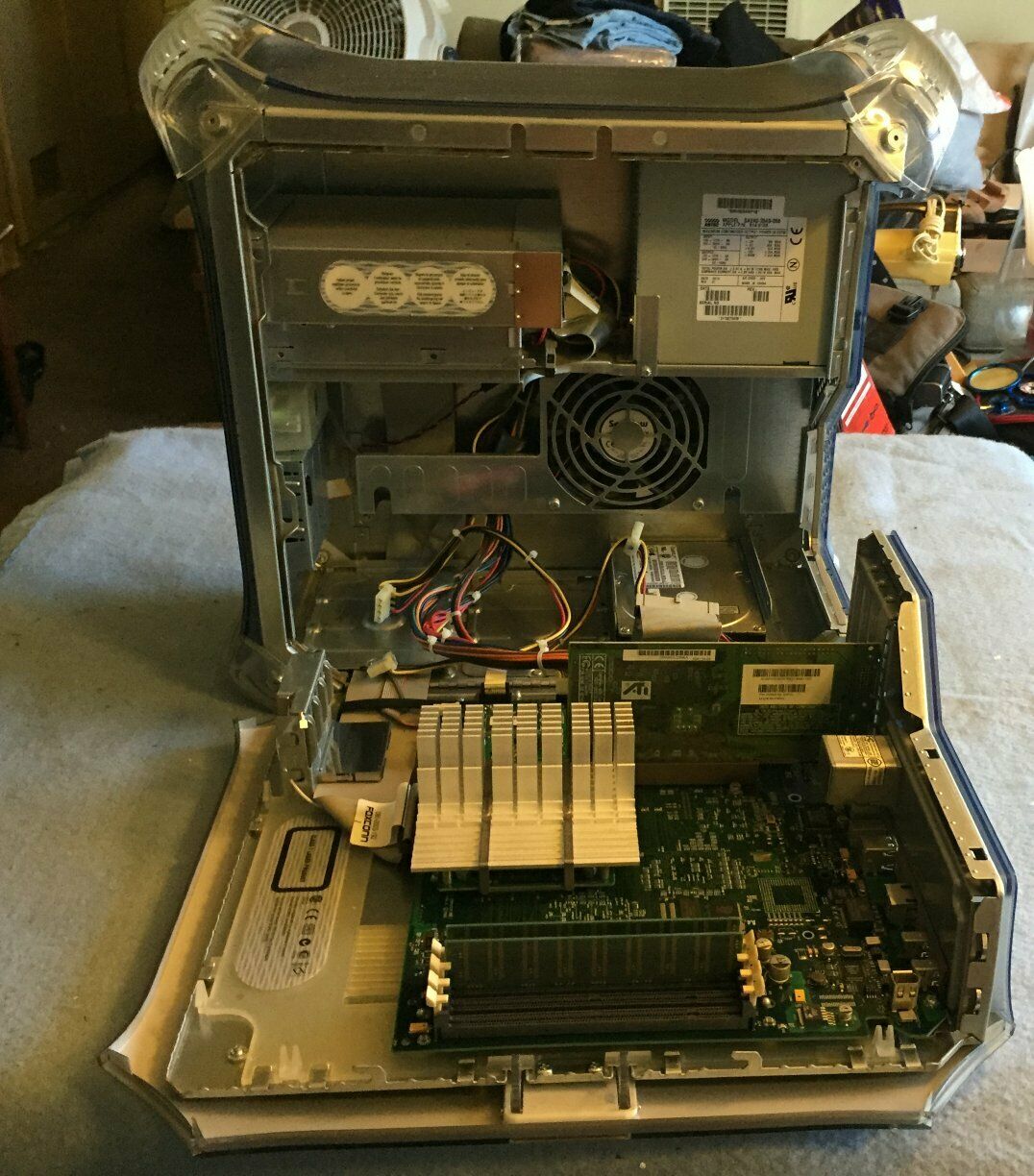

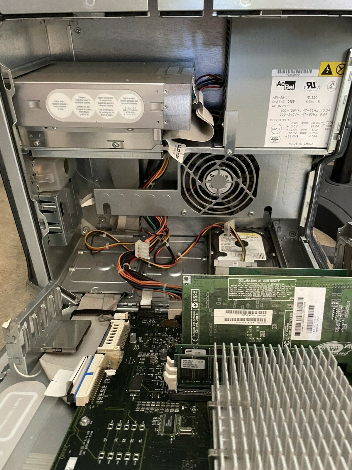

This seems like the most detailed thread related to G4 tower cooling so I thought I'd post here instead of making a new thread: I noticed that the early G4 towers have a 120mm fan that blows from outside the case and onto the PCI cards. Then later G4 towers also have a 120mm fan in roughly the same place, but it blows the other direction. Has anyone experimented with just flipping this fan to see what the effect is?
The main 120mm fan that takes hot air from the inside and pushes it outside the case is vital in its orientation. I am not sure I've ever seen one blowing air IN, rather than OUT - and I've had access to an early G4/350mhz as well as two other G4s (one that is mine) with the same case.
With the fan set to pump air IN there is nowhere for the hot air inside to go OUT. I'm sure you could pull one of the metal plates off the PCI slots, but that's a narrow gap. I imagine the Mac would overheat in short order.
Part of the cooling problem with the side fan of the G4 case is that hot air must make a 90º bend before being vented outside. This is what I meant by Apple putting form over function.
Reactions: Project Alice
I am not sure I've ever seen one blowing air IN...
So in these two pictures you can see the exhaust side of a 120mm fan above the hard drive. This is the fan I'm talking about. In the towers up through the Digital Audio that fan is installed as shown, but in the Quicksilver it's flipped.
