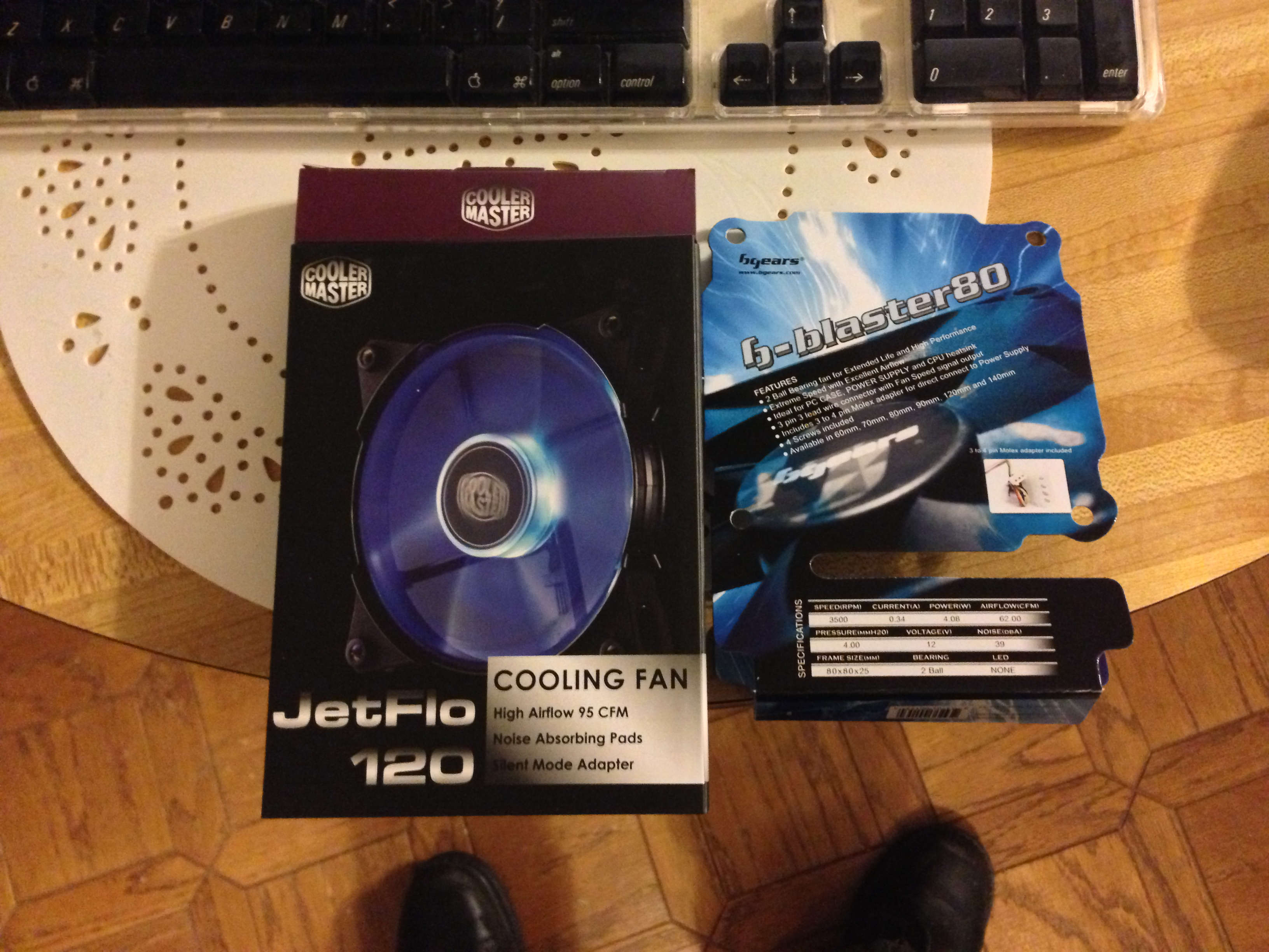

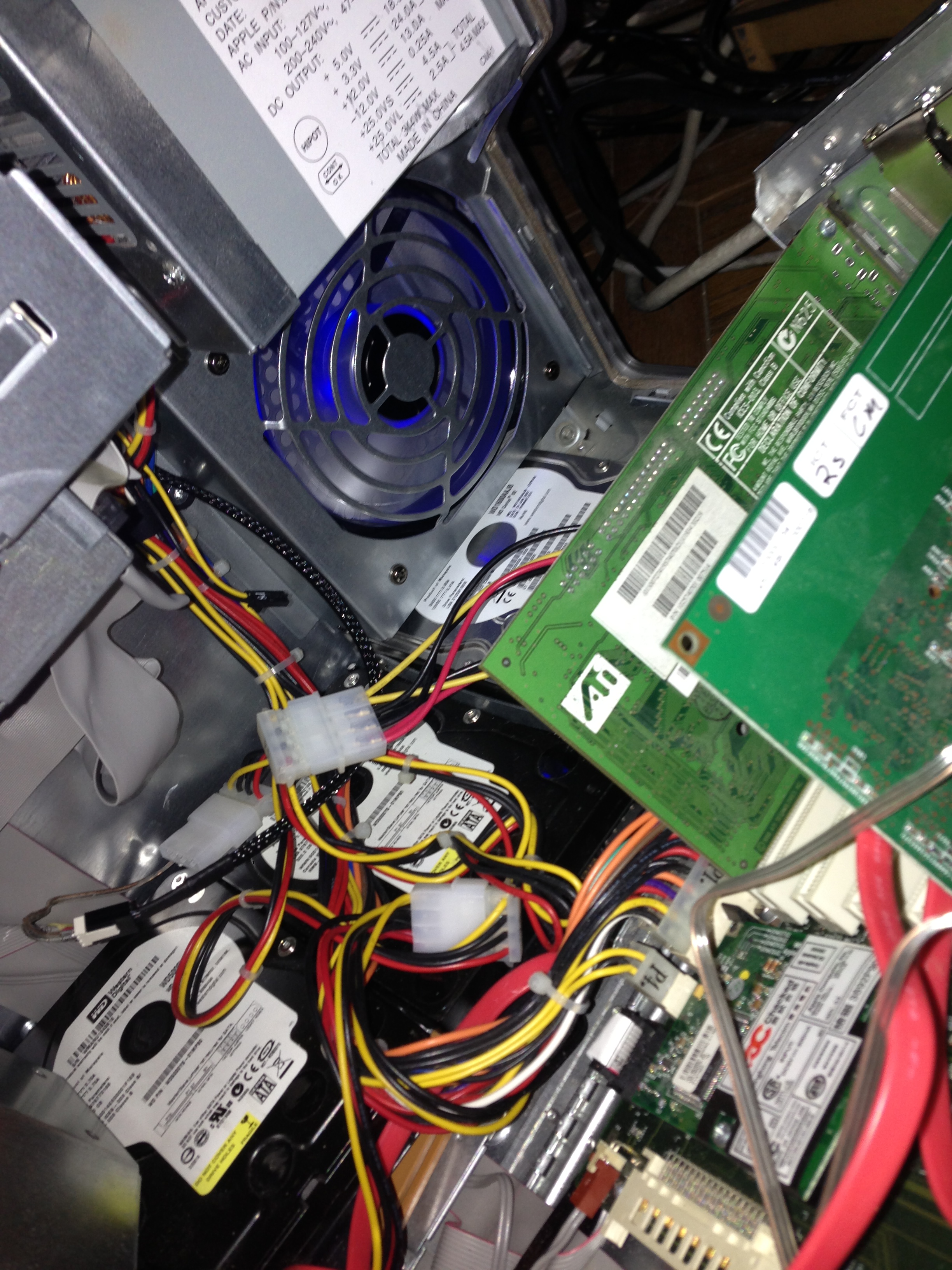

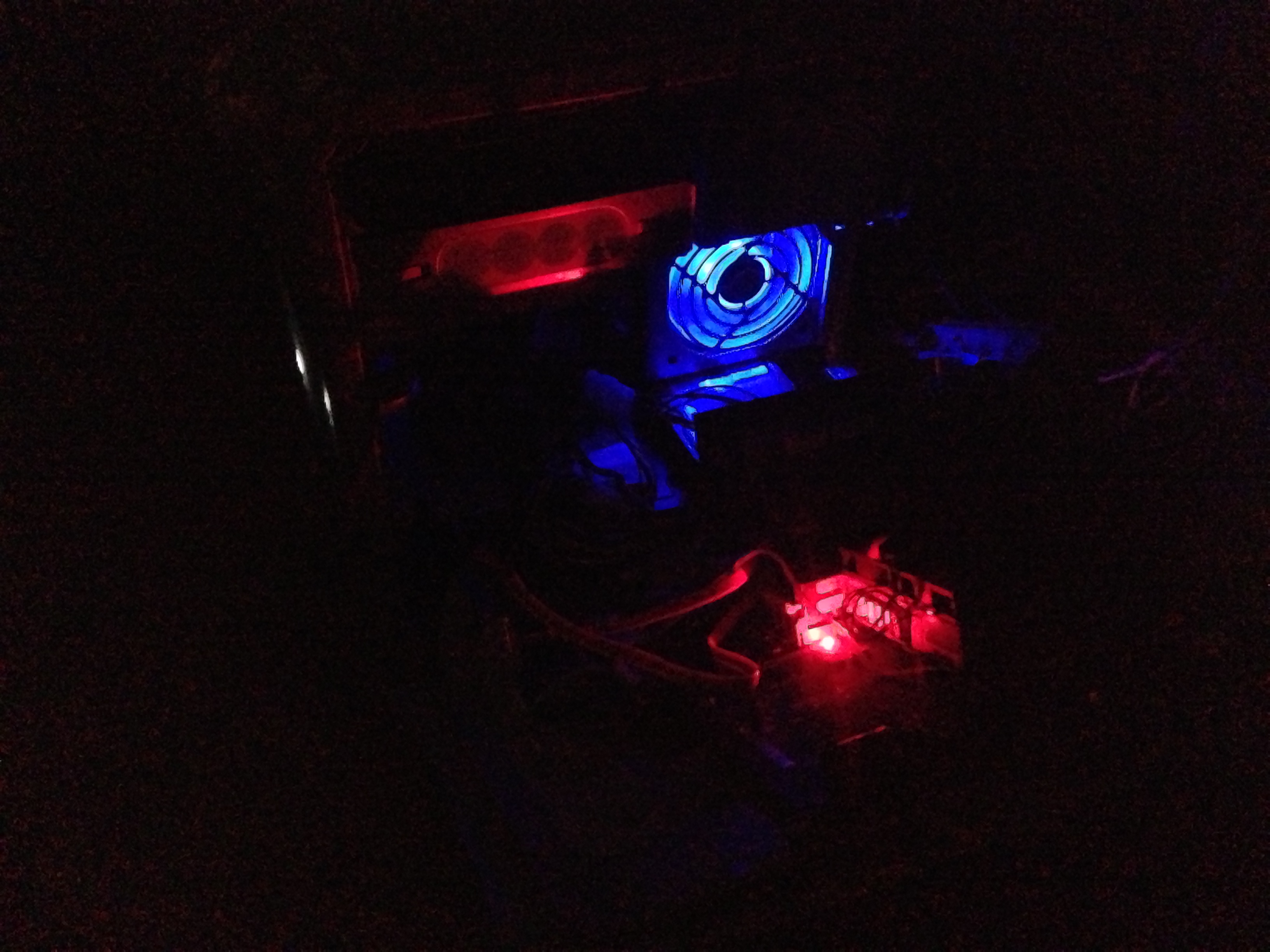

BTW, got the fans today. We'll see how this goes. The main PSU fan I replaced with a Cooler Master JetFlo 120mm. 2000RPM, 95CFM which is about 3x the cooling of the previous fan. I also got a 80mm fan that hits 3500RPM and 62CFM.
Right now my hard drives are about 93º. When I booted they were 86º. I also moved some of the PCI cards around. The video cards are going near the bottom by the PSU fan away from the CPUs. I can't move the AGP card of course, but I can move the others. The other two PCI cards are low profile and don't generate a lot of heat so I have them near the AGP card.

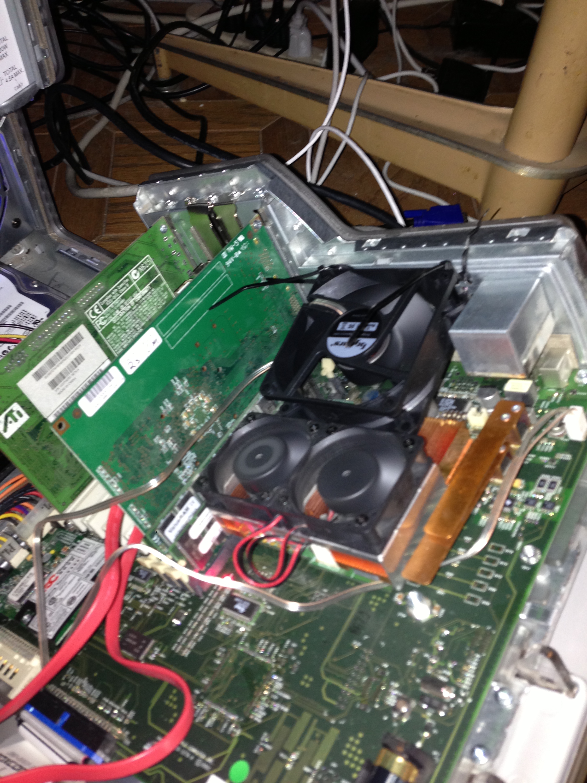

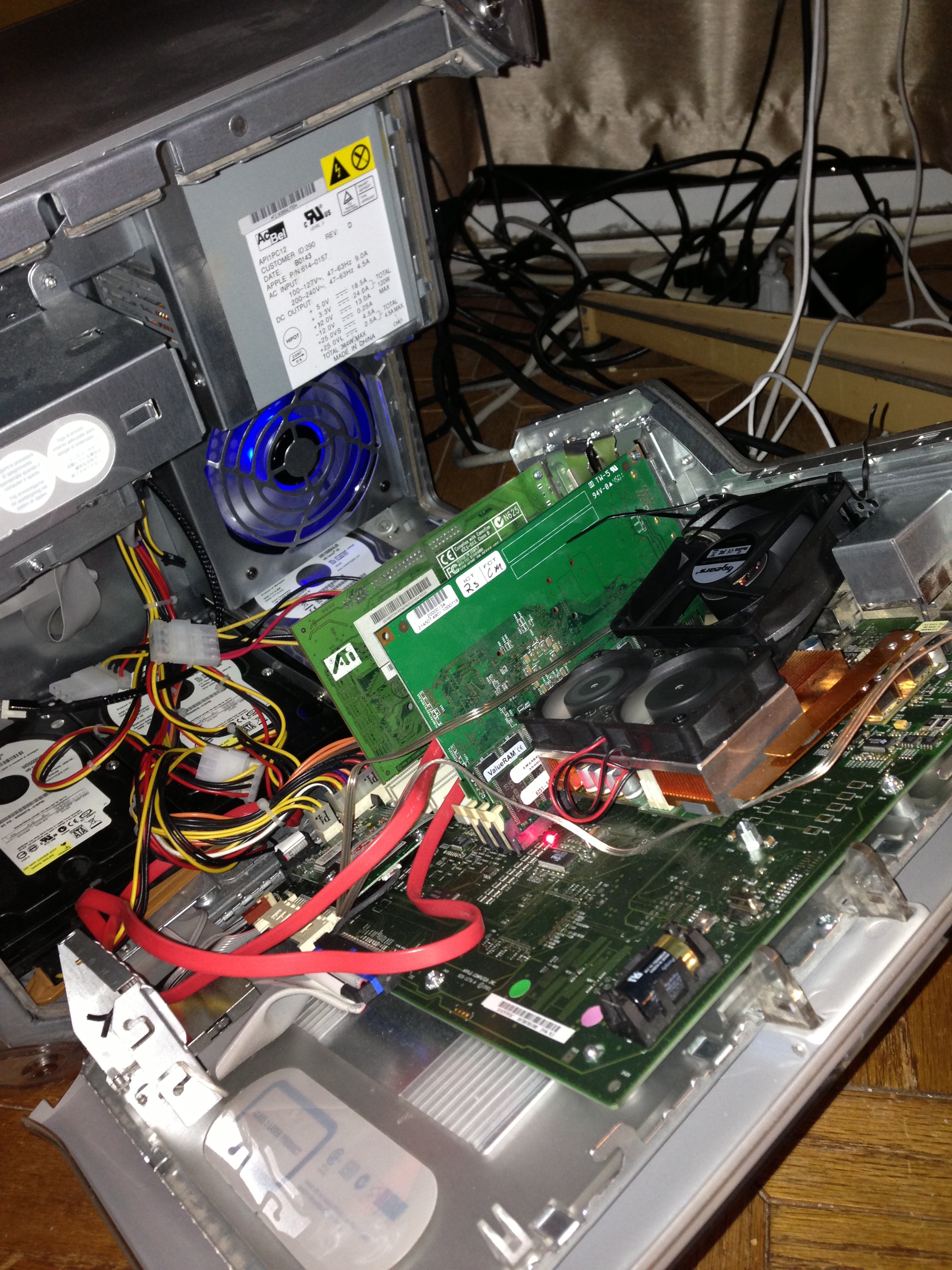

Since someone mentioned they wanted more pictures of the inside of my Mac…
Also, the fans I got today.

I'm really enjoying following your saga.....if you get many more fans in there that machine is going to start hovering over your desk 🙂
