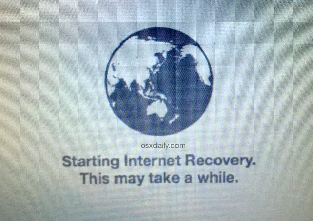

You will see a spinning globe (not the Apple icon). It will take some time to boot to that Internet Recovery.

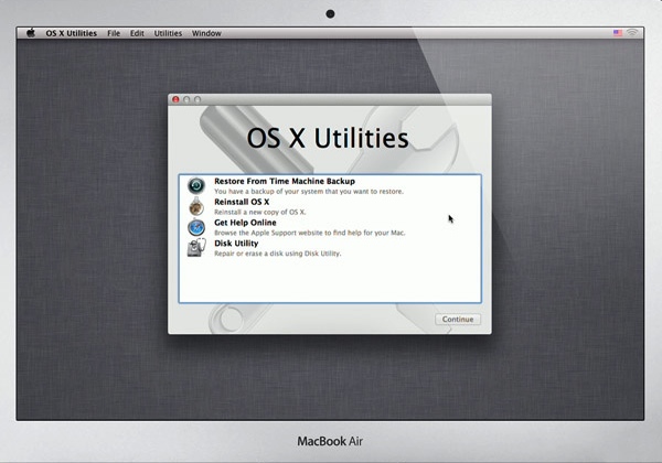

When you hold command-option-r (all three at once) then select wifi, do you then see a spinning globe while Internet recovery downloads. It should look like this.
Then you should see this recovery screen. Are you seeing that?
It is important you get the globe first and then the recovery screen, otherwise you are in regular recovery and not Internet recovery.
Sio if you can get to this screen, start Disk Utility and tell me what you see?

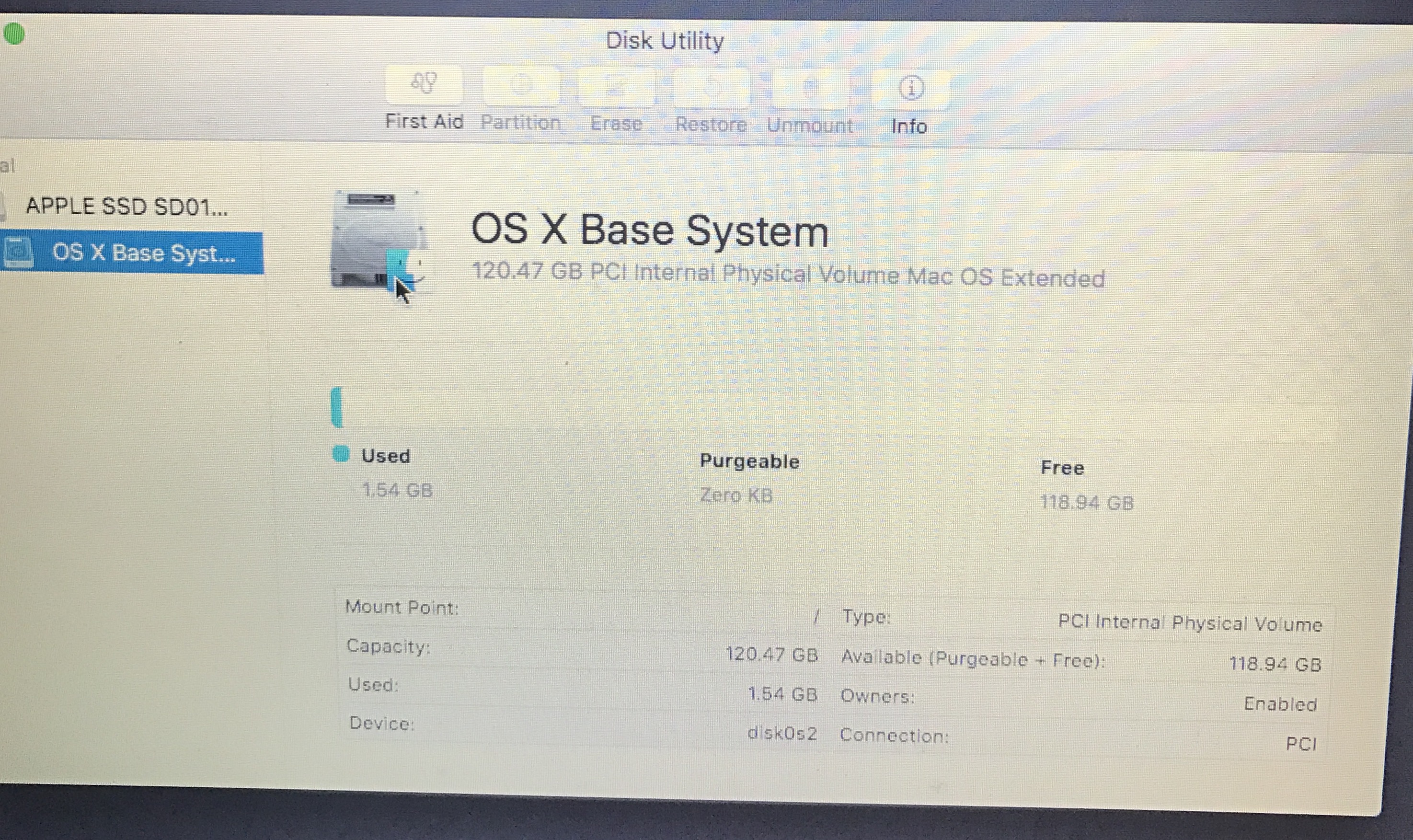

Hi there
It looks that i have the simular problem as the persons above.I have deleted my hd memory:p
Do you have any suggestions what should i do?

Can you tell us what lead up to this and exactly what you did?
That base system is a installer image, and you won't be able to do anything to that partition.
If you hold command-option-r at boot and pick your wifi you should see a spinning globe while the recovery utility downloads. Do you see that?
Then you should see the recovery screen. From there use Disk Utility to format the disk. Click the erase tab in Disk Utility then select the disk at the top of the left column. Then select Mac OS Extended (Journaled) in the dropdown to the right and apply that format. Then quit Disk Utility.
Now click install OS from the main recovery screen.
