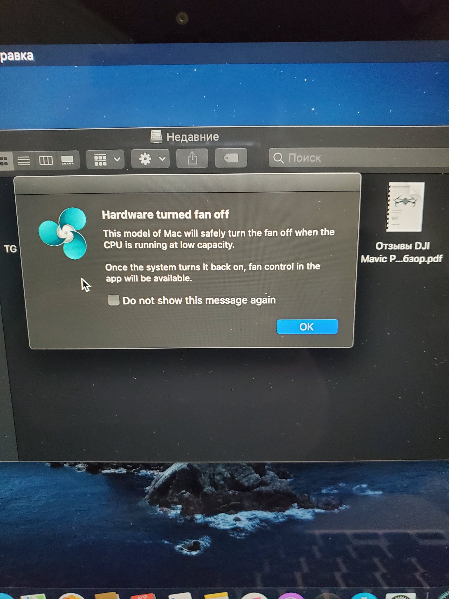

I use the tgpro program and when the fan turns off, the program says that it turned off its hardware, as there is no CPU load

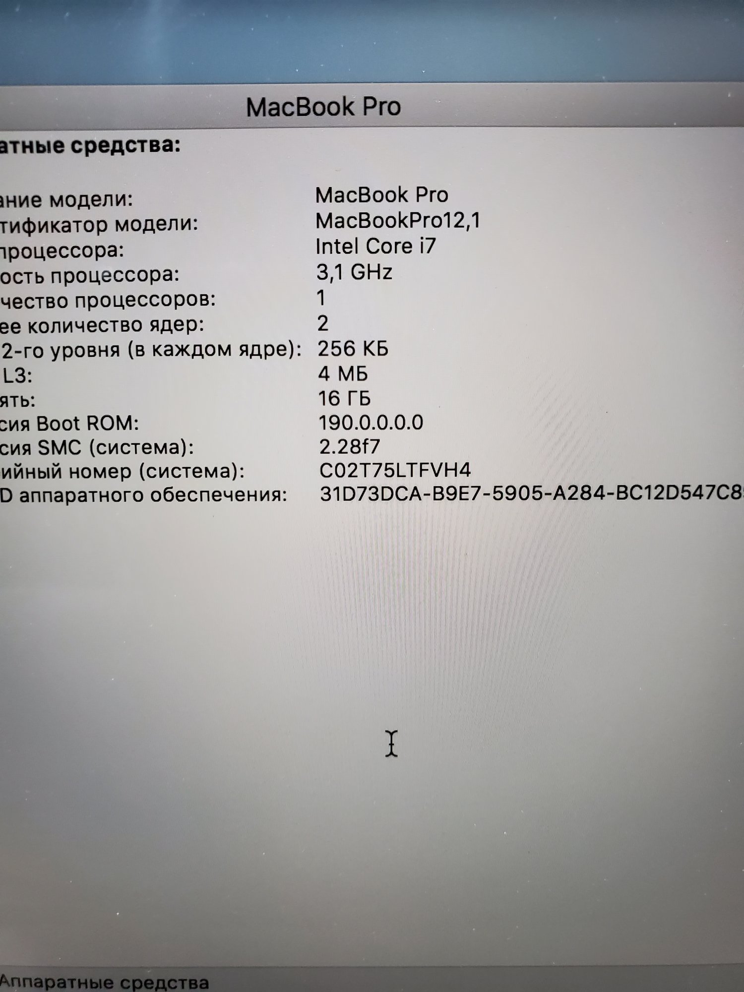

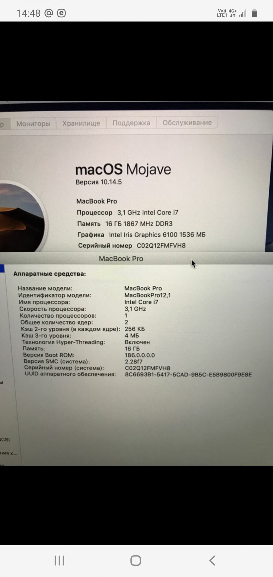

I have a 13" late 2013 and mid-2014 15" that both run the latest bootrom that was included with Catalina. Both are quite and run cool.
The latest Mojave has the same bootrom revision as Catalina.

it’s not a matter of silence at all))) it is quiet, I am concerned about the rpm 0
mojave and catalina have the same smc and the difference rom

The latest Mojave security update gave my MacBook mid-2014 15" bootrom 159.0.0.0. It's the same one that installs with Catalina.
because mid 14
This message from the TGPro program is telling you that the fan stopping is normal and safe behavior. I have a 2018 13" MacBook Pro which definitely turns off the fans when the computer is running at low load.

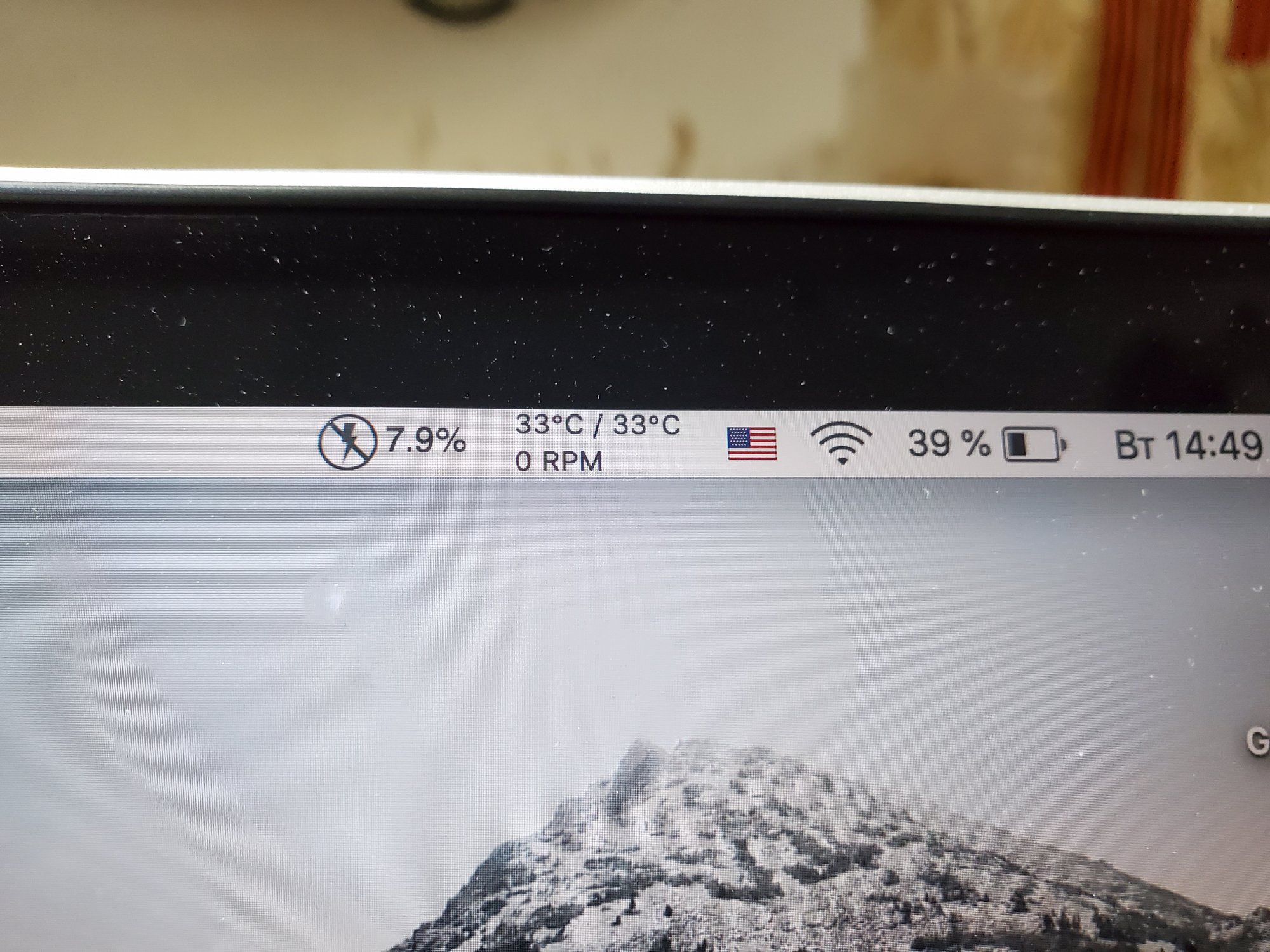

@Drim First of all, you need to climb out of that "Apple is ruining my MacBook on purpose so I have to buy a new one" rabbit hole. You've been in there for too long, and it has already affected your common sense. Neither Apple nor Dell nor Acer nor any other company are actively destroying their own products in order to force people to buy new hardware. Period.
Second, I don't think this is abnormal or unusual behavior. Unlike the 15" MacBook Pro, the 13" MacBook Pro has always shut the fan off when temperatures were below a certain threshold. That's not a secret (in fact I would dare say it should be common knowledge by now), and I'm honestly surprised nobody other than @chrfr caught onto that yet. That said the fan should turn on once your temperatures reach a certain limit. That message above simply states the fact that the fan is off, which is expected behavior in 13" MacBook Pros.
If you want to manually adjust your fan's behavior you can try using Macs Fan Control, which should allow you to override Apple's firmware fan and temperature curves and run the fan to your liking.
