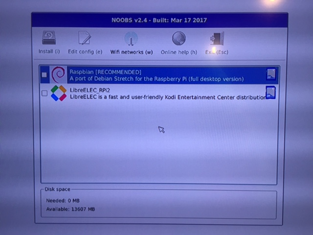

The replacement card arrived and seems to be working fine. On my Pi 3 I do actually have a green light and it flickered on and all seems to be well. Good to know it wasn't me being stupid 😀
So now, going by the screen below, do I check both Raspbian and Libreelec and Install?
And then follow your instructions above? There is also a Wifi box, which I'm assuming I can select my wifi network from. Should I do that? Or follow your instructions for wifi SSH?

Go ahead and install Raspbian from there. You don't need the Kodi stuff there. Once you get Raspian installed enable SSH. You don't need to setup the wifi if you plan to keep it on ethernet.

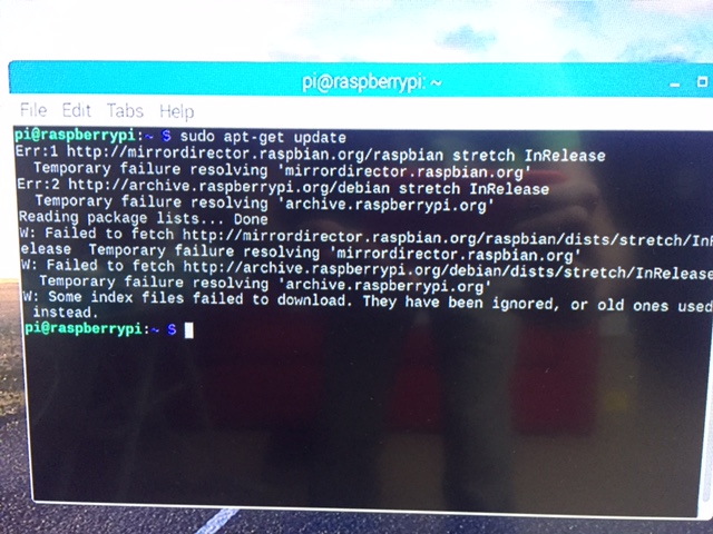

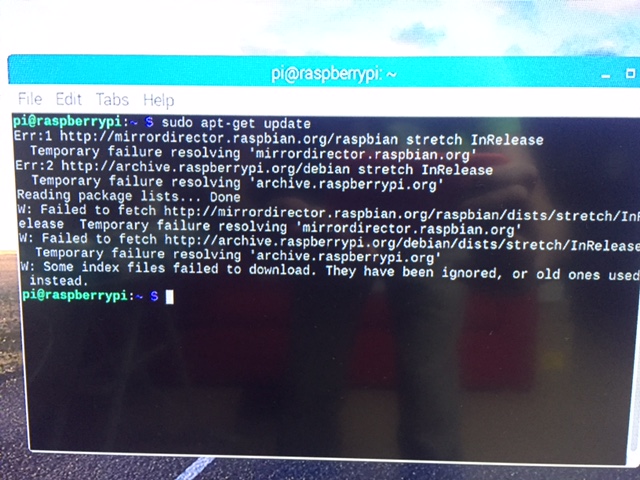

Yup. I have also just gone and reconnected the Pi to the TV, went in and entered 'sudo apt-get update' and got the following. My head hurts now (along with a recent bout of sciatica), so think I'm going to call this a night for this. I'd hate to think how much your head hurts with all my questions and woes!!! 🙄

I'm really a little baffled why those update commands won't work. Does the Pi access the Internet okay? Can you ping yahoo.com or something just to test?
When I connected the Pi direct to TV I can't access the internet. But then I can't connect the ethernet as the router is no where near the TV.
Before I initially installed the Pi software, there was a wifi option when I connected it to the TV. But I didn't go in to it and installed the software first.
Is there a way of reinstalling the Pi software without deleting it from the SD card?
Ah... that is what is wrong then. You need to be on the Internet to get this setup.
Connect it to the TV and get SSH enabled, then disconnect and get it back on ethernet to the router. Then from the Mac login using Terminal over SSH like we discussed earlier. Then you should be able to do everything.

I believe that is because you are not on the Internet. You could enable wifi and get on that way.

It won't show up with a ping yet because it is not on the network.
Run "sudo raspi-config" to get the options menu then pick the network options and setup your wifi there.
