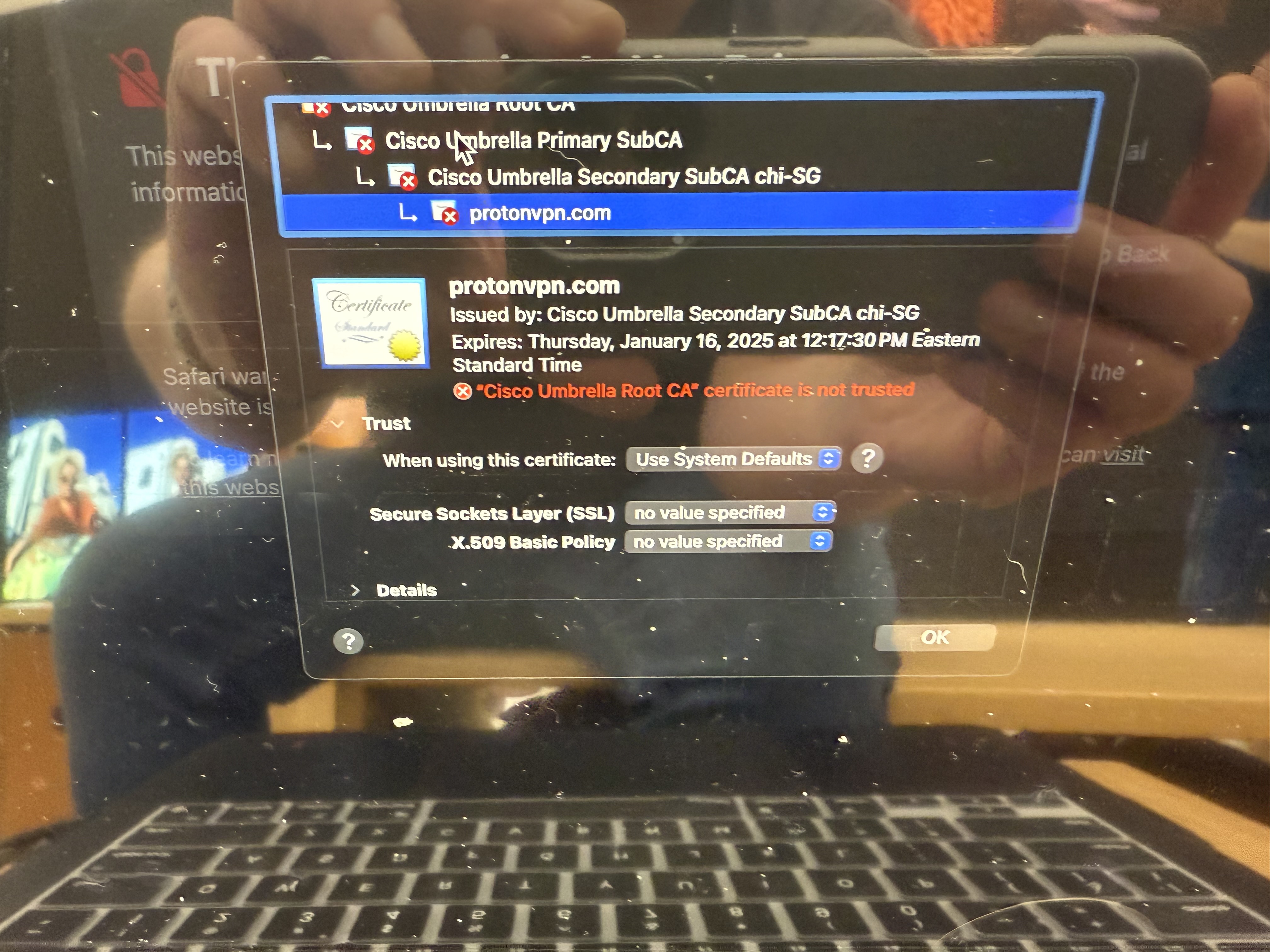

I am having what I believe to be a malware issue that is persisting between Configurator restores. I've tried to explain to the Apple Store and to support on the phone but I'm not getting anywhere. I come from a Linux background but I am new to MacOS and I fear I know just enough to see that there is a problem without being able to properly articulate what the issue is. I was recently hacked in a pretty bad way that took down my personal network of about 10 nodes and I'm trying to recover from it but I can't seem to get the MacBooks cleaned no matter what I do.

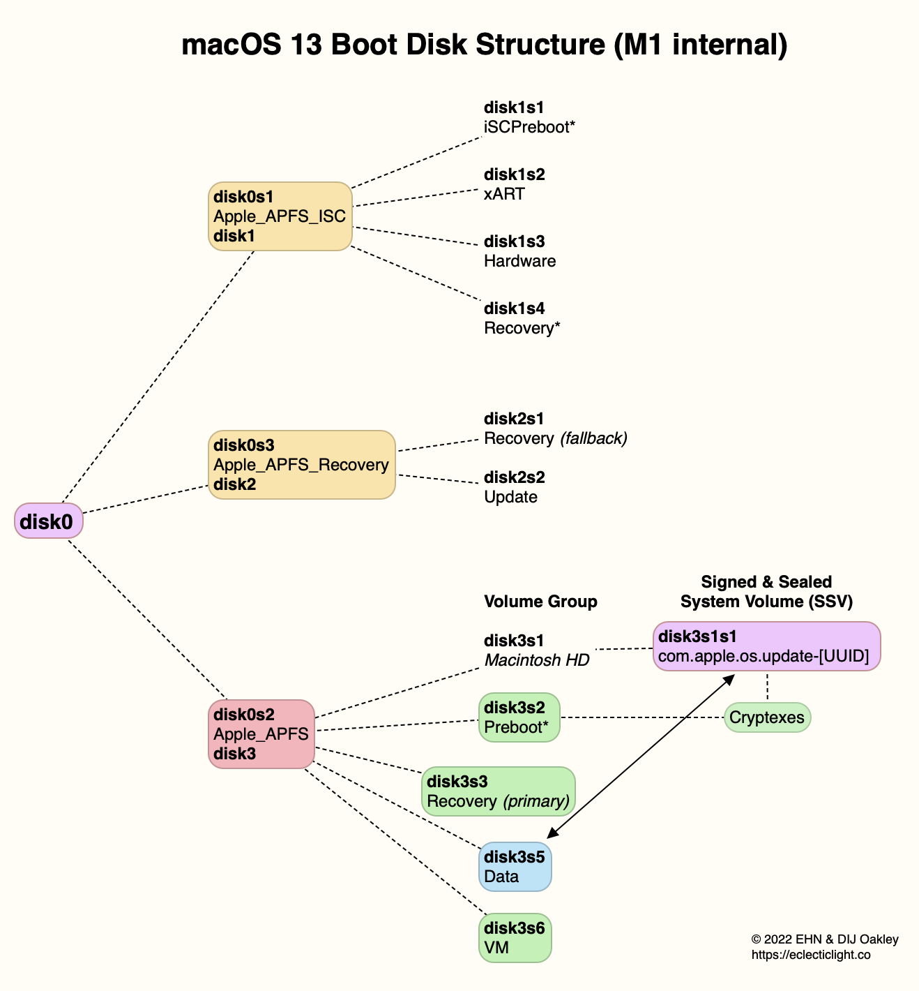

I think? what is happening is that the SSV is somehow compromised and persisting through Configurator restores. I keep finding language input files in /var/root/Library/Daemon Container. Normally this wouldn't be all that odd but they're the only input language files that are in there. I also see them running here:

    disk0s1 [APFS Container] 524 MB
      disk1 [APFS Virtual drive] 524 MB (Shared by 4 volumes)
        disk1s1 - iSCPreboot (APFS) [APFS Preboot] (6 MB used)
        disk1s2 - xART (APFS) (6 MB used)
        disk1s3 - Hardware (APFS) (3 MB used)
        disk1s4 - Recovery (APFS) [Recovery] (20 KB used)
    disk0s2 [APFS Container] 994.66 GB
      disk3 [APFS Virtual drive] 994.66 GB (Shared by 6 volumes)
        disk3s1 (APFS) [Core Storage Container] (11.20 GB used)
          disk3s1s1 - Macintosh HD (APFS) (11.20 GB used)
        disk3s2 - Preboot (APFS) [APFS Preboot] (5.95 GB used)
        disk3s3 - Recovery (APFS) [Recovery] (1.04 GB used)
        disk3s4 - Update (APFS) (90 KB used)
        disk3s5 - Data (APFS) [APFS Virtual drive] (35.06 GB used)
        disk3s6 - VM (APFS) [APFS VM] (20 KB used)
    disk0s3 [APFS Container] 5.37 GB
      disk2 [APFS Virtual drive] 5.37 GB (Shared by 2 volumes)
        disk2s1 - Recovery (APFS) [Recovery] (1.04 GB used)
        disk2s2 - Update (APFS) (25 KB used)
  disk5 - Apple Disk Image 274 MB (Disk Image)
  External Virtual Interface
    disk5s1 [Partition Map] 31 KB
    disk5s2 - S*********s (Mac OS Extended) 274 MB

When I checked the quantize sqlite file using sqlite3, it said it wasn't a valid database file, almost like it had been encrypted. Then when I checked it a few minutes later, it was 0kb and completely empty. I also
codesign -dvv /Applications/Malwarebytes.app
which showed it signed by Malwarebytes corporation but when I ran:
spctl --assess --verbose /Applications/Malwarebytes.app
It showed it as untrusted or revoked or something by Developer ID. When I looked through the logs, kernel showed it sandboxed, which didn't seem right for something like Malwarebytes. I removed it and tried to download it again but it looked like I was being redirected to a fake site. Not sure if it was legitimate, I decided to proxy off of my phone to ensure no dns issues but found it resolving to an ipv4 address where as my work laptop would resolve ipv6. Now that could be just be happenstance but I didn't want to take any chances as I already found them (and took a picture of) them trying to phish me using dns hijacking and a fake 'protonvpn.com' website. Proton accounts are all tied together so giving away that would've given away my email and password manager as well.
I'm positive I'm hacked, and I've submitted a security report to apple due to the persistent nature of it between DFU + Configurator restores but on the Consumer level, Apple can't help me because this is technically impossible and you can't file warranty for software issues. So I'm kind of stuck in a catch 22.
Any advice would be greatly appreciated. At point I'm suspicious that it may be in the recovery volume and and that DFU+Config wipes aren't fully wiping it. Thus the reason for the Security report. But If anyone knows how I can wipe this volume, please let me know. I've tried crtutils authenticated-root disable but it's tied to the kernel at process 0 so it makes it tough to remove.
Reason I was suspicious of the Malwarebytes redirection:

** Eclectic Light does a good job of explaining how to see all these settings and what commands to use.
If you're curious about a method or idea like this being used already
To add an extra layer of complexity, there are 2 recoveryOS instances within Apple Silicon. (technically 3 if you include internet recovery - but loads in the RAM, so it's still subject to predefined policies) During the point of recovery - or restore within configurator - it will still rely on some of these files and settings to dictate what it actually wipes or initializes. You can see some of this if you watch the install log during the installation/ recovery of macOS or review the log once you're booted into the OS. So ..... how would you know you achieved an absolute 100% clean boot? Scary to think ..... but what do I know - I just registered with Mac Rumors just to reply to this with some links.
