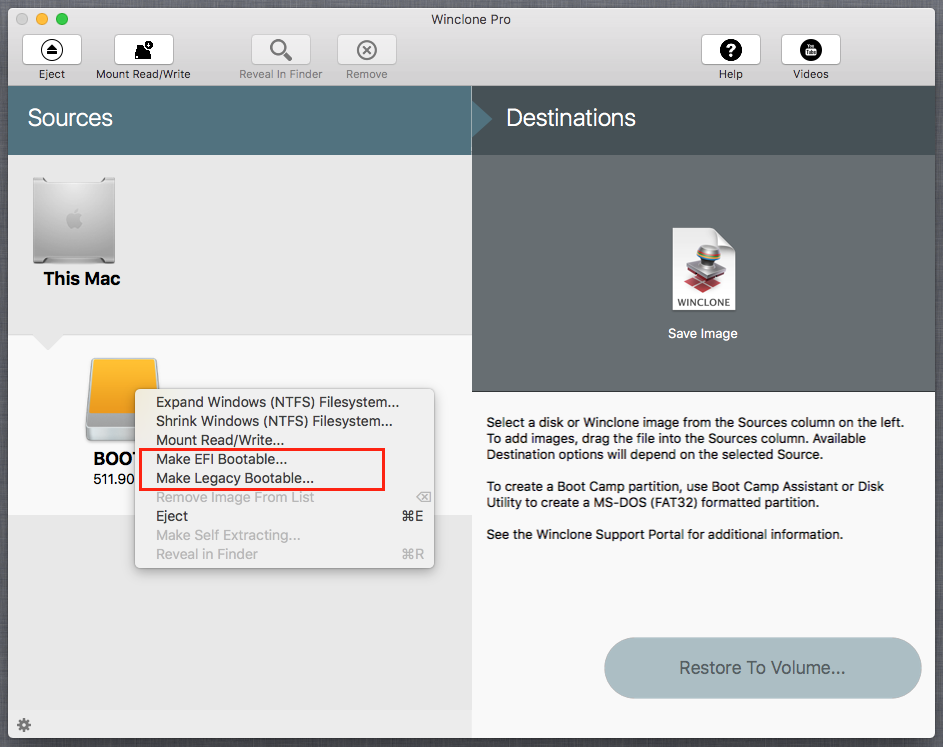

How do you figure out if you already have an install in UEFI mode? Was a while ago now but I'm sure I installed on an old Windows box, updated it fully and installed the bootcamp drivers and then just moved that to my Mac. If I can get better performance I might reinstall.
You don't need to reinstall. You can use Winclone to toggle between EFI boot and Legacy boot of your existing windows volume. Plus it really works great for creating backup images of your Windows drives.
