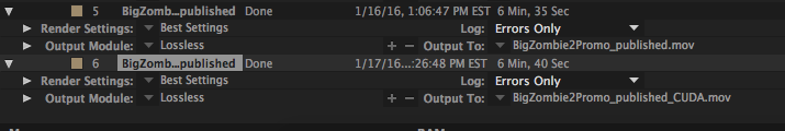

Couple interesting tidbits. First, before doing the swap, I did a new export of this project from AE 2014 with my old ATI Radeon HD 5770 just to get a non-scientific benchmark for speed. Then, after getting up and running with the
NVIDIA GeForce GTX 980 Ti, I rendered the same exact project again. (I've yet to get any additional ram or make any moves on upgrading the processors.)
This was the result (#5, the old ATI, #6, the new GTX):
So, not going to lie. This one stung a lil' bit.

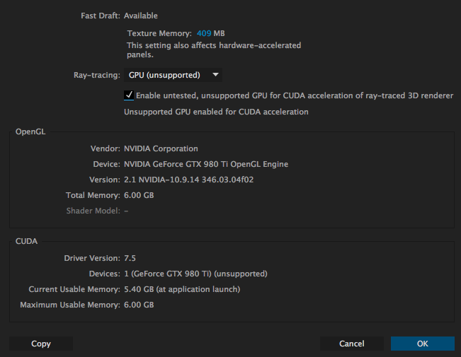

And yeah, I adjusted the GPU settings before going for that other render. So, just for FYI:
At first I was like, "oh no! It's an unsupported GPU!" But, after a lil' research, I think it's saying that because RayTraced is no longer supported and this GPU is on the newer side.
So, here, thus far...no substantial change. Now, I should point out, this is ONLY rendering...I've yet to attempt any actual "work" inside of AE or Premiere Pro.
