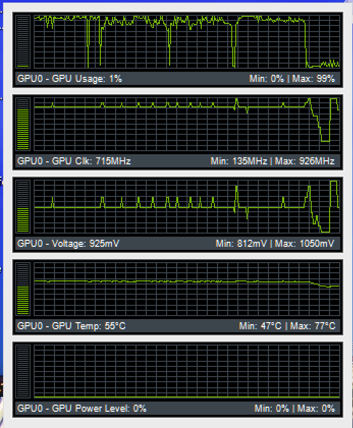

checked it. throttles CPU when GPU is under load (used furmark). or after a minute of only-CPU stress test.
edit: Also, it throttles the GPU too when tested with furmark. (checked the voltage indicator. It drops after a while)

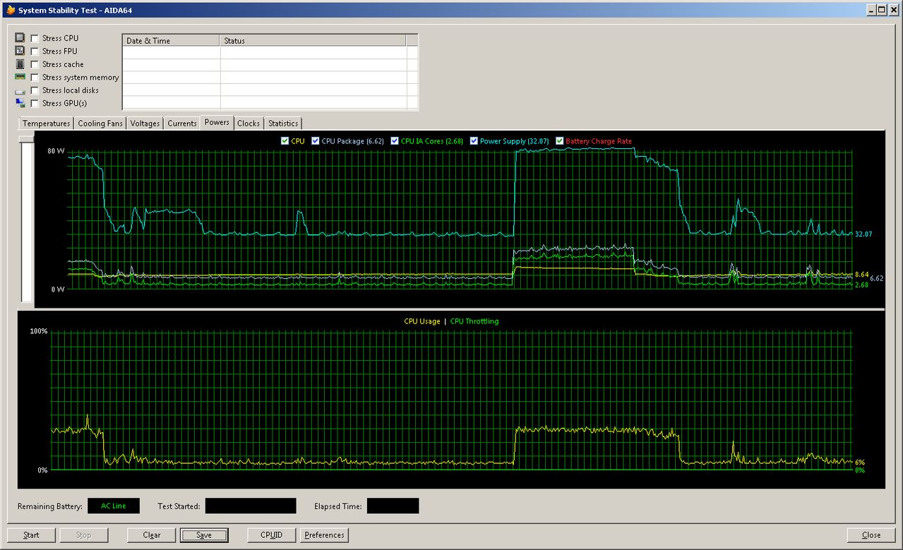

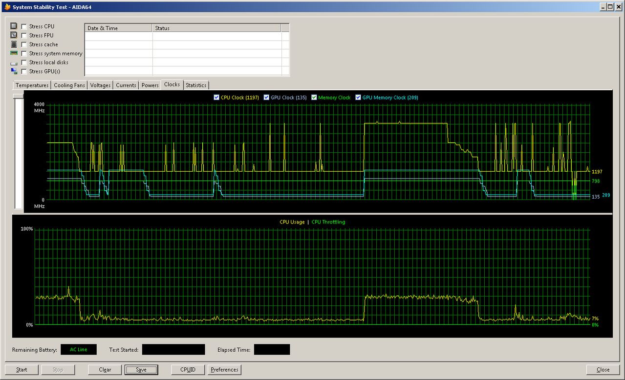

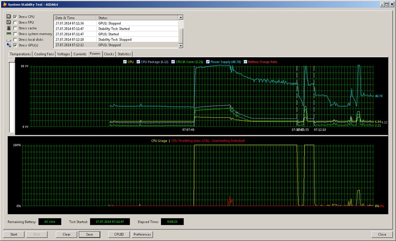

I don't see a full load scenario? you're getting 100c without even under full load???
You need to run LinX + something that will peg the GPu 100% then report temps/CPU and GPU clocks via Intel Extreme Tuning utility and GPUz.
Or just run the stability test..
EDIT: This is what I want to see. These graphs, while running the test, will clearly show thermal/power throttling.
Power from the wall (not charging) = 132watts

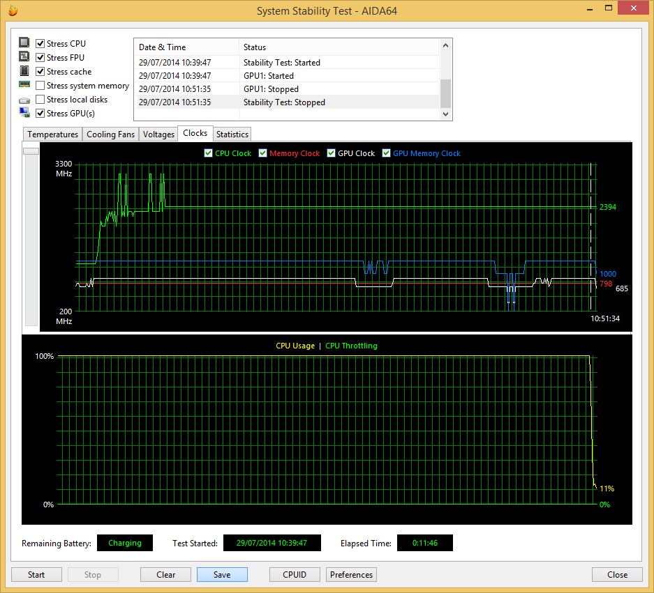

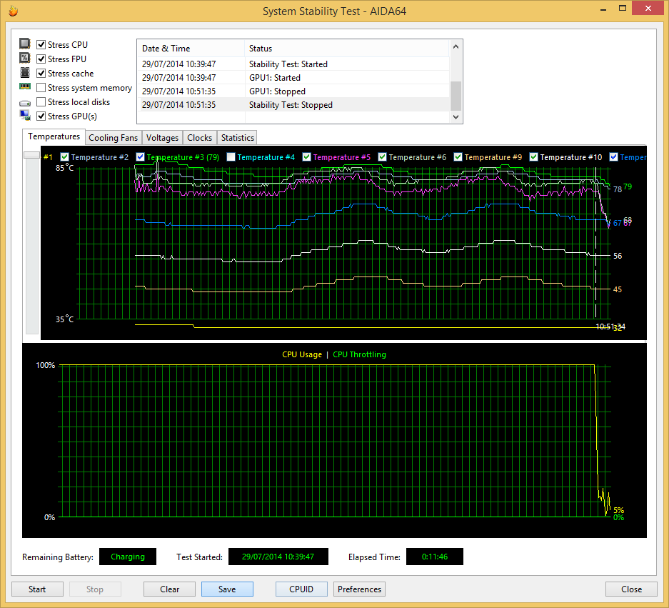

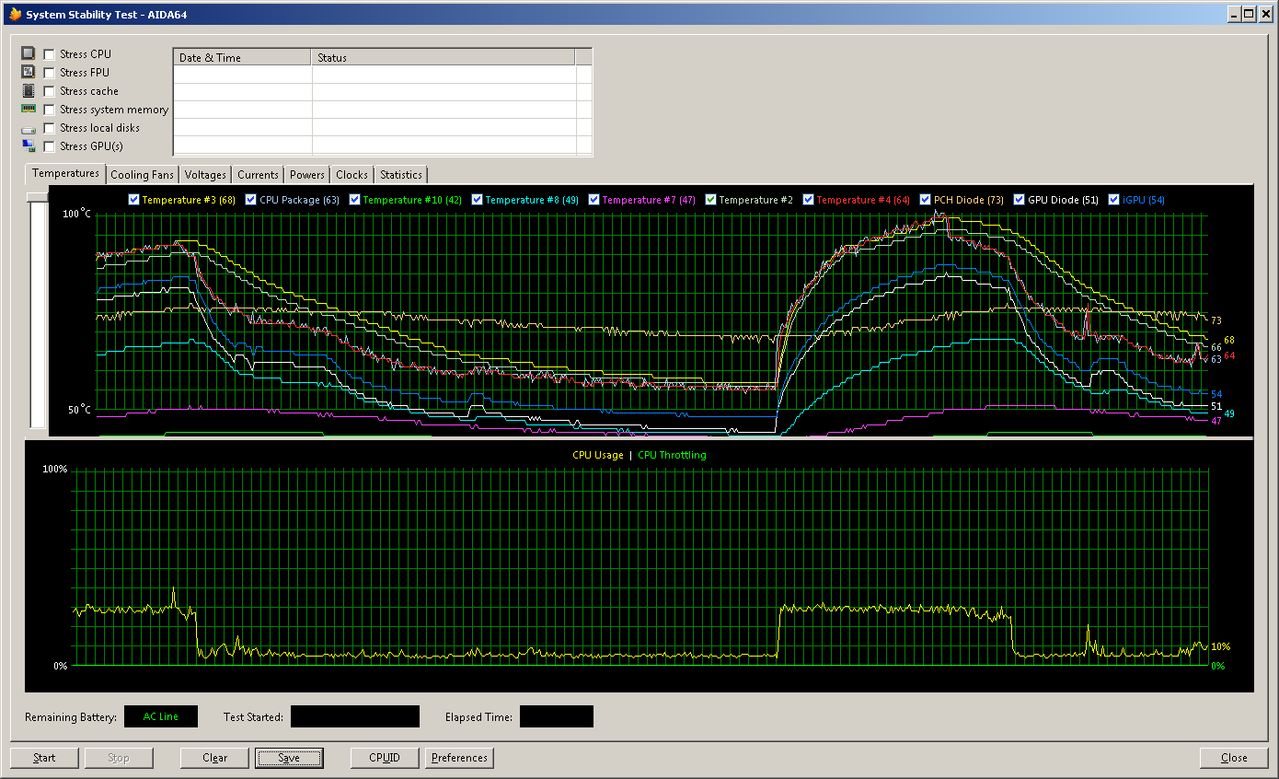

ok I did as you said and noticed two things
AIDA64 gave a throttling warning when the CPU hit around 104 C's. but that was not the thing that was bugging me. It's pretty much acceptable to have some kind of throttling at 100's.
What was bugging me was that when the purple line called "Temperature #7", hit 50-51C's, the clock rate of CPU dropped significantly --regardless of the CPU heat or load-- and never backed up (since that purple line takes a long time to go down). That's why I gave it two kicks of stress tests. One long, one short. Here's the power/temp graphs:
EDIT (forgot to take a snapshot of clock graphs, sorry. Just made a test again, yielded the same results and now Im posting the clock graphs🙂

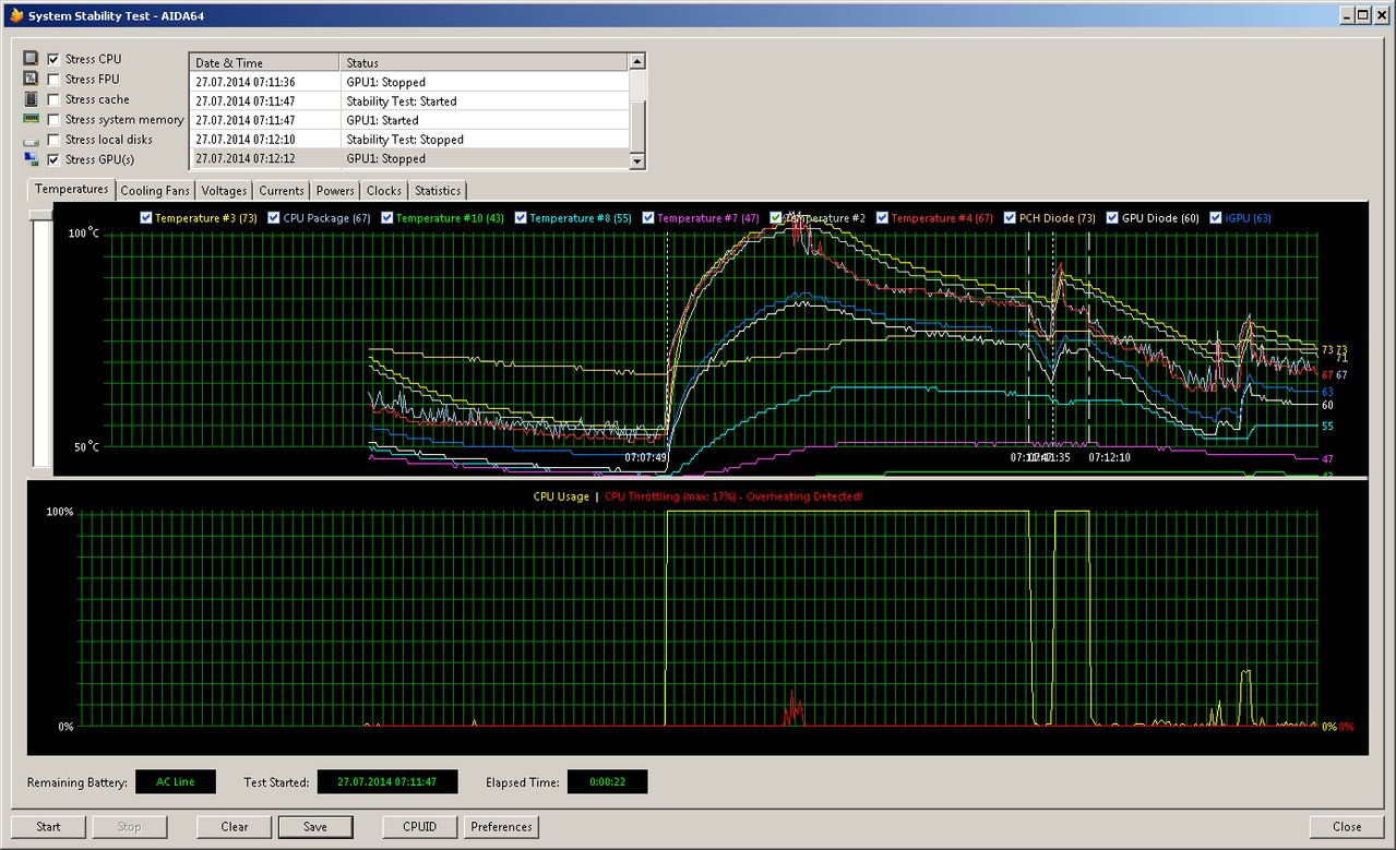

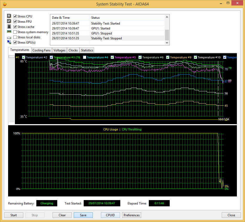

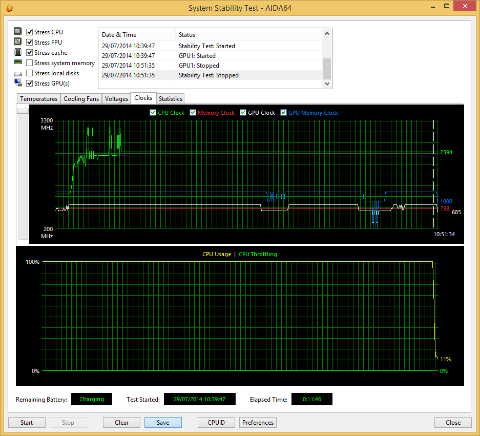

i was able to get throttling before temp 7 or 8 hits 50C. but temp 10 hiting 60C was at the same time of throttling. this was achieved by turning off and on the extra fans.
see for yourself(temp 7 and 8 not in the graph):
and i was able to delay thottling until it hit 54C. so it's not that sensor's problem. Our labels for the Temp#'s are different, so i cannot compare these results (my temp #10 never exceeds 44C even under CPU&GPU stress test)
there are still a few temperature lines moving inversely proportional to the CPU/GPU temps. I'll chill the macbook next week and try it again then.
EDIT: and nightgost, could you please provide me with your PCH Diode temps under stress test and where it throttles - if that diode is available on your graphs? Because that diode still keeps heating up even when the CPU&GPU throttled itself down and cooled themselves.
