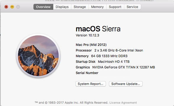

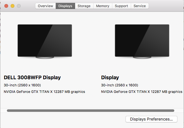

The Issue:
The display ports are failing "handshake" at boot. They remain blank.
If you pull them out of the card and replace when the Mac has booted, then that's okay.
Try to boot normally, the DP (scene blank) not seen.
D-DVI port or HDMI = OK
Anyone got any ideas?
