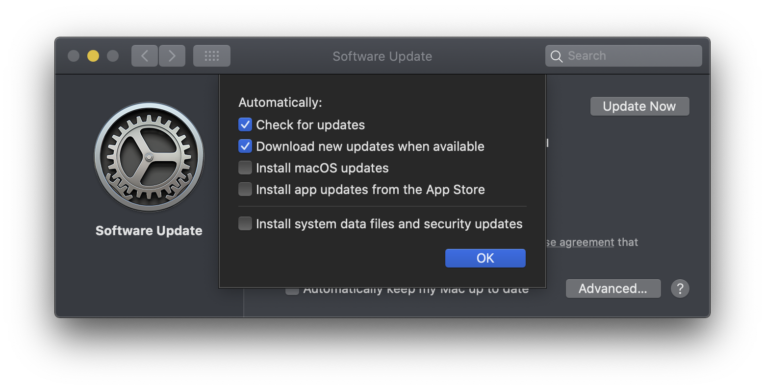

anybody know how to turn off updates?
You can turn off automatic updates from System Prefernces > Software Update > Advanced and ensure that "Install macOS Updates" is not checked. If you're really paranoid you can also uncheck "Install system data files and security updates."
it's all unchecked. Apple still bugs me about updates, and sometimes forces them them to install, causing me to lose all my work.

Is it possible that your Mac has mobile device management (MDM) software controlled by your employer or other organization? If the machine is owned or controlled by a company/organization using MDM, it's possible you may not be able to disable updates.
Or it could be a macOS bug if MDM isn't being used and all the settings are disabled and updates are still installed automatically. I'm running Catalina 10.15.7 and based on the screenshot in my previous post, I have automatic updates configured so that I receive notifications when updates are available, but updates are not automatically installed. Not that I don't want to install updates, but I want to control when they're installed to avoid the problem you're describing.
There's also a checkbox on the main Software Update screen before clicking Advanced ("automatically keep my Mac up to date") that needs to be unchecked. Make sure that is also unchecked.
No MDM.
Like I said, all options are unchecked, including the most obvious one.
I have a suspicion about the updates. When you are inevitably reminded (even though you have disabled update checks), it gives you three choices: "Try in an hour", "Try tonight" and "Remind me tomorrow". Maybe as long as you choose "Remind me", then it will keep reminding you. But if you choose "Try", then maybe it simply goes ahead and installs the update automatically. Either that, or maybe you can only dismiss the reminder a limited number of times, or for a limited time, and after that the update is forced.
