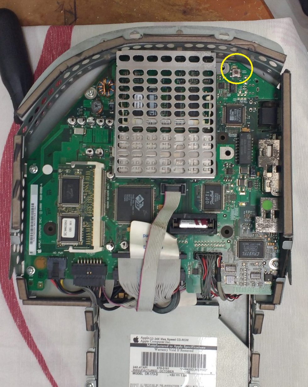

There's that magic CUDA button on the early iMacG3, that might help ...?
@TheShortTimer did mention it in his latest thread about resurrecting an early Blueberry iMacG3.
And there has been discussion / recommendations about it in this thread some time ago ...
There is a small button on the board, in the repair manual it says that you must tighten it when changing the battery, I tried, and I was not lucky

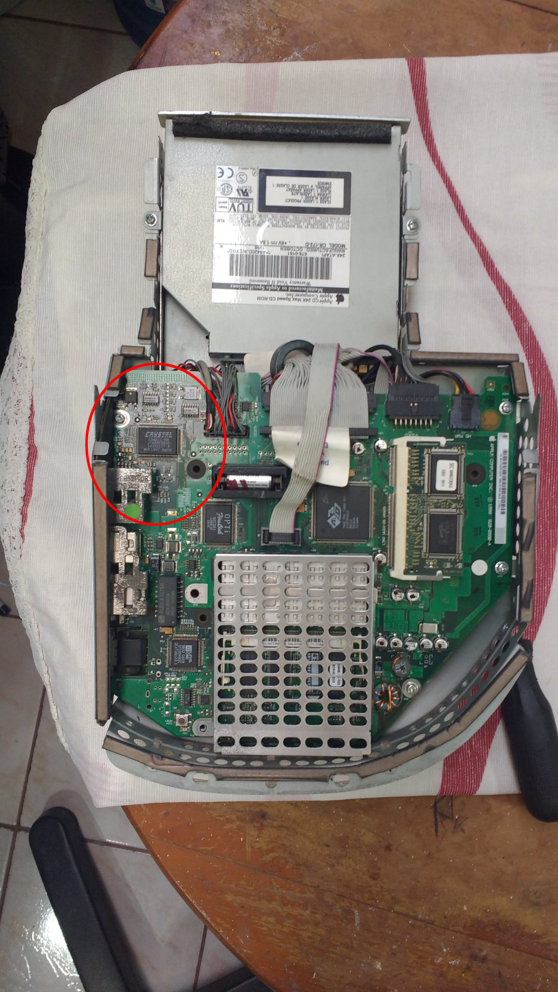

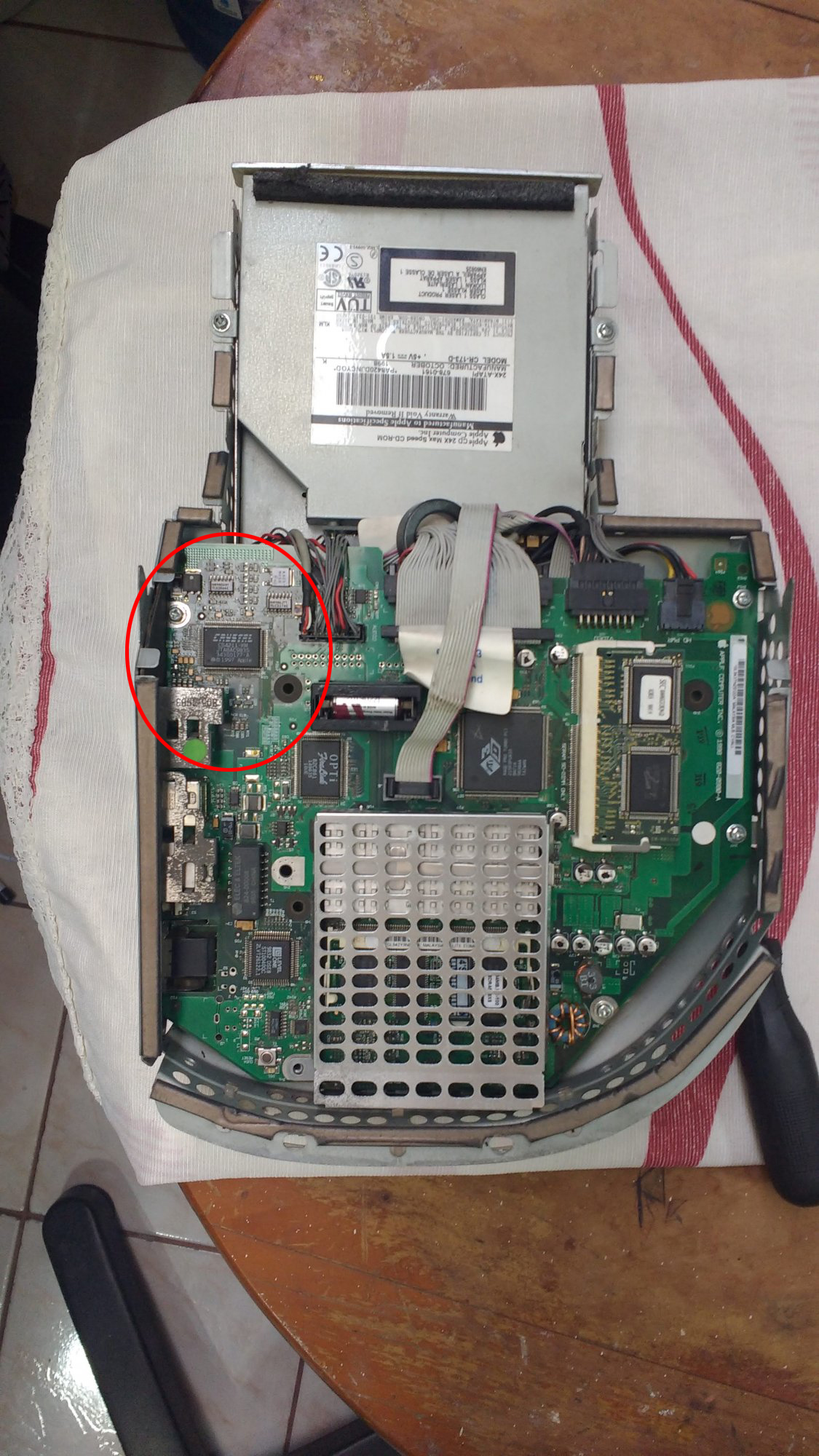

Just to be clear, when you say "card" you mean motherboard, correct? Clarification on any non-specific terms would make understanding your problem easier to everyone. Also, is there corrosion on the motherboard? I circled the area in the attached image on where there looks to be some issue, could you provide a better view of the area?
Yep, motherbaord.

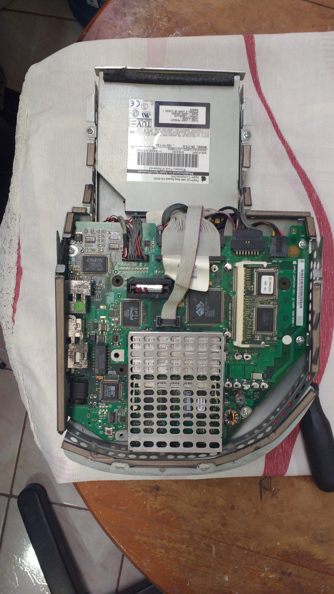

I took some pictures of different points on the motherboard. I found no signs of corrosion or leakage
