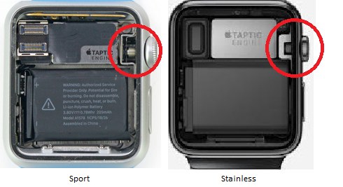

Judging from a teardown versus Apple advertisements, the Sport model apparently has a much less robust crown bracket than the SS model.
On the Sport, it's a thin bent piece of metal, versus the thicker SS version:
Perhaps the bracket is bent slightly wrong on some Sports, or as you suggested, some foreign matter fell into it.

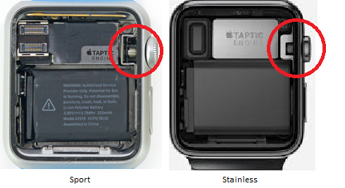

You can't compare a real life photo from the teardown to a render from Apples site. Inaccurate.
You have a point that Apple's render on the right is known to be a bit inaccurate (or at least, really smoothed out to make it look better).
However, it appears that the people having trouble are using Sports, for which the teardown photo on the left is valid.
Oh wow, night and day. Glad I went SS.

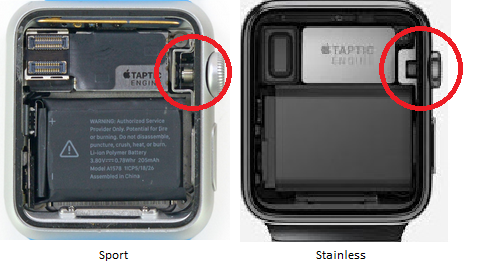

You do realize that the innards of the Sport, Watch, and Edition are EXACTLY the same, right? The marketing photo you posted comparing it to the tear down photo is inaccurate and misleading. The inside of the stainless steel watch looks exactly like the sport. Don't spread misinformation please.
