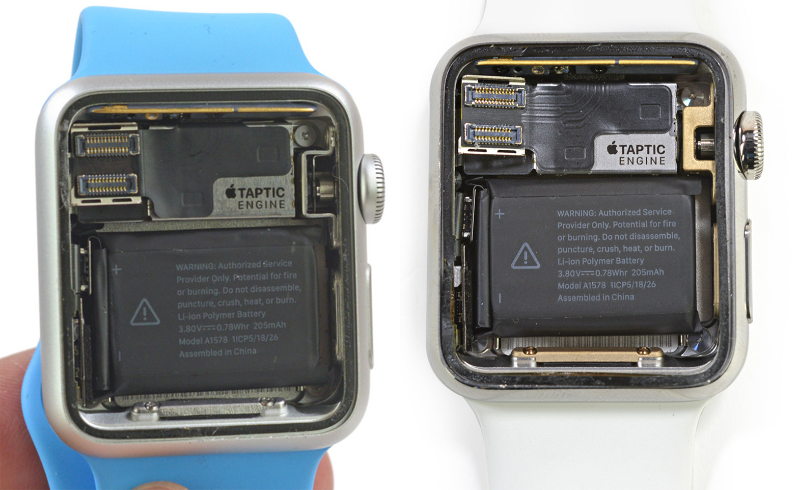

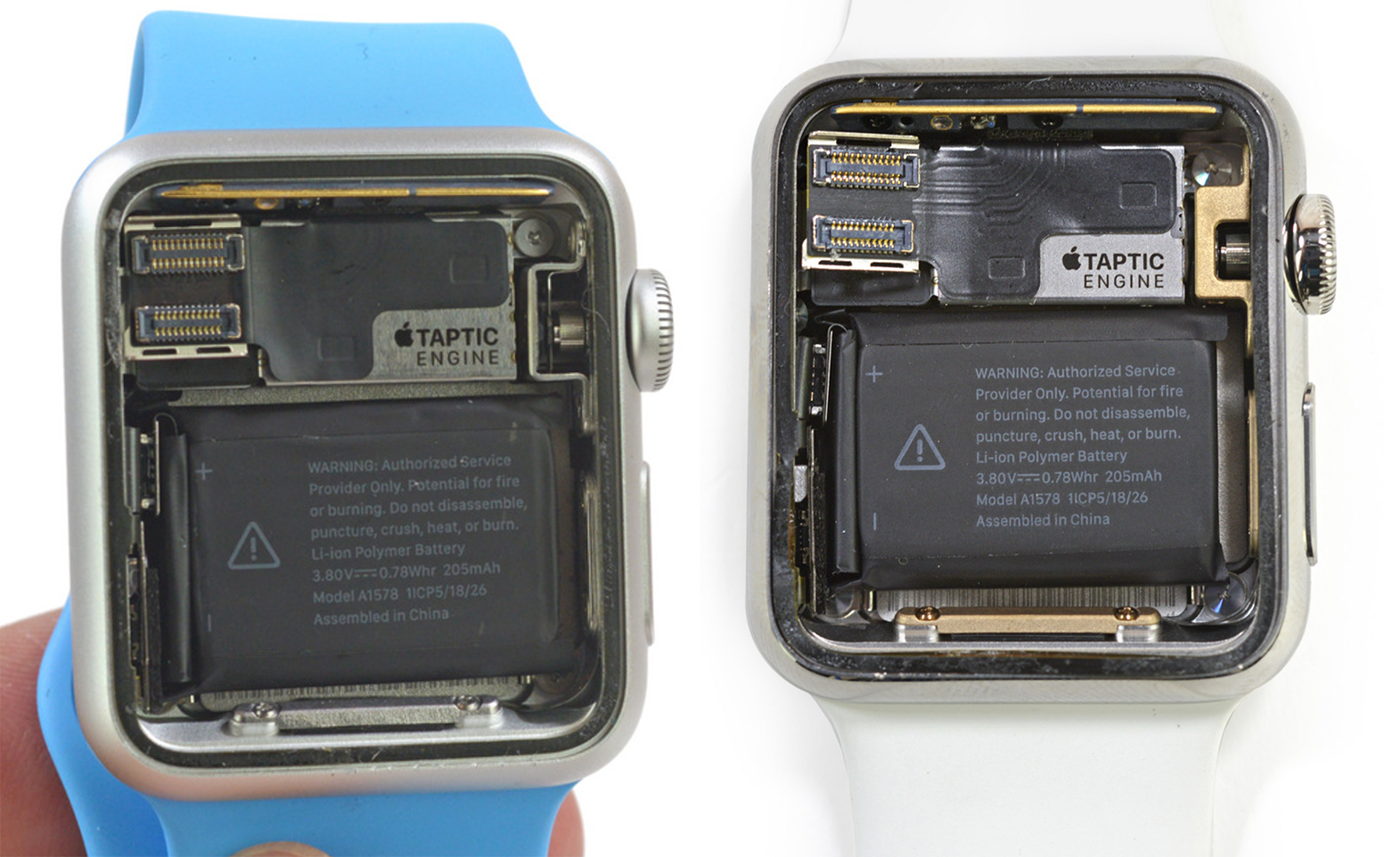

You do realize that the innards of the Sport, Watch, and Edition are EXACTLY the same, right? The marketing photo you posted comparing it to the tear down photo is inaccurate and misleading. The inside of the stainless steel watch looks exactly like the sport. Don't spread misinformation please.

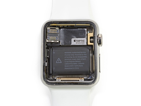

Ifixit opened up the SS and noted the digital crown bracket being substantially thicker.
EH? You are completely wrong.
How am I completely wrong? The crown stem is not thicker in the stainless steel. The only difference is the metal piece surrounding the crown stem. I'm not talking about differences in the cases. Those are very obviously different. I'm talking about the actual hardware inside the device, like the crown.
You said "You do realize that the innards of the Sport, Watch, and Edition are EXACTLY the same, right?"
And I said you were completely wrong, as you were, I had to post the 2 images in defence of Kdarling who you were tearing into. But thanks for clarifying what you 'actually' meant to say
Are you saying those two photos look identical?

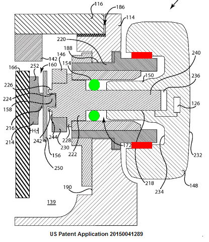

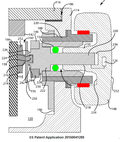

However, the patent application for the digital crown shows a coupling (which I marked below in red) and a rubber O-ring seal (green).
If the actual assembly has those, then it explains why it's okay to use water to try to clean that tight crevice behind it. (And we can also see why it's so easy for any foreign matter to cause trouble.)
