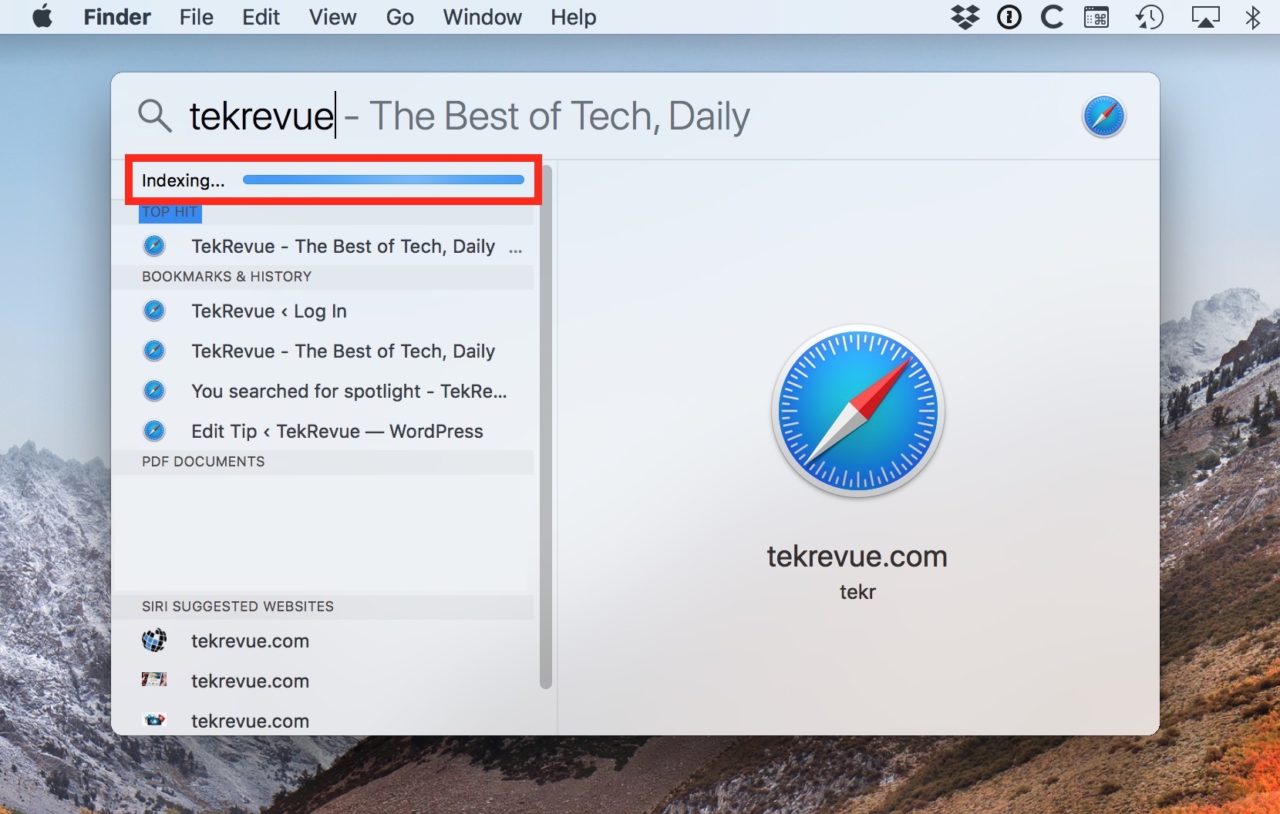

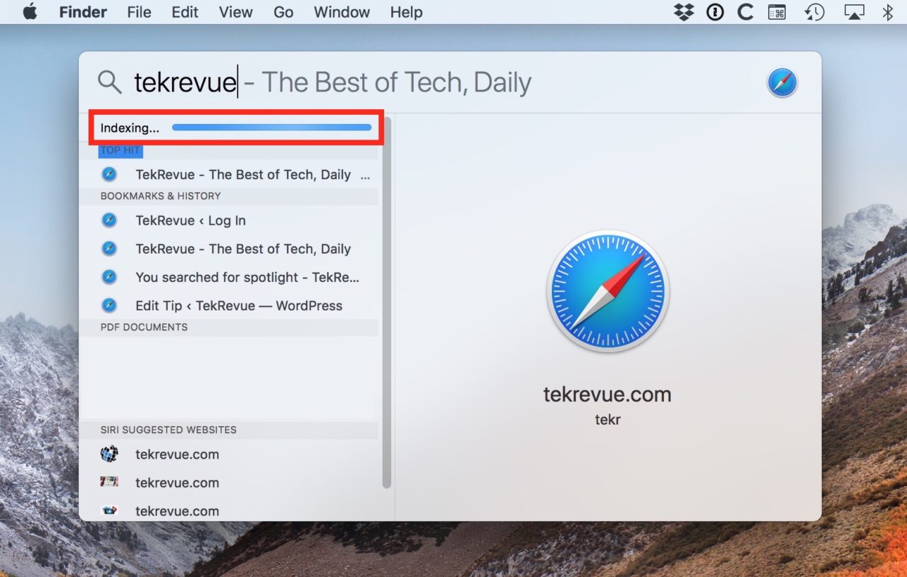

That means it is reindexing. Give it time to finish.
If you bring up Spotlight you can see a blue progress bar showing Indexing... like in this screenshot.

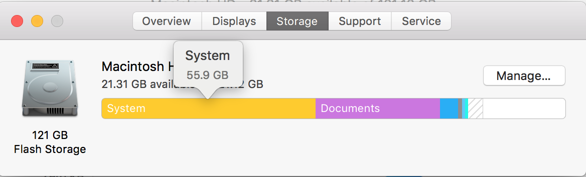

Hello Everyone,
you can say that i'm having a problem right now with the system storage, i read before that it's normal for the system to take up 50 Gigabytes of your storage but i was wondering if it's really true and maybe there's a chance that i can reduce it since i pretty much need more Storage.
Help would be appreciated.

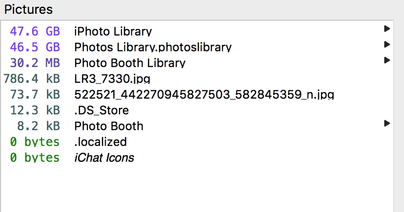

So I am having the same issue with my MacBook. But when I ran OmniGroup, this is what it shows for pictures. I find this strange because I have iCloud photo optimization enabled. Does this seem right? I don't get why there is so much room taken up by pics and why there are two almost matching Libraries. Can anyone advise?
It looks like what happened there is you had the older iPhoto app on there and a matching library file for it, then when the updated Photos app came along, it imported the iPhoto library and made its own Photos library, so now you have both. If you are sure all the iPhotos images got imported to Photos, you can delete the older iPhoto library.
That said, it won't save much space. Give this a read.
http://sixcolors.com/post/2015/02/the-hard-link-between-photos-and-iphoto/

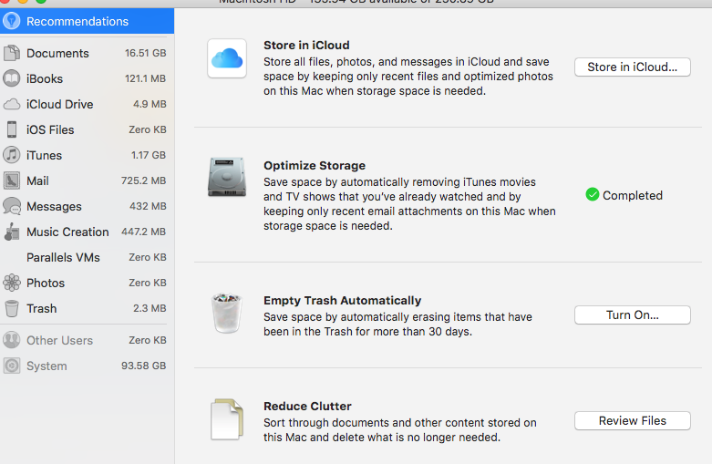

I am having a hell of a time with crazy system storage fluctuations. I never used Time Machine, used every software mentioned in this thread, re-indexed 3 times but still no love.
In fact, it was at 71 GB and suddenly jumped to 93 GB after a reindex.
Is there any way to directly access the system partition to clean it?
